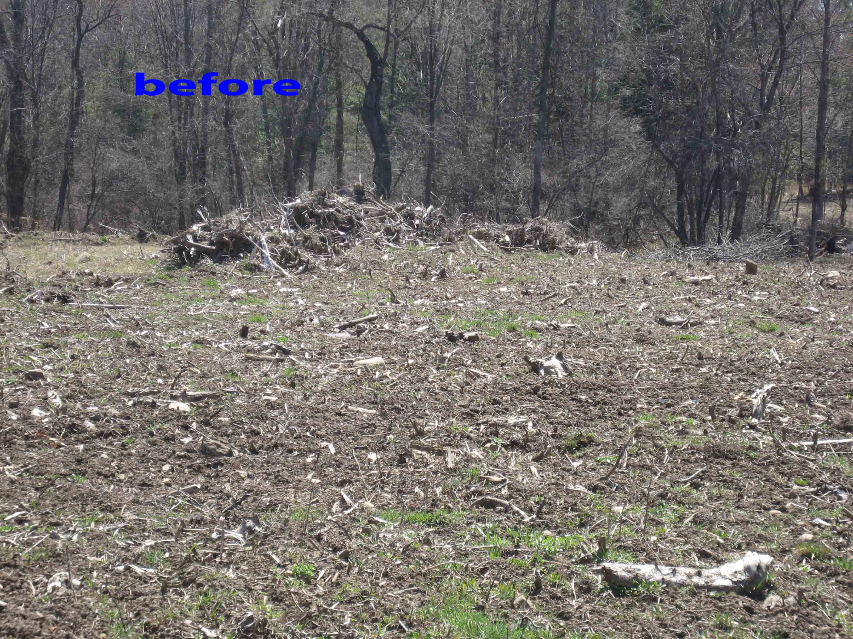

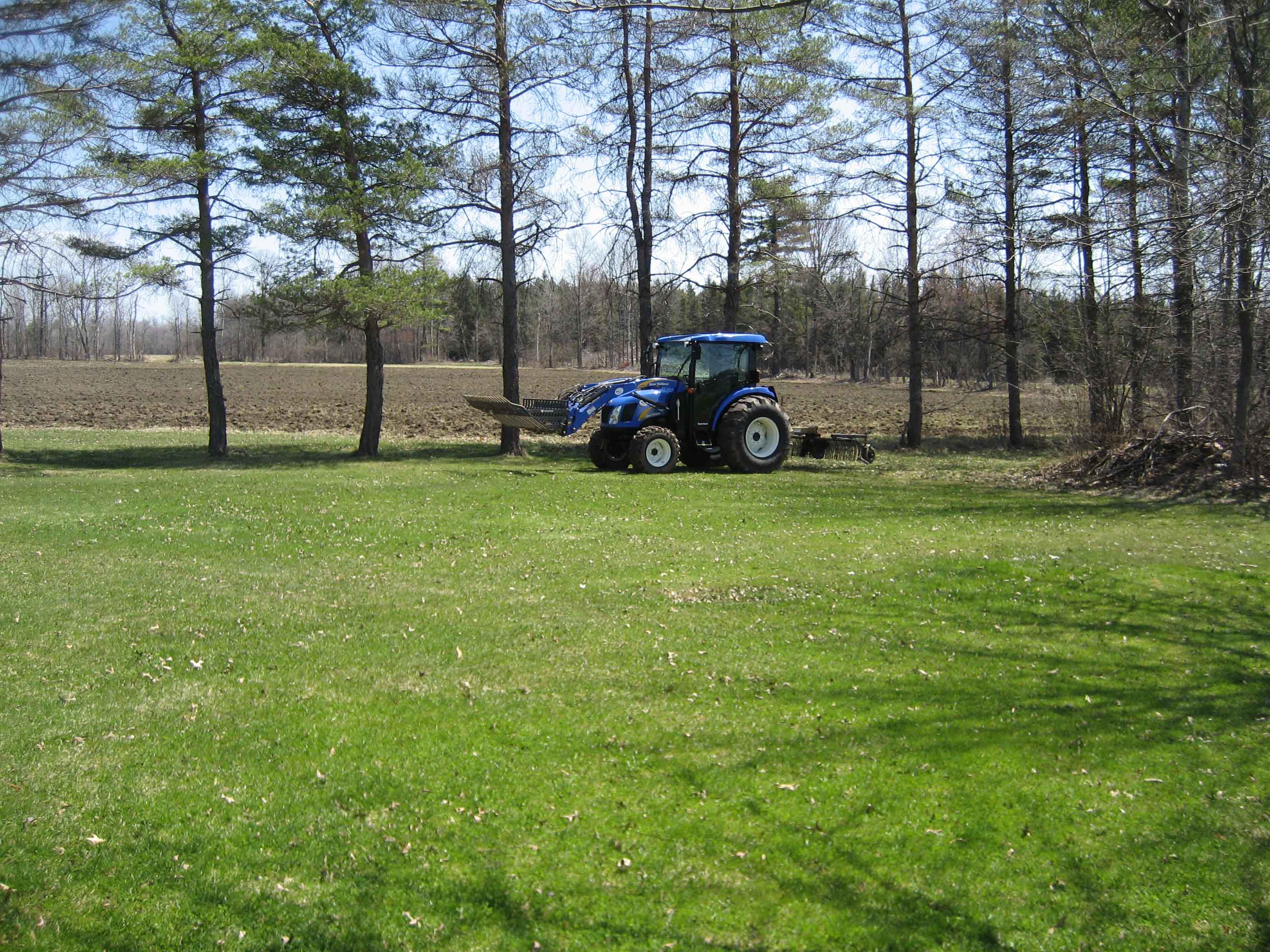

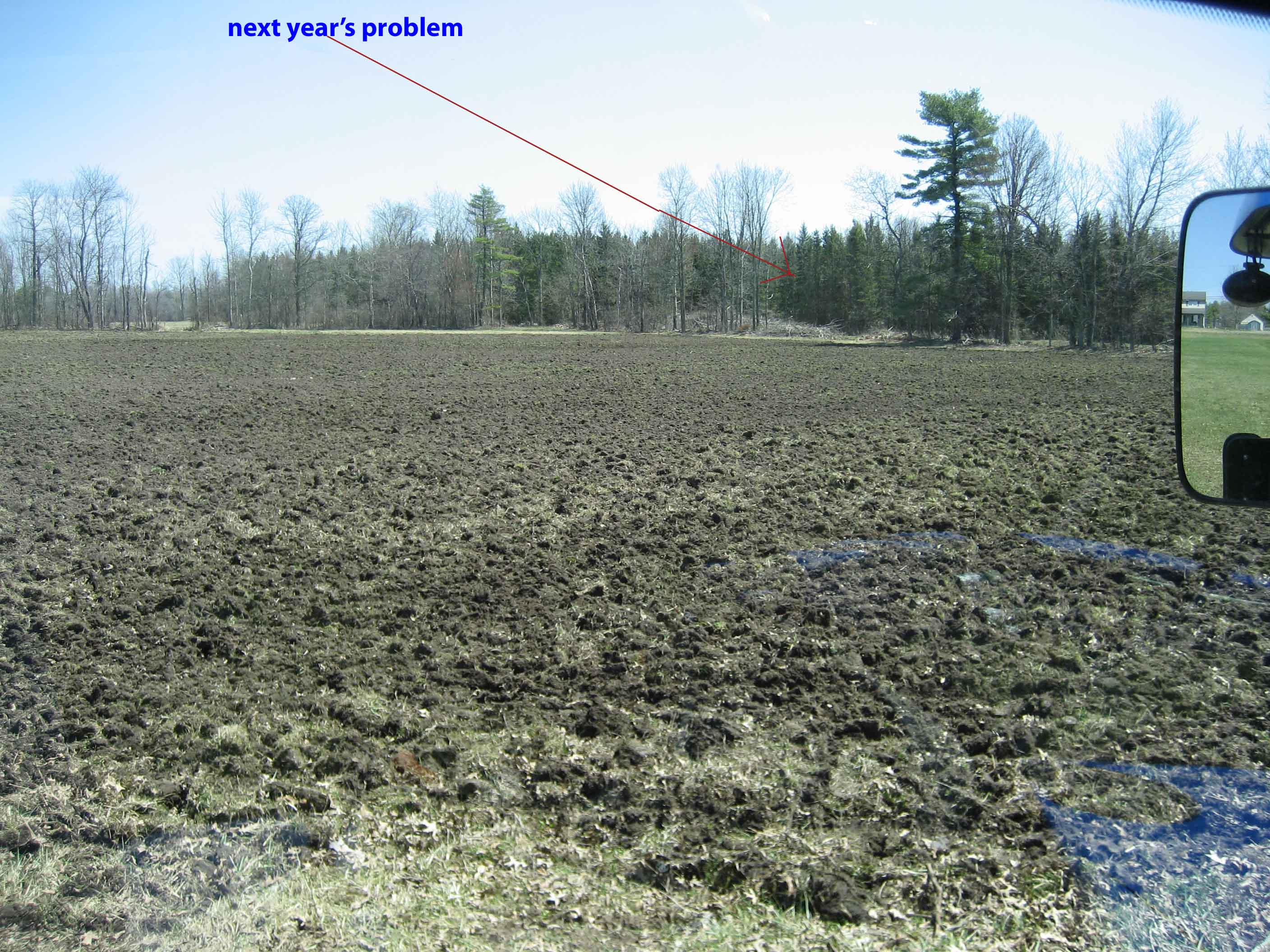

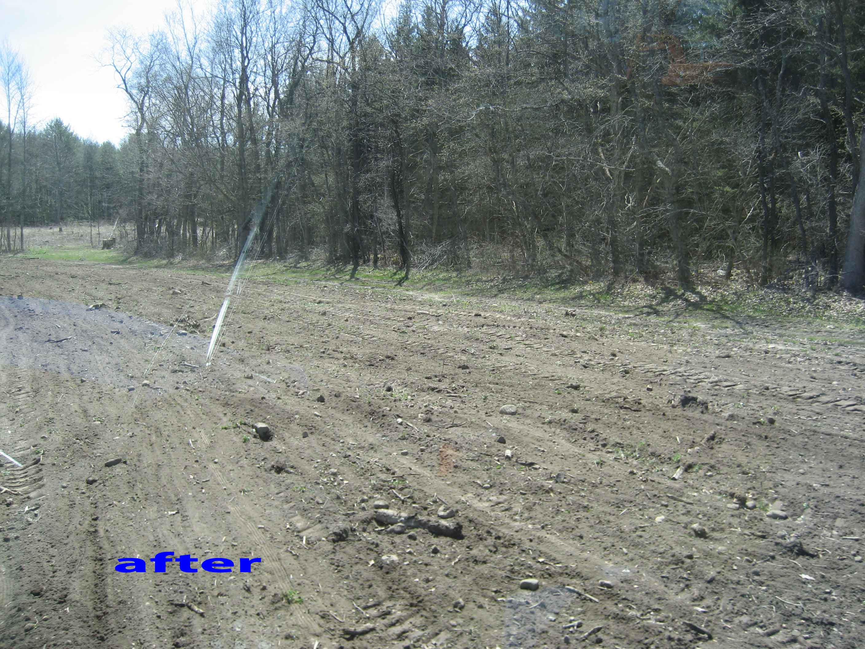

I guess it all comes down to what you're doing. As I stated in my earlier post my brother ripped the frontier grapple to the point welding the bottom with quarter-inch plate to keep it from spreading again as he used it as a rock bucket pushing through soil. I guess I'm looking from a different point of view when using multiple size tractors the 2420 being the smallest I can tell you after four years of hard land clearing close to 85 acres stumping tree roots which stop you dead when you hit them ;-) and the grapple is no worse for wear other than paint scrapes as good as the day I purchased it some photos of my work take care
