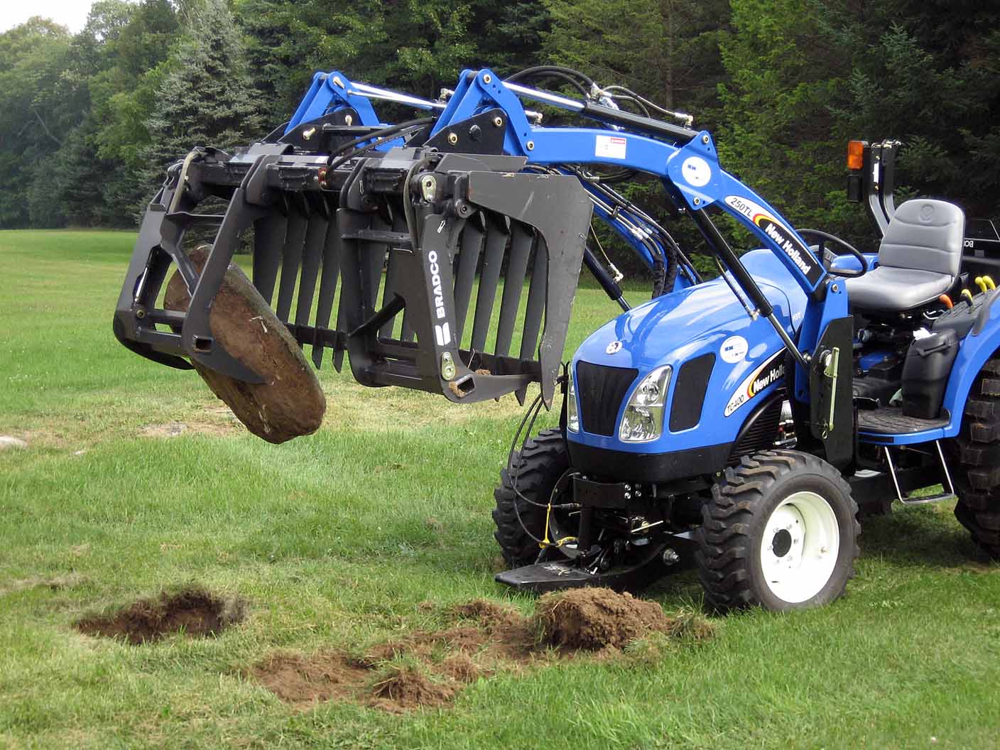

it's on page 3 of new videos entitled grapple.I also posted some extra pictures we all love pictures here's some front views
You know that's not how you're supposed to pick out a Christmas tree!?:laughing:
Who makes your grapple?

BRADCO name is right on side , small piles of pine tree branches showing the grapple in action. I had this on a TC 40 hp HST tractor worked fine just had to be careful not to try and lift to much in one shot. what is your max lift at full hight on your Kioti? one picture of TC40 with unit.

Would that be the Bradco written in white paint on the side of the grapple?:confused2:
What is the plate and other stuff between the front wheels low down?
What is the 'replacement' grapple going to give you that the Bradco one doesn't?

Nice demo photo RADIUM, what is that black protrusion with hydraulic hoses low to the ground between the front wheels? Something to do with a belly mower?

My guess is something to do with a snowblower or rotary broom. I don't know why there would be hydraulics with a front or mid mounted mower.

That's correct it was for the front mount snowblower I didn't remove it that year try to leave it on was a big mistake got hung up a few, But as you can see in the picture the TC 40 had no trouble handling that grapple. the issue is it doesn't open wide enough and with just two claws in the front a lot of material slips through and you need to continuously make piles were a silage grapple has the entire front points that meet. I will post a picture of the unit I'm looking at to give you an idea of the difference. Either way you need a grapple if you have any kind of land clearing or property maintenance to be done, it's probably on the tractor more than any implement I own there's always fall down in the hedgerow or rock piles that need to be moved I haven't used a hay wagon in years why bother loading on the wagon and then having to dump it by hand just grab it and drive to a hedgerow or burn pile and your done the lazy man's way that's me ;-) take care

Sounds like a clamshell rather than standard grapple is what you want. Clamshells, like the ones made by Anbo and WRLong, have a single full width upper jaw and a more vertically oriented bottom jaw. Clamshells are great for collecting and holding lots of small stuff but not so good for other tasks such as logs or firewood etc as the grapple can only hold something it compresses while the standard grapple can also use gravity to hold a load in place. A standard grapple will hold more logs/trees etc securely while the clamshell will hold more small stuff (silage too I gather).
