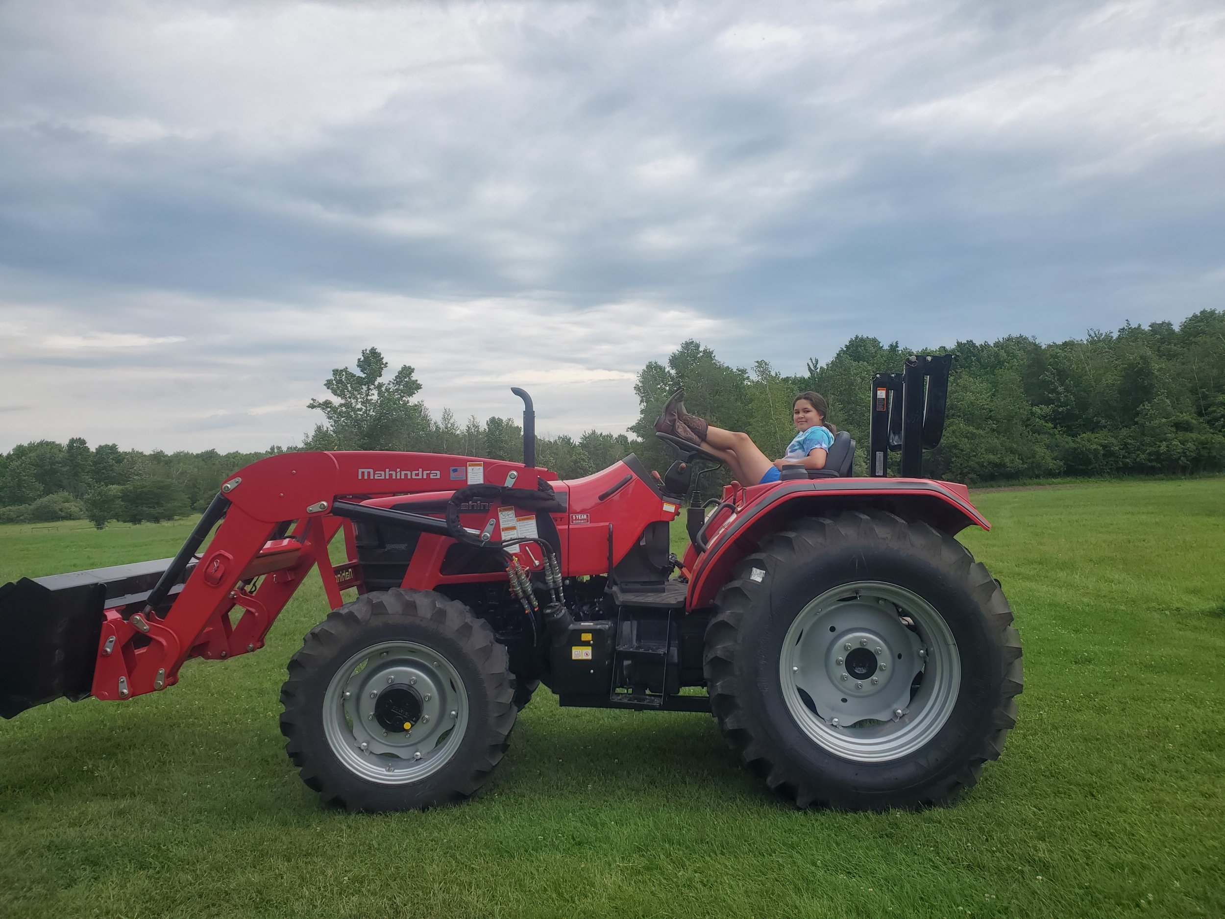

Just recieved my 6075 and looking for a grapple.
I ordered a 84" from Titan and when it arrived it had a leaking cylinder and was missing a cylinder pin. I called Titan and offered to keep it IF they overnighter the parts. They refused. So now I'm in the market for another.
Wondering what everyone suggests.
