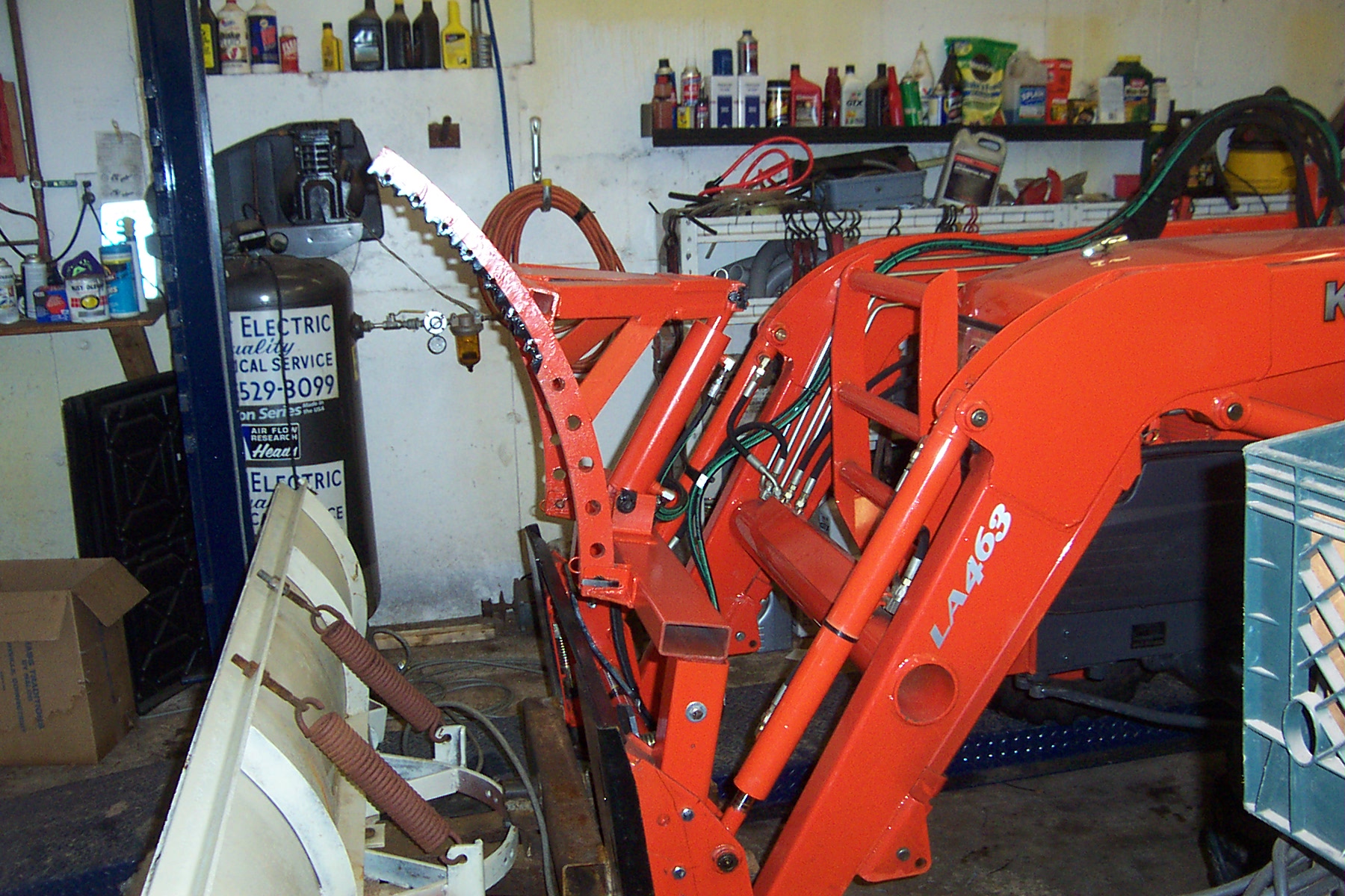

When it closes, It ends up ripping the grapple frame apart if I hold the valve too long. It's a 2 1/2" cylinder and I need a pressure relief valve.
Put I only want pressure relief on this cylinder only. How do I do it?

You can buy a small PRV, but you will also need to run another hose back to the sump for the return.
HERE is just one example on one.
/ Grapple cylinder is too strong #3
You could also insert a limiter 'tube' inside of the offending cylinder.
Example; if the stroke is 2" too long, add a 2" tube so that the piston bottoms out 2" short.
For a 2 1/2" cyl probably a suitable length of 1 1/2" water pipe would do the trick.
I have a piece of equipment that uses that method, probably because the mfg wanted to only keep 1 size of cylinder in stock.

If you put the relief valve in the extended line, that side will be protected, On the retract, not much pressure, it wouldn't matter unless he held the levers back to much, Maybe a double relief valve, to be safe.
Maybe rethink the grapple geometry, It doesn't look right to me. Maybe beef up the metal somewhat.

If you want to fix the problem, you should rebuild the mount. It looks like you have used metal that is way to thin for what it is being used for. If you use the relief valve, by the time that you get the pressure down low enough that you won't have any damage, the thing is not going to work how it should.

I believe he does not has the steel sized for the force of the cylinder, and apparently he has damaged it at one time. He is wanting to reduce the force, so it will not bend/break anything. Even if he puts a relief valve in there, that reduces the pressure form 3000 to 1500 psi, the force will only be halved. If that cyl was a 2 in cyl, the pressure at 3000 psi the force would be over 9,000 lbs, and at 1500 psi, below 5,000 lbs.

I'm with J_J on the geometry of the design. The way most grapples are designed they self limit the ultimate force applied, but with that tower up like it is the force at full extension of the cylinder is going to be huge and I would guess the limiter inside the cylinder is going to be the only way to stop the breakages. Even at that, if you grab a stump, large log, rock, or anything that the teeth are tight on a bit before the limiter it hit then the teeth are going to get broken again if you do not get off of the valve quickly enough.
Considering all of that may very well point you back to a pressure bypass as the best option because due to the design this inherent weakness is going to manifest throughout the range of travel of the jaws due to the leverage. If you were to beef the jaws up enough to take the pressure without breaking then next weakest part is going to give anyway.
If you want to see the kind of geometry that is typical/classic for grapples take a look at the thread by GuglioLS in the Build-it-Yourself forum titled FEL Grapple from Scratch W/Lots of Pictures. Here

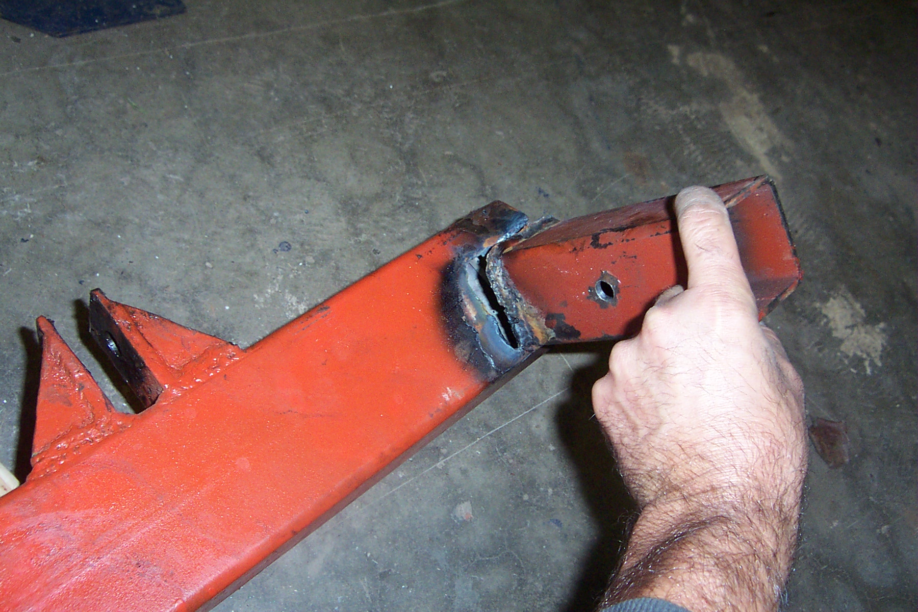

I was not talking about the cylinder anchor point on the rectangular piece of metal, but rather the triangular mount on the action end.
Triangle end has giving me no problems
My twisting action was here in the pic.

You can see that it broke at the edge of the weld, which is the weakest part. I would add a 45 degree wedge on at least two sides.
