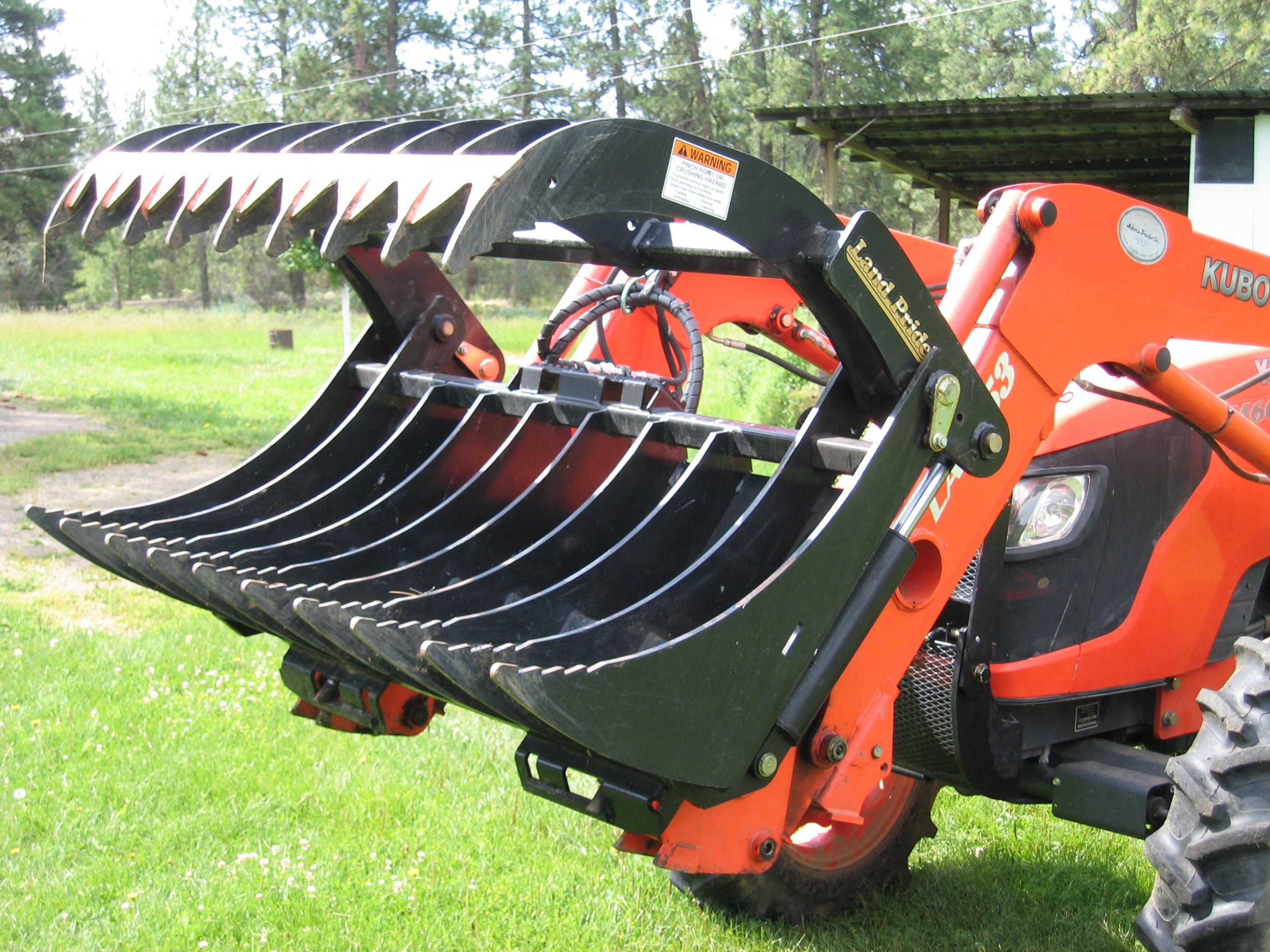

I'm just about to get started building a grapple after going back and forth over design and lead times. I have a friend that owes me a favor and is providing the cnc cut AR400 steel for free which will be all the tines. I'm going to fabricate the mounts, brackets and braces. The one issue I'm unsure of is the clearance for the hinge tubing and hinge rod. I'll be using DOM tubing and most likely a solid steel rod for the pin unless I should be using something else. I was thinking at least a 1" rod. What should I leave for clearance for grease, 1/16" or 1/8" or should it be tighter? I don't have a lathe so shaving it down will be difficult but I'm sure I can figure something out if I need to.

I have no idea what the clearance is on my keeper pins on the "lid" of my grapple. It must be pretty tight. With the hydraulics disconnected on their connection to the upper lid - I can lift/shake the upper lid and it just moves smoothly up/down. No apparent looseness or rattle.
I have a Land Pride - SGC1560 grapple. 60" wide, 820#. The pins that hold the hydraulics to the upper lid, pins that hold the hydraulics to the bottom of the grapple and the pins that hold the upper lid to the grapple - all are 1.25".

Okay. So it looks like I'm aiming for a tight fit or about 1/32" clearance. I'll have to look into increasing the pin size, although the thickness of steel around the mount would start to suffer.

You need a set of dial (or digital) calipers for measuring pin clearences. something that will measure in .001" of an inch. Not a tape measure reading fractions. 1/32 is WAY too sloppy for a pin in a greasable bore. .004-.005" is sufficient. Any sloppier and your hole will be oval in no time. Not due to wear, but hammering.
You mention ONE pin because its a single lid. Not sure your design....my single lid has TWO pins at each end.
IF you dont have a lathe....shoulder bolts are a pretty exact size and quite hard. ANd if you get the right length you can secure with a nut and not worry about squeezing too tight and binding....and no cotters to loose in the brush. You can also get nominal size bronze bushings for pretty cheap

You got it, larger ID tube sized for bushing. Here are a couple pics of the pins on my MTL grapple. Not sure if it has bushings. Pin is 1". If you plan on a single wide claw, you may want to consider 3 or 4 separate hinge pins, not just one on each end.
