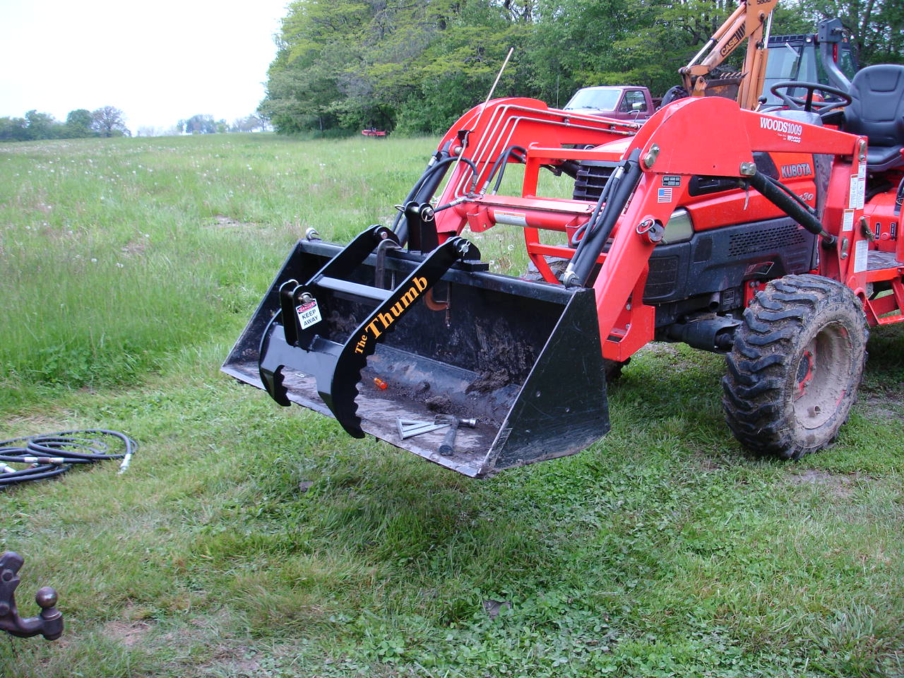

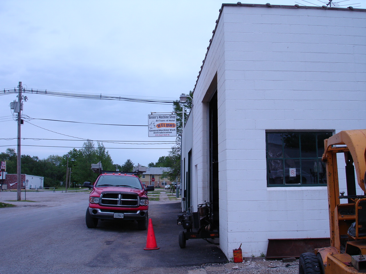

I looked a long time, this one was little more than some around 350.00. Also it was close to me and was fun talking to John, 3rd or fourth generation owner in same shop. Green welding does a nice job and much heavier than all I looked at. The grapple is like a hand, one of the tools you wonder how you did with out.
petegoud, yep some bucket work was called for on my FEL.
The Thumb

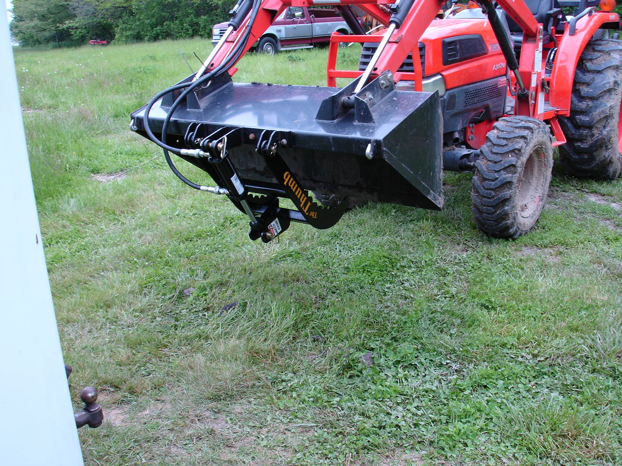

I just added one of andy tatro's grapples to My montana 3644 and used the the existing rear hydraulic connections with hydraulic hoses under the tractor to the front. Worked great and you don't have to fool with tapping the hydraulics as the extra remotes are already there. Also the lever to operate the grapple is built in to the tractor platform so it is very natural to use. I put one on about two weeks ago and the things just work great for moving downed trees. You don't have to cut much up as you can grab a whole tree and move it ( if its a relatively small tree <10" in diameter).
Just be aware that if you use the bolt on style, that the top of the bucket isn't heavy enough to take the grapple and you will need some reinforcement. I welded a 2.5X2.5x1/4 tube on the top of my entire bucket and mounted the grapple to it. Works great.

Thanks for the info. Can you tell me what the differences are between the grapple you chose and this one, The Thumb?
http://webhosting.web.com/imagelib/sitebuilder/misc/show_image.html?linkedwidth=actual&linkpath=http://www.greens-machine.com/sitebuildercontent/sitebuilderpictures/NEW28.jpg&target=tlx_new&title=Thumb%20grapple%2024"
They look almost identical and The Thumb is powder coated. Cost is within $20 with The Thumb the more expensive of the two. coincidently they are both made in Illinois.
Did you buy the stock 26.5" unit? My bucket measures 23", so I'm guessing that a welded 2.5" square tube would make the bar mate up pretty good to the bucket...
The Thumb comes in 24" and 28". I also have a rock bar on the bucket so that might make a difference. How wide is your unit, what thickness of steel are the arms and the gussets as well as the base? Is it a standard 2500 psi cylinder, 2" bore - 6" stroke? Is the hydraulic port the standard 3/8"? Sorry to bug you with the questions, but they aren't on the Andy site but are on the Thumb site. I called Andy's phone # but he isn't in to get this info.
What did hoses and fittings end up costing you?
Thanks!

God to meet you Jerry. I'd say the two are almost identical. I did get the standard 26.5" model from tatro. The tatro is $430 with shipping, but comes un painted. If I had it to do over again, I would spend some extra to get the Powder coated Model (i E the thumb) . The painting with preparation and multiple spray cans is well worth more than $20, and the powder coat is a much better coating. I actually didn't find the thumb until I had mine already ordered. I also have a teeth bar on my bucket and it matches pretty good end of grapple to end of tooth bar. If i had to choose, i would get the 28". The grapple arms are 3/8" steel. I think the width is 26". The cylinder is a 2X6, and the hoses i had made up are all 3/8" with quick connects at the rear, and at the edge of the loader. I had each of the hoses made in two pieces, so i could quick disconnect the grapple on the bucket and the cylinder and leave the hoses connected to the tractor underneath. Make sure and get 90 degree fittings for the cylider hoses. The total cost for all the hoses and quick connects were about $140. I had my local tractor dealer make them up for me. He has all the fittings and hose and had them pre-maid becuase he sells montana's and checked the length. Use plenty of Plastic Zip ties to connect the hose to your tractor and loader, it makes for a slick set up.
The grapple is absolutley wonderfull what you can do with it on your tractor. the only limitation usually is the lifting of your back tires. Mine are loaded and I always keep my 6 foor box blade on to have more ballast. it still get a little light, so you just have go alittle slower. I will get some pictures on hear later of my installation on my 3644.

Thanks for the info there Jack. I was going to go with the Thumb anyway after talking to both owners. Only difference I see is that the Andy is 26.5" long arms and unpainted where-as the Thumb has 24" and 28" arms and powder coated. Price; Andy is $430 shipped and he has to make them and drop ship the cylinder. Thumb, has them in stock and shipped is $429. Also, thanks for the suggestion to use the 28" arms. My bucket from cutting edge to the top of the opening is 23" but I have a rock tooth bar on there as well. Mounting on top of a 2 1/2" square tube adds 2 more inches to the 23 inch opening for 25 inches so that should be about perfect.
Looking forward to seeing your photos too BTW.
Oh, I have a backhoe on my tractor so that's about 1,000+ lbs of ballast of the back. I think I'll be good to go!! Here's a photo for you to consider....
