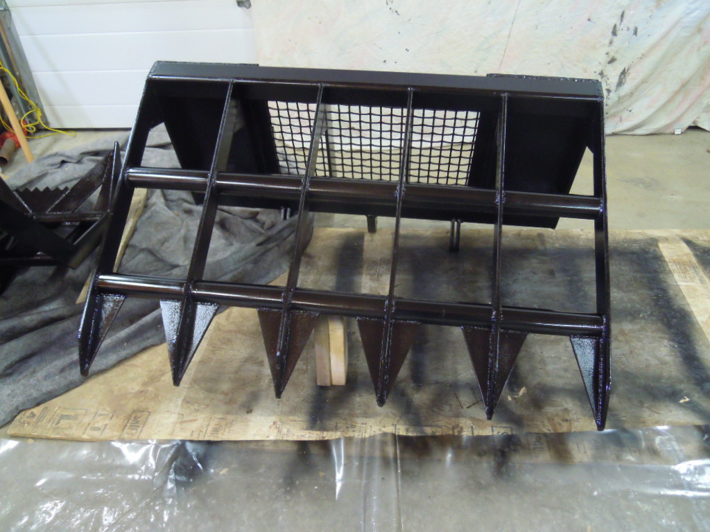

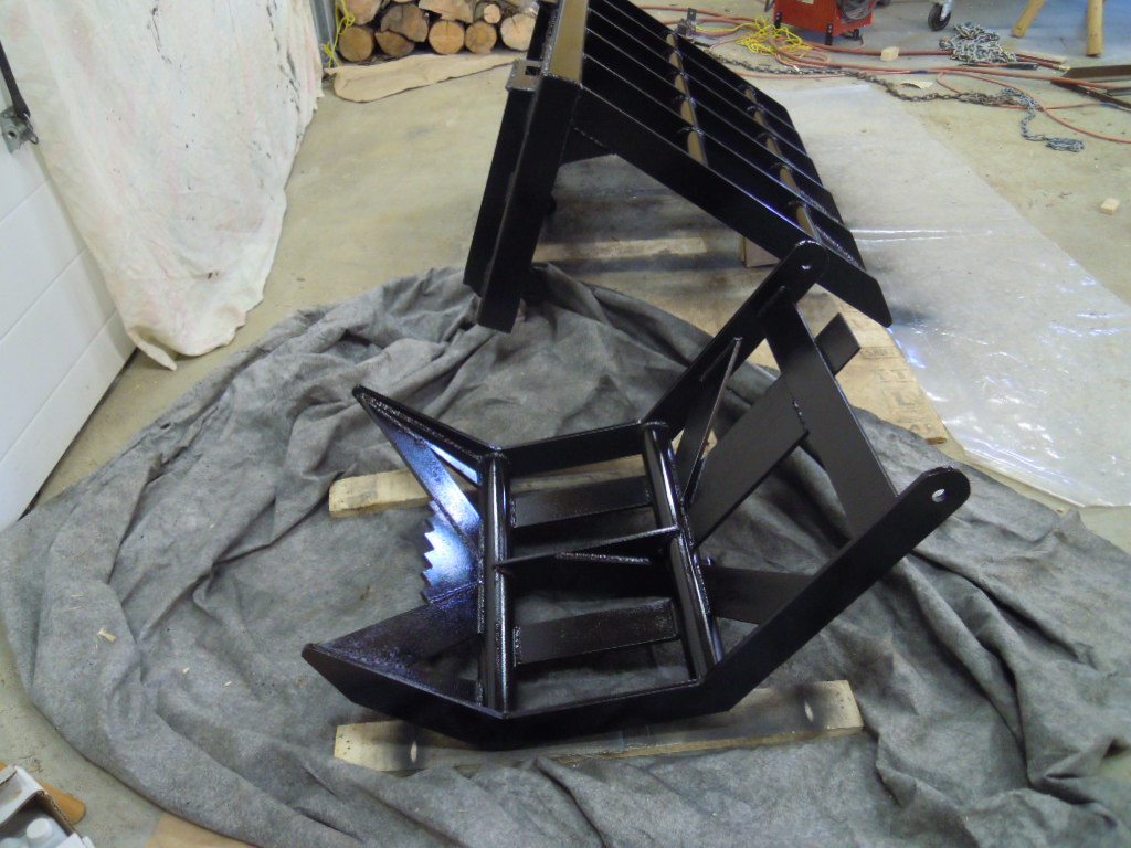

Got it painted and another coat of spar urethane on the FEL knob. Now I just have to wait for it to dry, add another coat to the FEL knob, then wire the new knob to the diverter and I will be done. I don't think I will bother with more coats of paint, since I think it won't last long anyways.
   / Grapple --- 1 Lid or 2 #163
Agree that lifting loads that twist the grapple is where you will do damage. The tines are configured vertically for a reason, that is their strongest dimension. Use a grapple properly and mild steel will do fine. Put it on a big loader and slam it around moving concrete blocks or whatever, you will bend it up. Many people don't understand that a CUT is in the 1500lb to 3000lb lift range. A big loader can be 10 x that. Easily.
   / Grapple --- 1 Lid or 2 #164

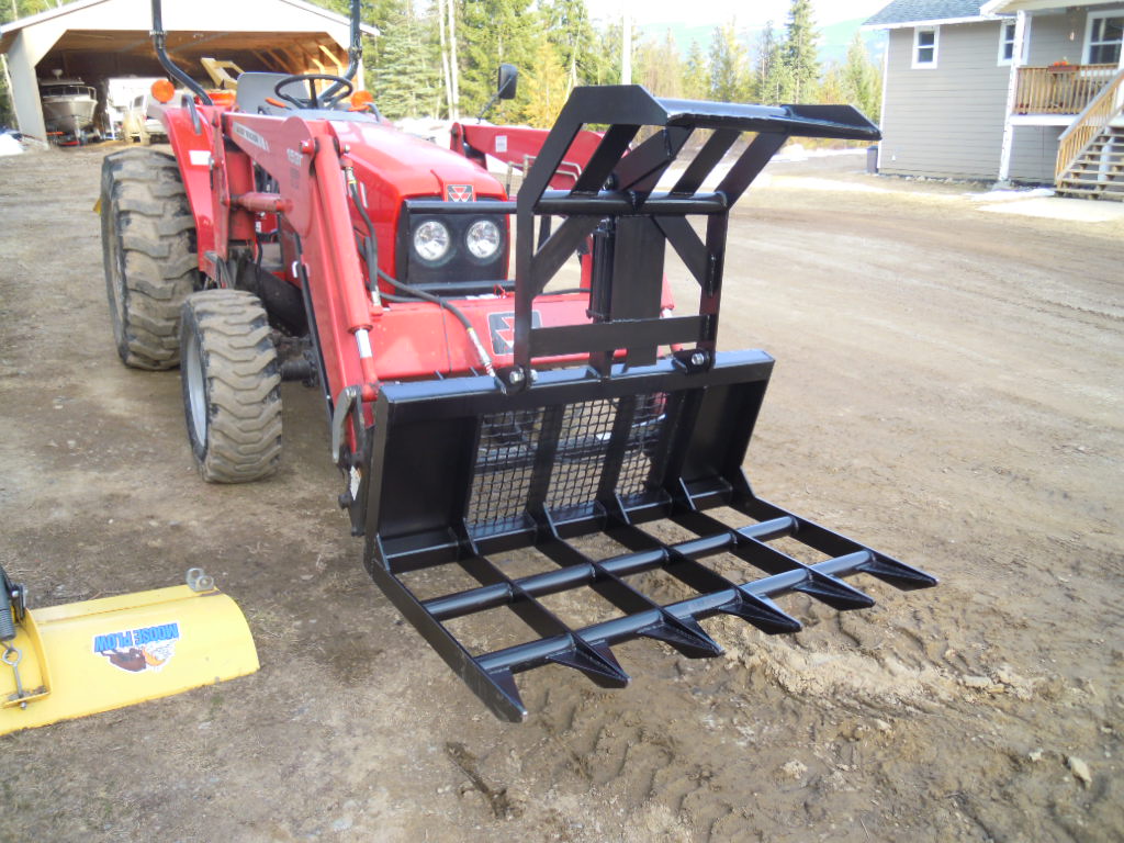

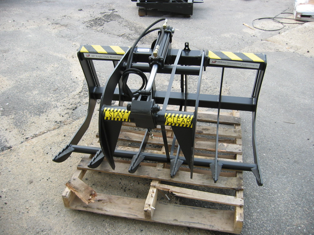

View attachment 414805View attachment 414806View attachment 414807

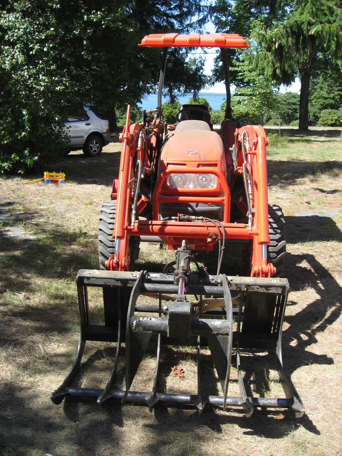

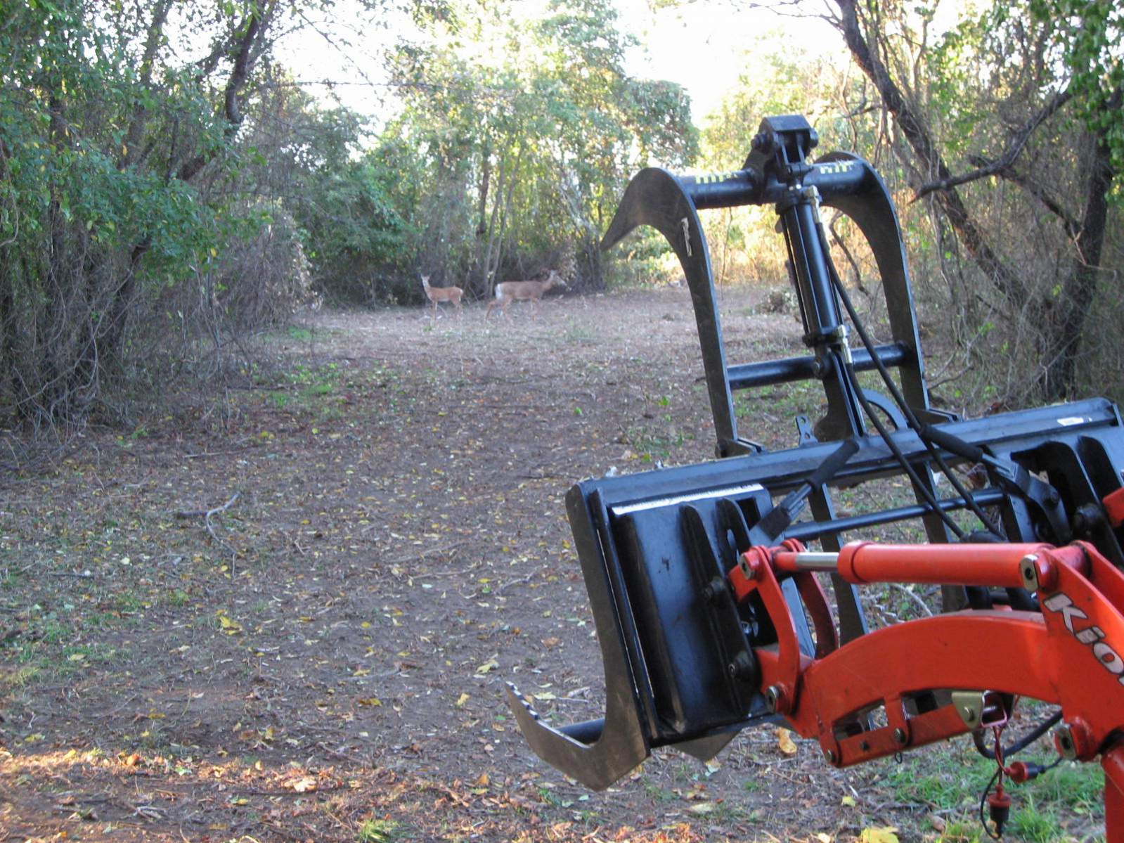

One comment based on your photo. I understand the desire to use a screen to protect the hydraulic cylinder. However, a screen like you have attached is going to snag brush and then fail to empty it so you will be (this is my prediction) frequently hopping off the tractor to pull little bits of brush out of the grapple screen. Easy to fix if you do find it a problem though. Just remove the screen and replace it with a single three inch strip of 1/4" steel directly below the cylinder.
If it helps at all, mine never has had any protection at all and the only damage I ever had was one time snagging the hydraulic line after I dumped a load. Never damaged the actual cylinder despite almost ten years of very active use. Photo of mine below. If I was building one today I would just use that 3" strip directly under the cylinder and they make sure the hydraulic lines were routed in such a way that they couldn't snag debris.

I sure hope you're wrong about branches getting stuck in the screen. I really don't want to remove it after having to make a special trip to the city just to get the material. I guess time will tell. But not for a few days. I have to go into the City tomorrow so nothing will get done until Thursday.
   / Grapple --- 1 Lid or 2 #166
Here's an idea. If branches do get stuck, leave the screen and bolt on a thin sheet of pexiglass underneath it so the branches are deflected away. The screen will then allow you decent visibility, protection and prevent food between the teeth syndrome).

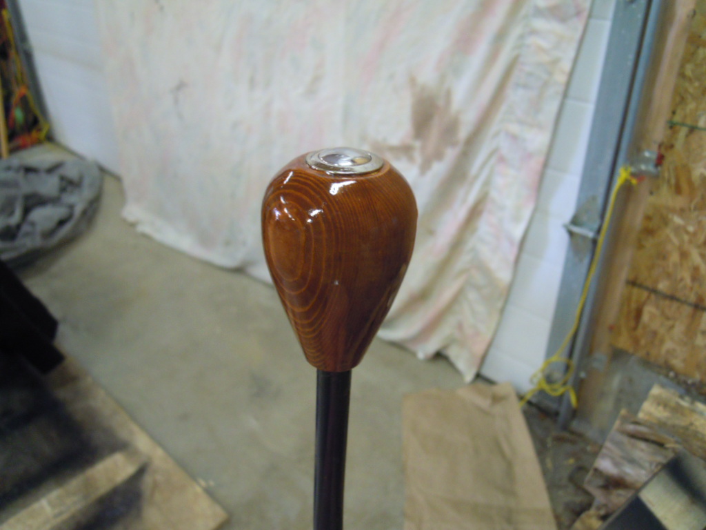

Boy that home made wooden know sure turned out pretty. It should last pretty well too. Of course you can always hit it again sometime before you put the tractor away when it starts to wear away.

I'm really liking the way it turned out and thanks for the tip on the Spar Urethane. That is what I used and I think it will be very durable and looks cool too. I can't wait to try it out instead of using my temporary toggle switch. This should be way more convenient. I've got 4 coats on it now and will likely add another one before I go to town in the morning.

I have used it on some cedar benches that have been sitting out now for over 2 years. I think I put about 3 coats on the tops. They still look pretty good in sun and rain and snow, and all. The stuff don't smell too good going on until it is dry, but it works well. The wife can't stand to be within 50 feet of it when I am applying it..

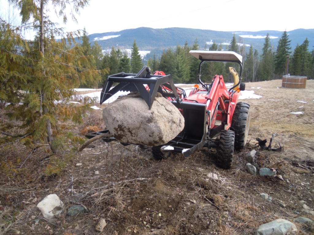

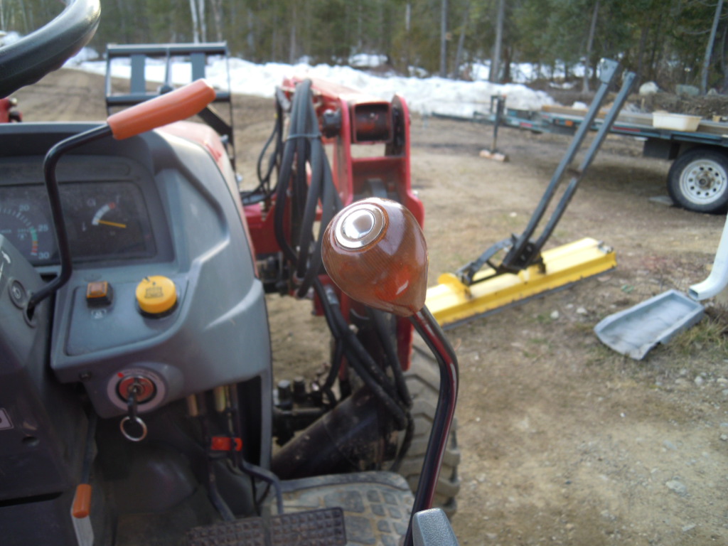

IT"S DONE!!!!!!!! and it works too. :cool2:
I tried it out a little and was impressed that it picked up a fairly large rock without any damage. I could tell by the way the tractor reacted to the load that it was quite heavy. I also tried grabbing a small log by the end and quickly discovered that it not as easy as I think it should be. I may need to make some mods if I want to do this very often. There appears to be a need to have something on the lower tines that lines up with the teeth on the lid, otherwise the lid pushes the log down and the butt of the log turns up, ie the log rotates because the grab points are offset from each other. Oh, and I love the new switch location, it makes a world of difference having the switch on the FEL control. I can see how there will be a lot of uses for this. My neighbor seen it and says he is jealous and wants one for his tractor too.
