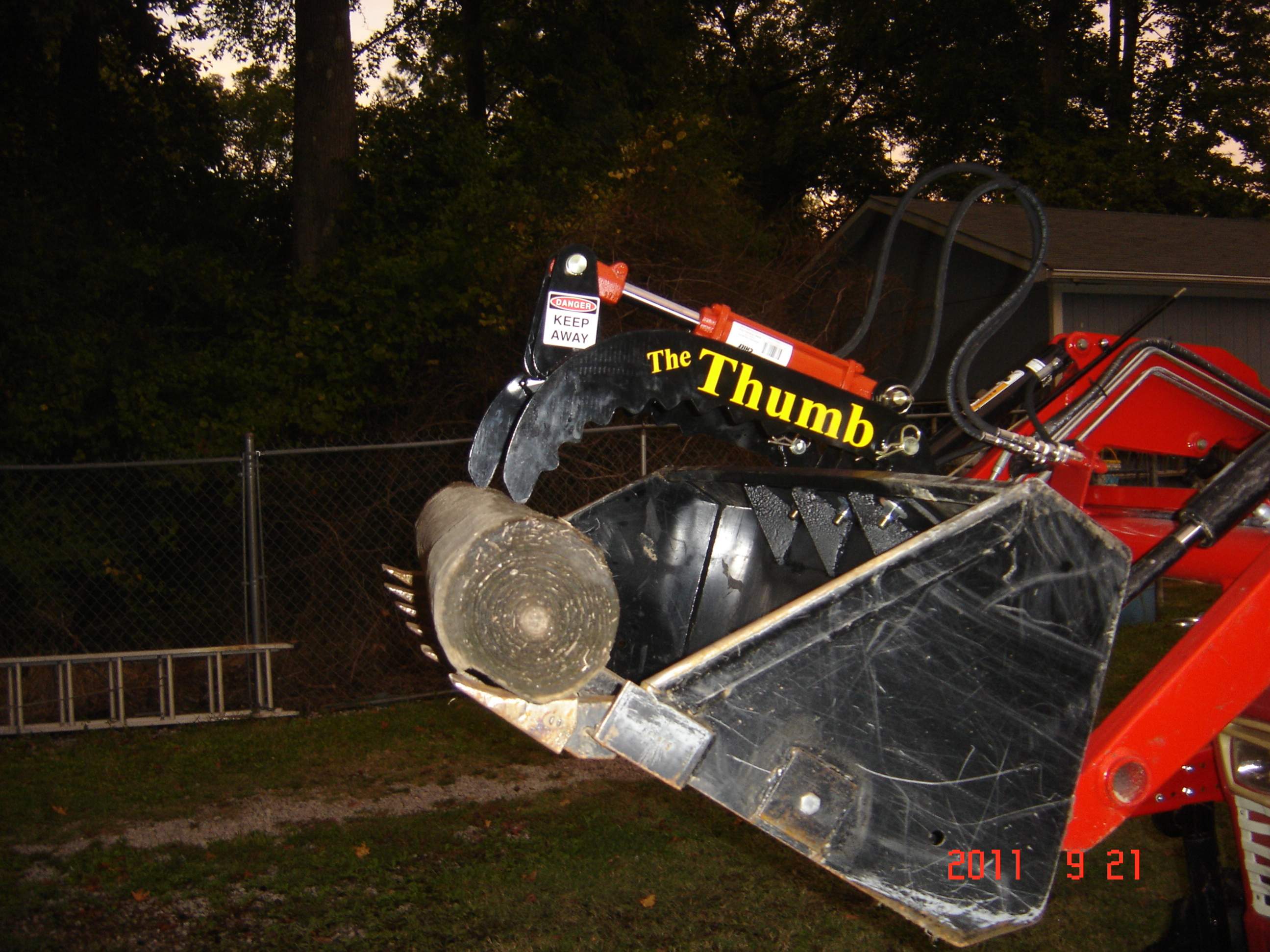

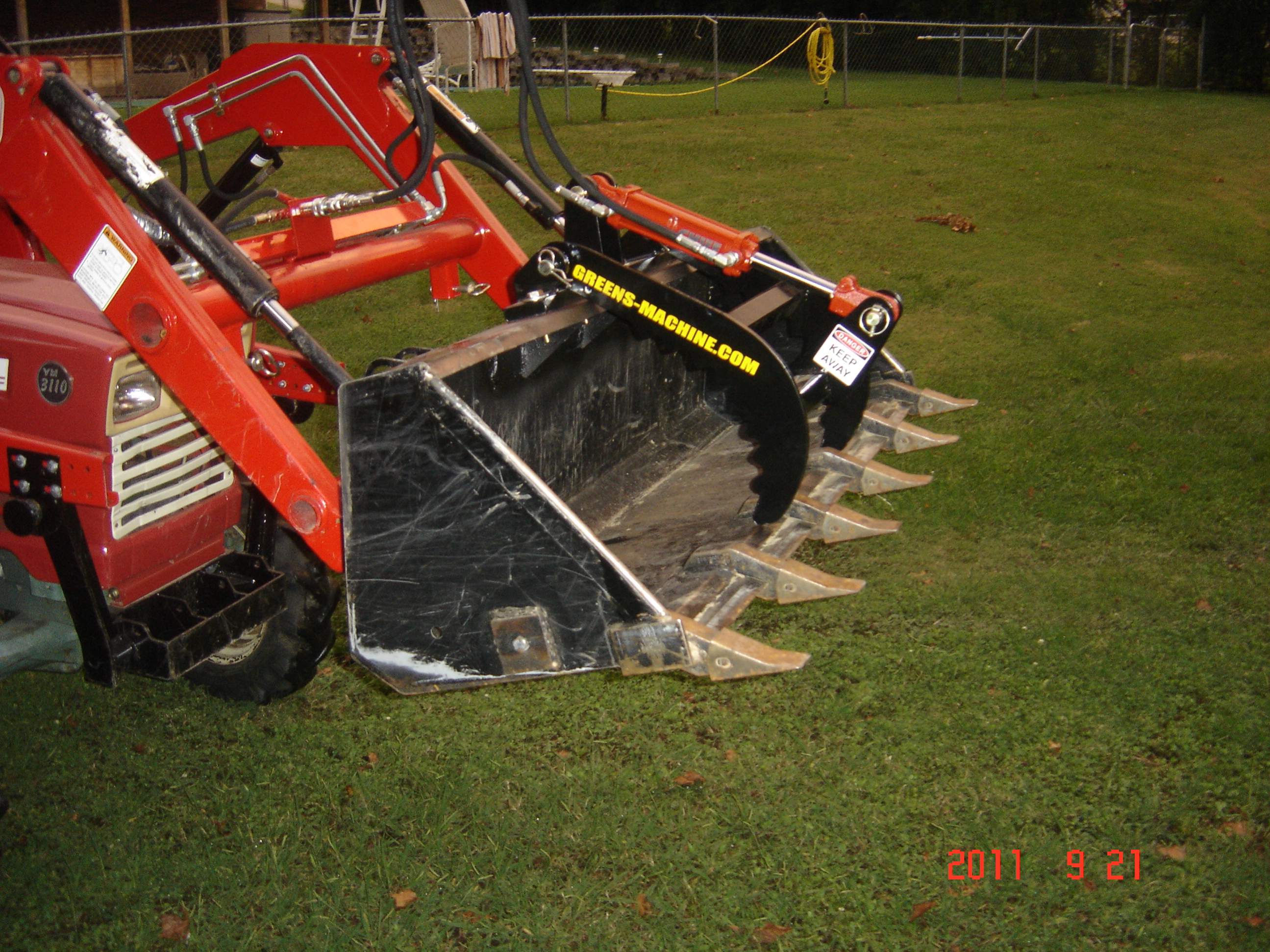

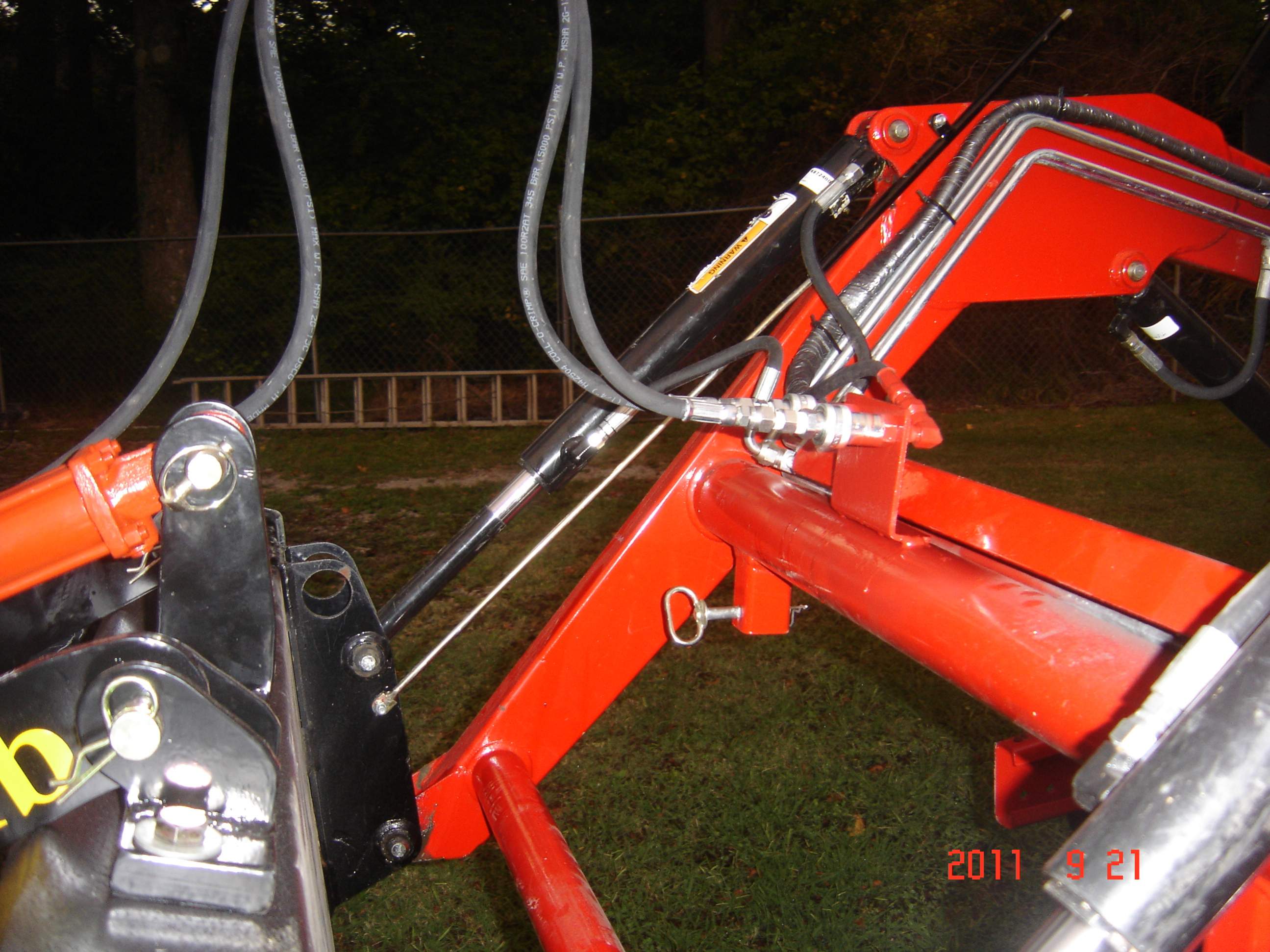

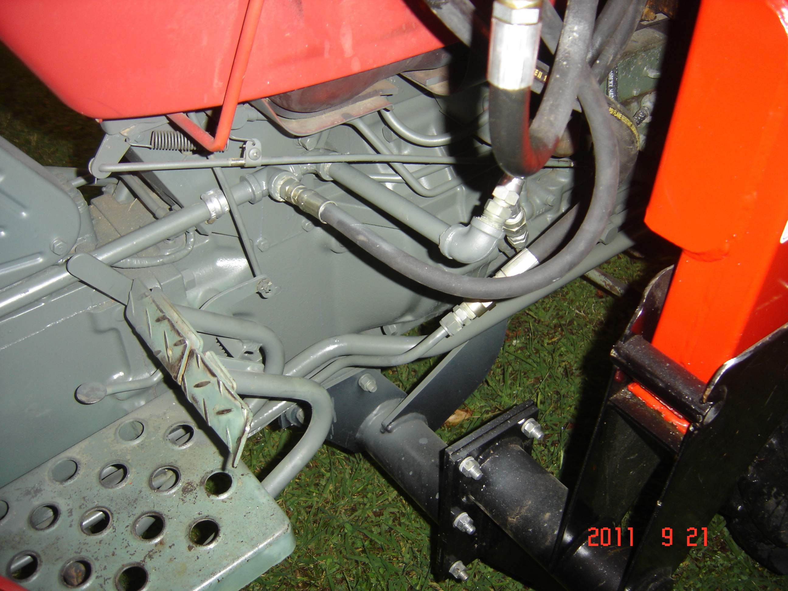

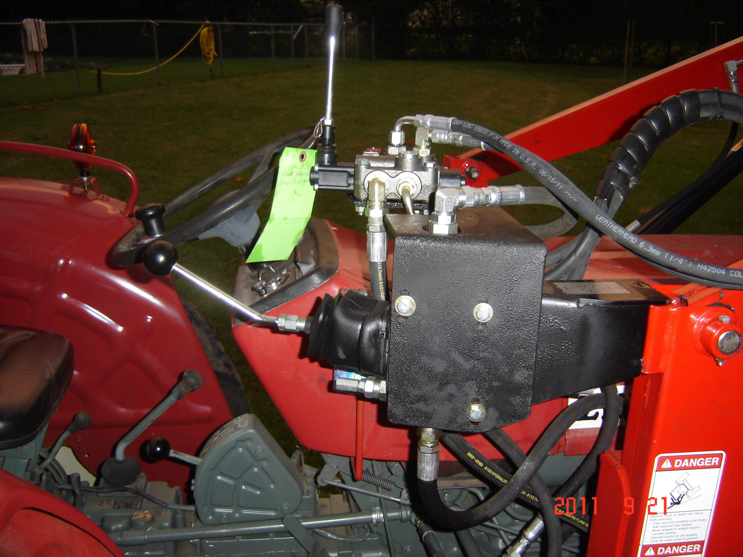

Well, after alot of work it's complete. A BIG THANKS to all that answered my questions & steve for posting the pics.:thumbsup::thumbsup::thumbsup: You can see in 1 of the pics. I found an inspection plate behind the power shift. I made a plate, welded in a nipple & made a return to tank .The hyd fluid for both valves now return to the tank & the 3 PT is fed by the grapple PB

a few more pics

Congrats Ken, looks great:thumbsup:
/ Grappel Update.... (The Thumb) #4
Looks good, Ken. :thumbsup: You'll soon wonder how you ever got along without it.

Great job! You made a nice clean install out of it. Is the bucket reinforced to hold up to the extra torque? Does it warp when you craw into things, like that post in the pic?
The control lever looks a bit awkward to grab. Maybe it's just the photo making it look really high up.
If you look real close at the 4 th pic in the 1 st post you can see where I added gussets to the inside top of the bucket. I also welded some 3/16 plate to the bucket at the back & top of the bucket (inside) & welded the gussets to that 3/16 plate.(Correction... 2nd post 3 rd pic) The valve isn't too high for me. I'm 6'3. The handle will also screw into a straight out position ( instead of straight up) if needed

It's good to be able to pick up things without having to have another person to help . I can tell you that feeding HYD fluid to the 3 PT from the loader valve PB port instead of the outlet port makes the FEL operate much better

Question-Is the elbow (looks like one anyway) to the front of where the fel valve LP return is tee'd into the sump return pipe the LP return from your new grapple valve?
