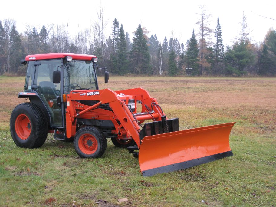

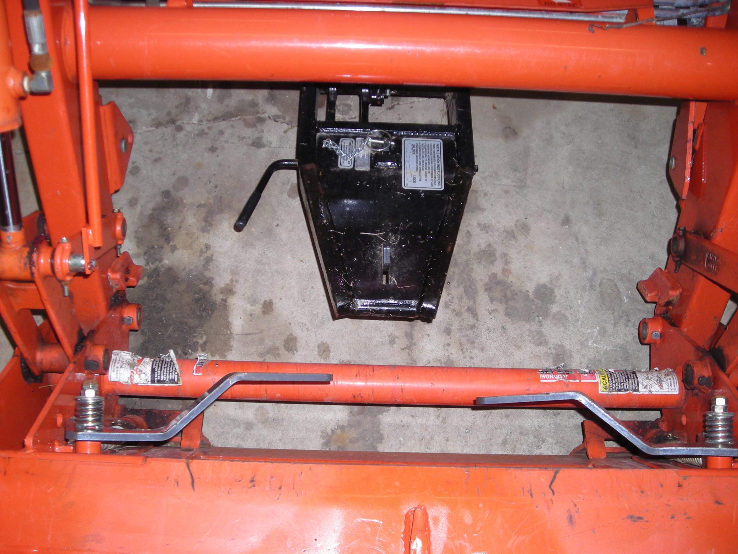

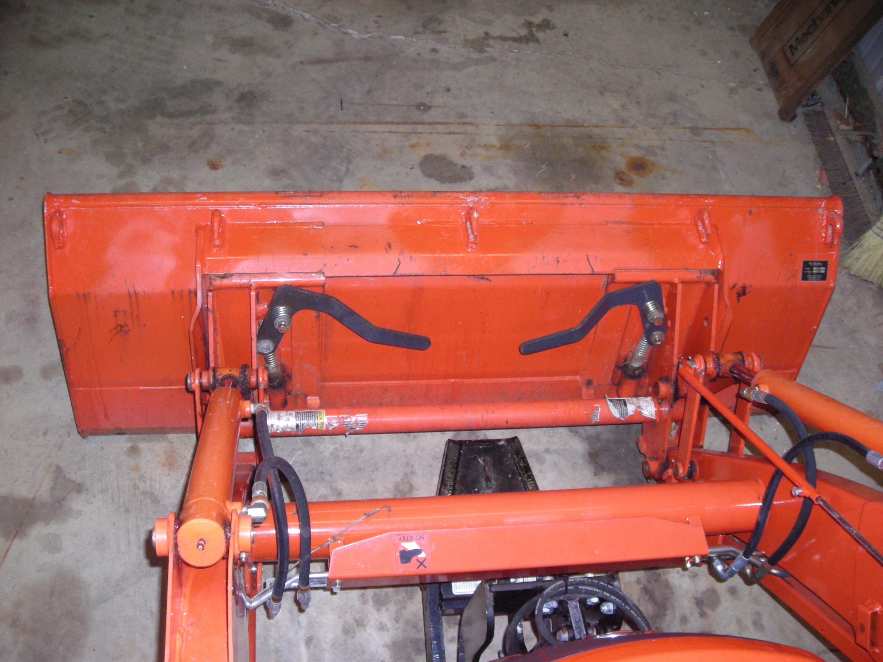

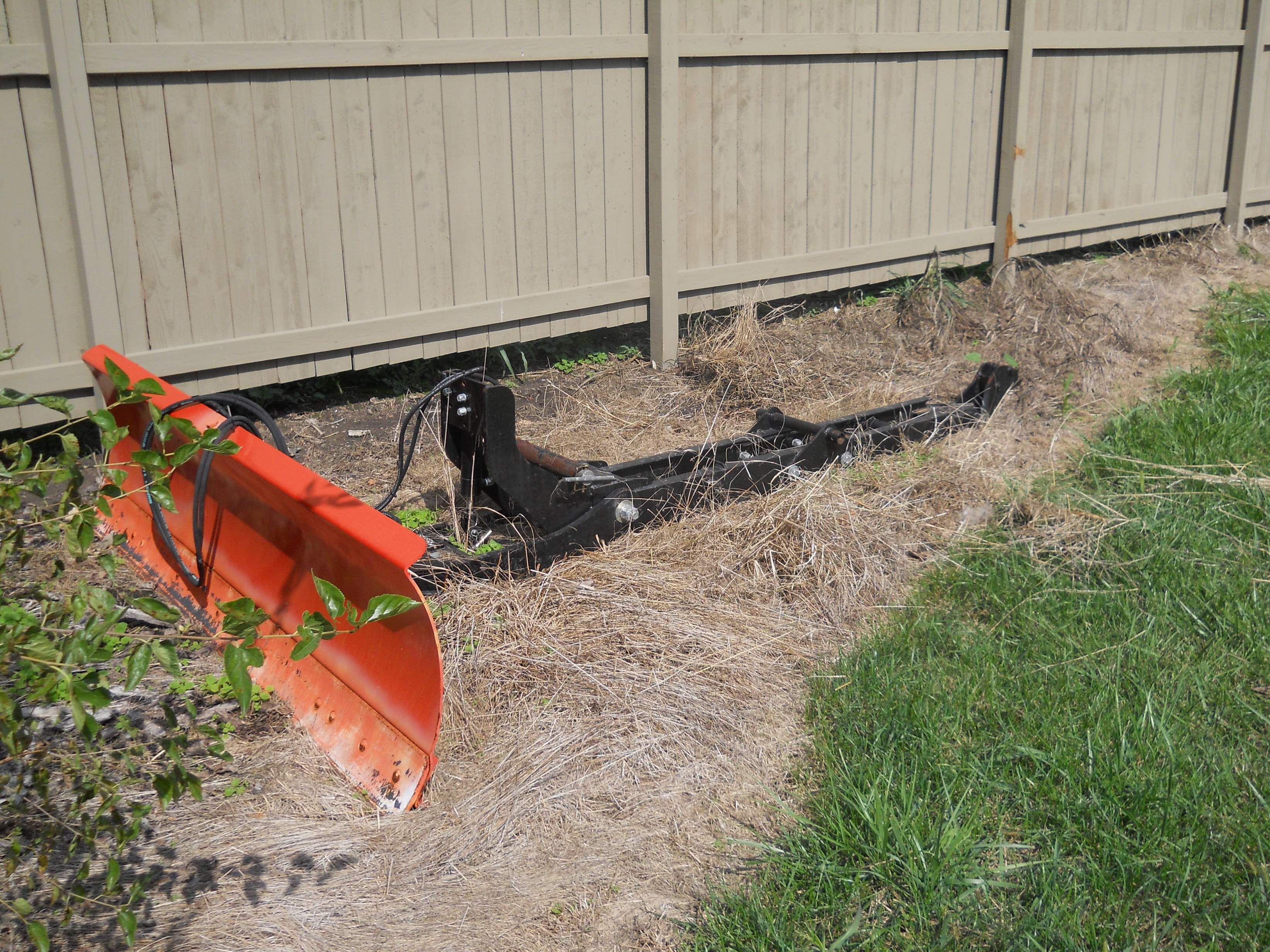

The Kubota front blade is very effecient and heavy duty, as it should be. Is it easy to remove and attach the subframe, not like the loader, 10 minutes on concrete floor, 15 minutes on earth, but the more you do it the quicker you become. You can remove the blade, leave the subframe on, and use the loader, but you have to be careful of the bucket curl, there can be some interference with the L3940. This is not the case on the L4240 as another poster has contributed, not sure with other models. I am very happy with the subframe mounted blade, it makes quick work of our long driveway, but I do not use my fel much in the winter months. Philip.

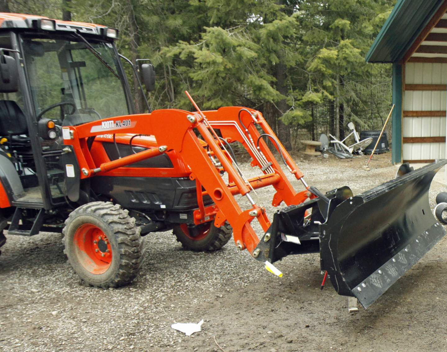

I have the quickattach .... bught it from a salesman from their company a few months back. I also bought a rear powerpack and loader mount snowblower. They threw in the shipping, and if i bought a 3rd item, they took of an additional chunk of $$ that made my set of forks almost free.
I love the quality of this equipment. I also got the 2 side gates for the blade and the hardened shoes.
cant wait till snow falls.

the prices have gone up since i bought in June, now its around $2,800 for 84" plus side gates and shoes.

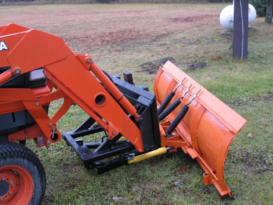

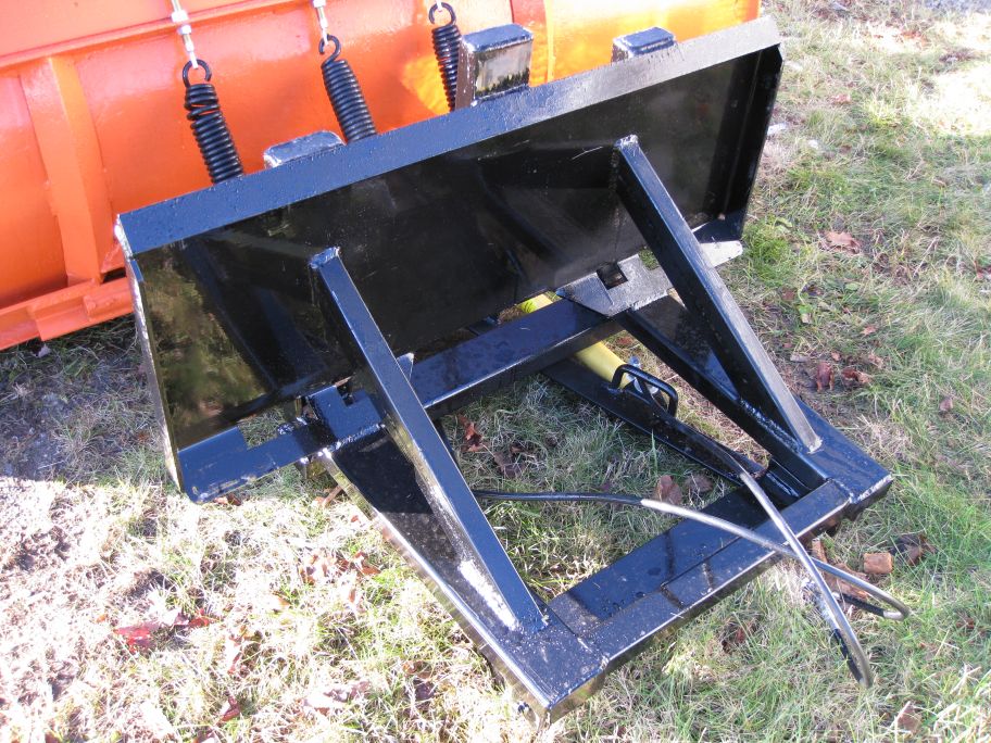

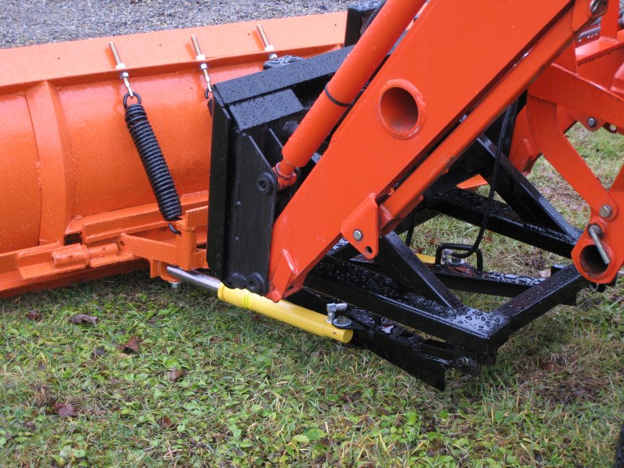

this was how i did my plow, total cost was $1000.00 . ray

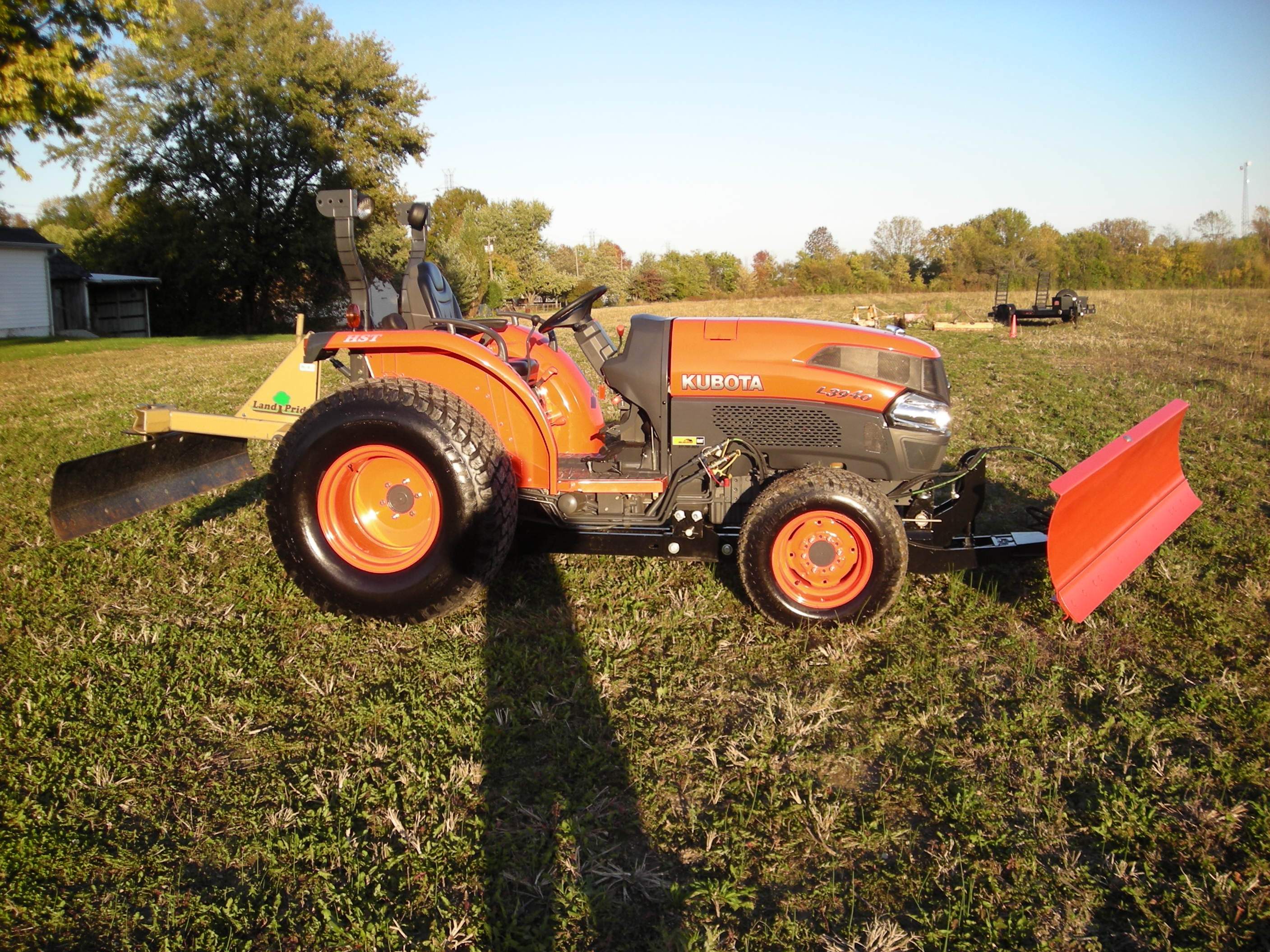

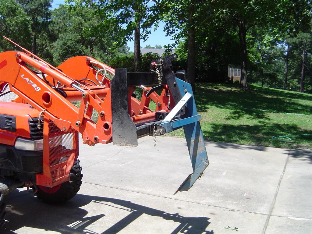

Another alternative is getting a quick attach 3 point hitch for up front. Then if you have a scrape blade...you would attach to that up front.
Pic is my 3 point hitch with my subsoiler on it. A scrape blade could attached and be rotated around. You could then use other rear attachments up front on the loader, too.
I have a WildKat 3 point hitch and it works well.
