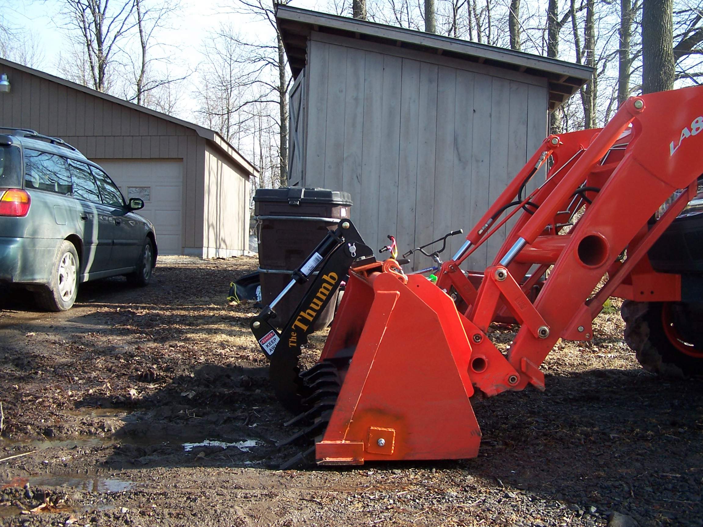

My Grand L5740 has no problem with my grapple bucket. And I can turn a gravel drive into a sheet of glass with my box blade and top-n-tilt on the 3pt.
View attachment 299085View attachment 299086

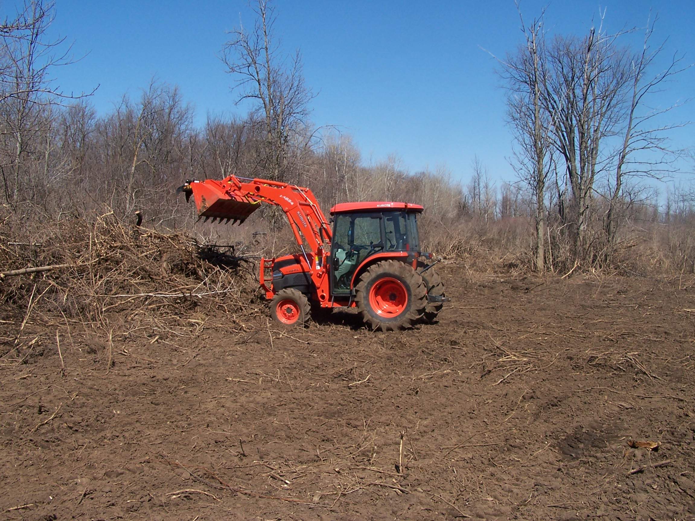

My rears are loaded and I usually have the box blade on back.Like stated with enough ballast and HST+ you should be fine with the L4240.The 854 loader is very powerfull,more than enough for brush ect.I have R1's and inflate to max when doing a lot of loader work.
