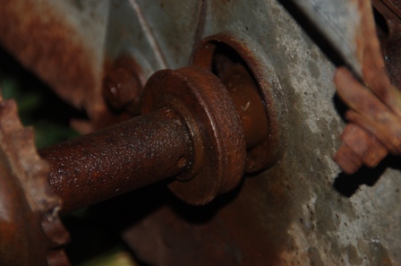

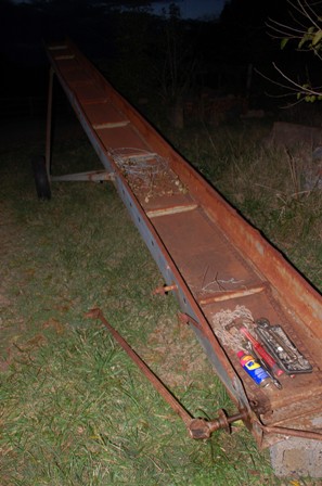

My old style grain elevator broke a sprocket. I have NO idea how to get it off and replace it. I have attached some pictures for advice.
Pic 1 First the elevator.
The sprocket is on the far right, this one is OK.
The PTO shaft, I thought would slide out after I took all the screws out of the sprockets.

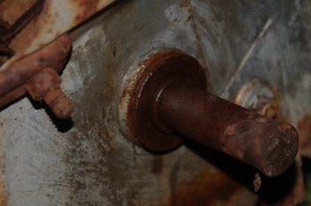

Pic 2 This bearing is firmly holding the shaft. How does the shaft come out?

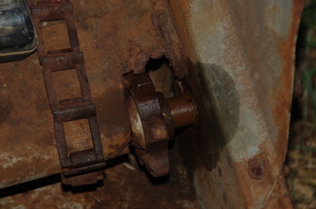

Pic 3 This looks like a bearing. But it is firmly attached.
Pic 4 This sprocket is cracked and will not tighten down to the shaft. I need this off the shaft.

In pic #2, it looks like the end of the shaft has been hammered al long time ago. Like maybe someone tried or succeeded in driving the shaft through the bearing?
It really looks so bound up you might consider rebuilding it. Can't be much left of the bearings. Don't see any grease zerks, probably sealed bearings.
I am assuming because you can get it apart, you can't take the shaft completely out and use a shop press on it?

Yep, you would think it would slide off the bearing right? I used a whole can of wd40 on it. But those bearing will not budge off the shaft.

Just wondering but does that "bearing" spin freely, or is it bound up? You might consider taking a sawzall and just cut it off, being careful to cut the last little bit of it by hand with a hacksaw. That SHOULD at least get the bearing off, which looks like it needs to be replaced anyway. There should be enough left of it to take it to NAPA and get it matched up to a new one. After you get it off, you might see about taking the shaft to a machine shop to see if it can "cleaned up" some on a lathe. I doubt a new bearing would just slide right on the way it's been mangled up. Good luck with it.

That is a grain elevator. Its being used for hay lifting, probably by turning the square bales on their side. No problem. I do the same thing with a 1932 New Idea grain elevator.
The sprockets themselves are hard to come by, but are commonly used on this link type of chain. I'd tack weld it back on the shaft, or drill a hole through it and push a drive pin into it. Be careful to align it exactly the same as its partner on the other side. The grain dams that lift the hay bales are cross connected to the opposite side, so your sprocket teeth have to be in the same exact orientation. The bearings are standard at a TSC store as is the conveyer chain (several chain link lengths, though). To make and break the chain connection easier, they also have a conveyer chain holder. You put the chain in there, turn it 90 degrees and wack it with a hammer.
It looks like you are running the elevator in direct drive from the tractor PTO. These rigs usually have a chain gear reduction shaft to run the action at "walking" speed.
BTW: The sprockets are usually pinned to the shaft. I replaced the solid pins with split roll pins to make disassembly easier the next time. They aren't as strong but are sure easier to push out. (Hope there is no "next time", though).

Excellent advise. Yes, I flip the bales and up they went. Unfortunate, there is not enough of the sprocket left to drill through. It had a set screw in it, which broke and took a good portion of the srocket with it.

Figured I'd update this thread. After exhausting my search efforts for the sprocket, I gave it to a friend of mine. He used his vast network of knowledge and actually found someone who is machining them. So I have it in hand, but will need to weld the sprocket onto the sleeve supplied that rests on the shaft once I get it all lined up.
