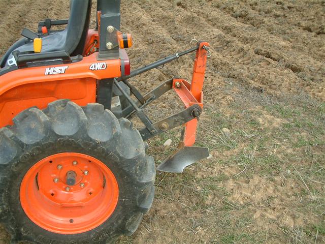

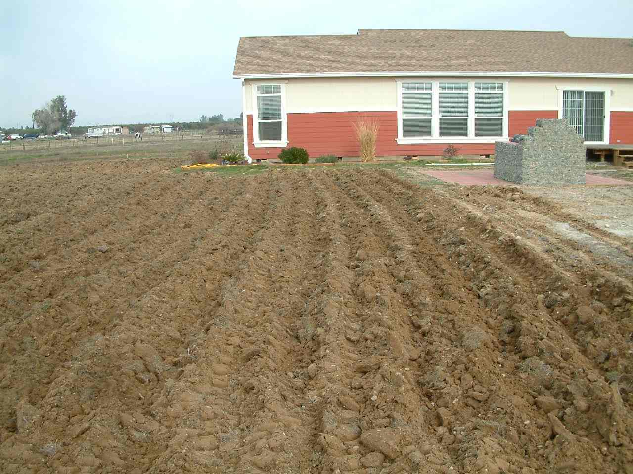

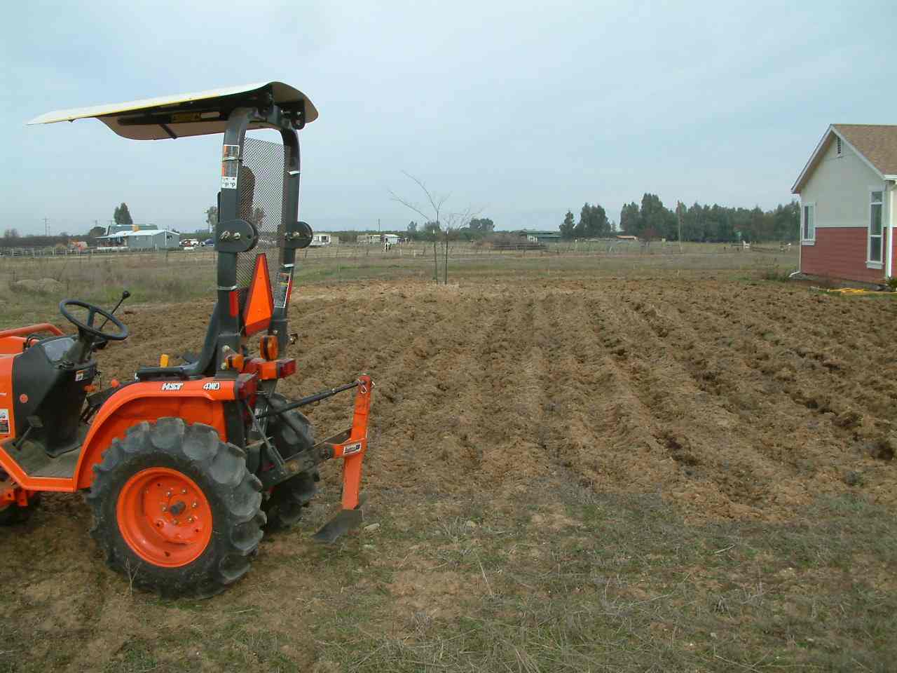

Here's how I did the preparation for landscaping around my new house a few years ago.
Plow with a middle buster (aka potato plow, $150 from Tractor Supply) using my 2005 Kubota B7510HST (21 hp engine, 17 hp pto, ~15 hp drawbar, 4WD, hydrostatic tranny, power steering).

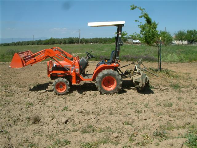

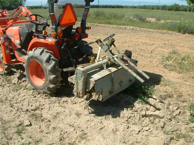

Bust up the clods with a used Yanmar RS1200 rototiller ($300 from my local grey market tractor dealer).

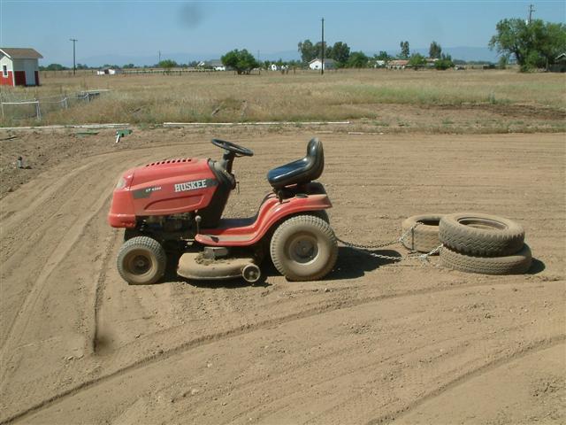

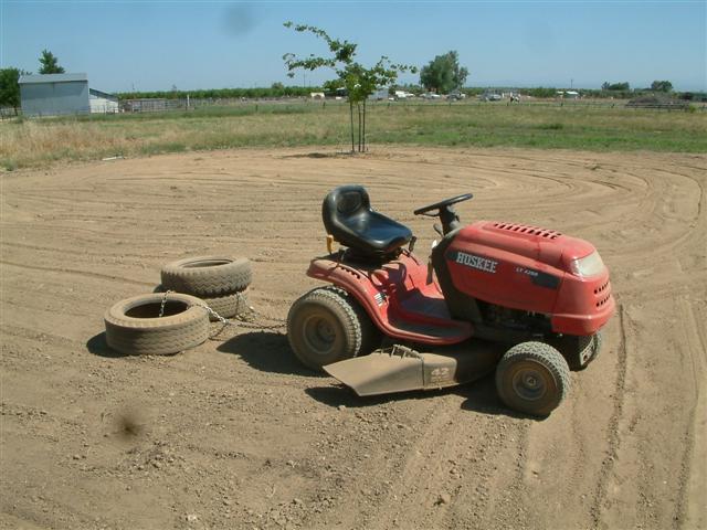

Smooth with a simple tire drag and my riding mower which has turf tires (the B7510HST had ag tires that would put ruts in the soft soil).
