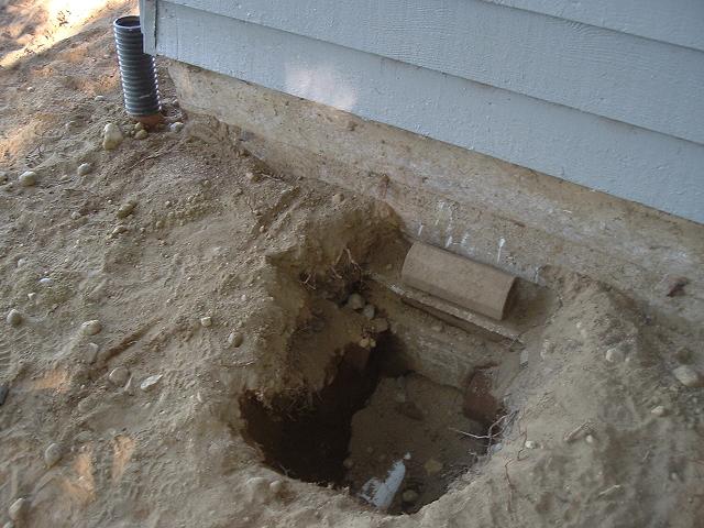

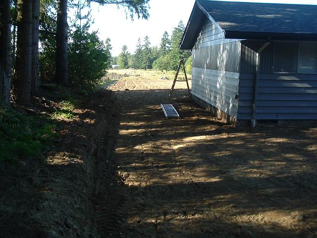

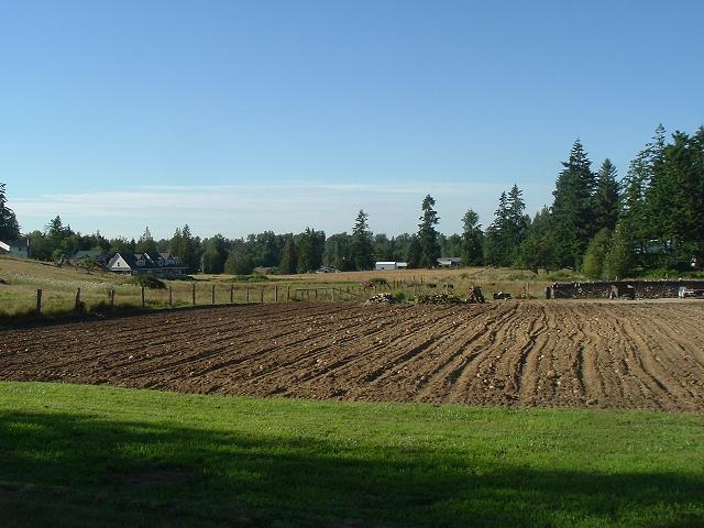

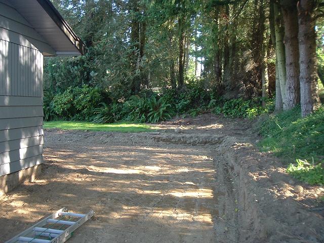

Picture time. Imagine your photos and then apply my fixes as you see fit. Ignore the file name numbers and use the below numbering.
1) My crawlspace outlet. Below the footing beneath a non-load bearing wall. 4" pipe. Note also the clay tile that they just butt together.
2) Looking uphill at where they dug out of the bank for the house and how I was able to lower the grade at the house and then slope away from the house for 15-20 feet at 2% which made a vertical wall of about 2 feet.
3) Looking away from the cut bank down grade to where all of this will be routed. I have plenty of fall thataway.
4) I used the excavation spoils to level out my pasture. At least 30 yards. It moves really fast when you realize that scooping it into the loader is much faster than dragging it away with the box scraper.
Let me know if you could use any more photos. I am in Buckley in the south sound if you want to stop by. This weekend will be the big pipe day.
