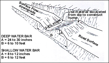

Start at the top of the hill and work down, building as you go. A box blade works pretty good for making them. Open top culverts work better and are easier to maintain but are much more labor intensive to build.

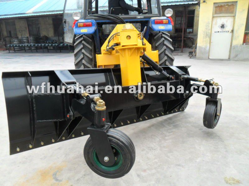

My first thought is for a rear blade with gauge wheel(s), and easy it over the bars without cutting. Never used one, though.
Center wheel(s) on frame:
or two wheels on the blade:
The Bush Hog blade parts manual shows several "tailwheels" that could be copied or bought.
