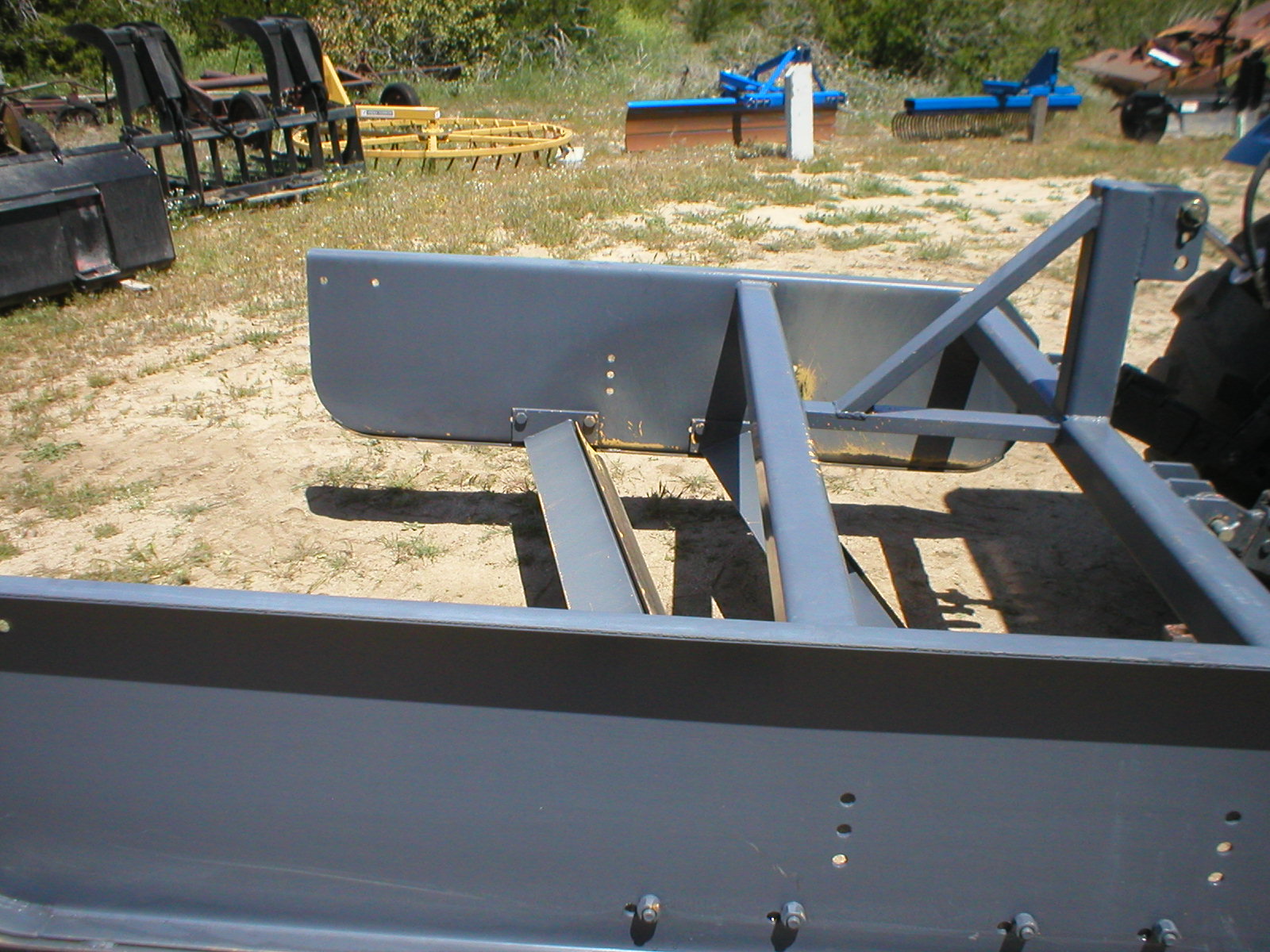

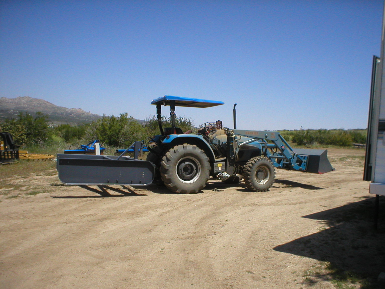

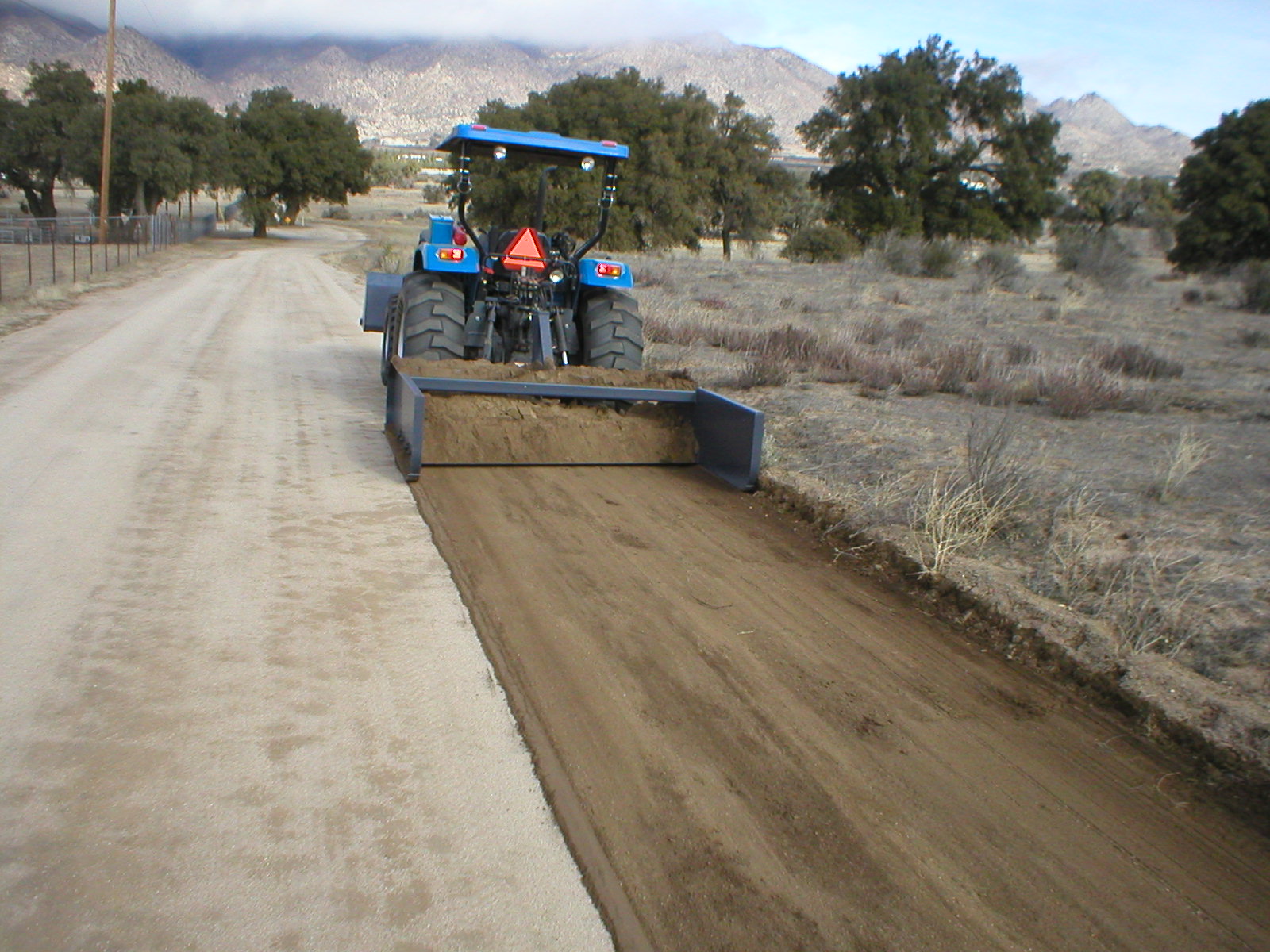

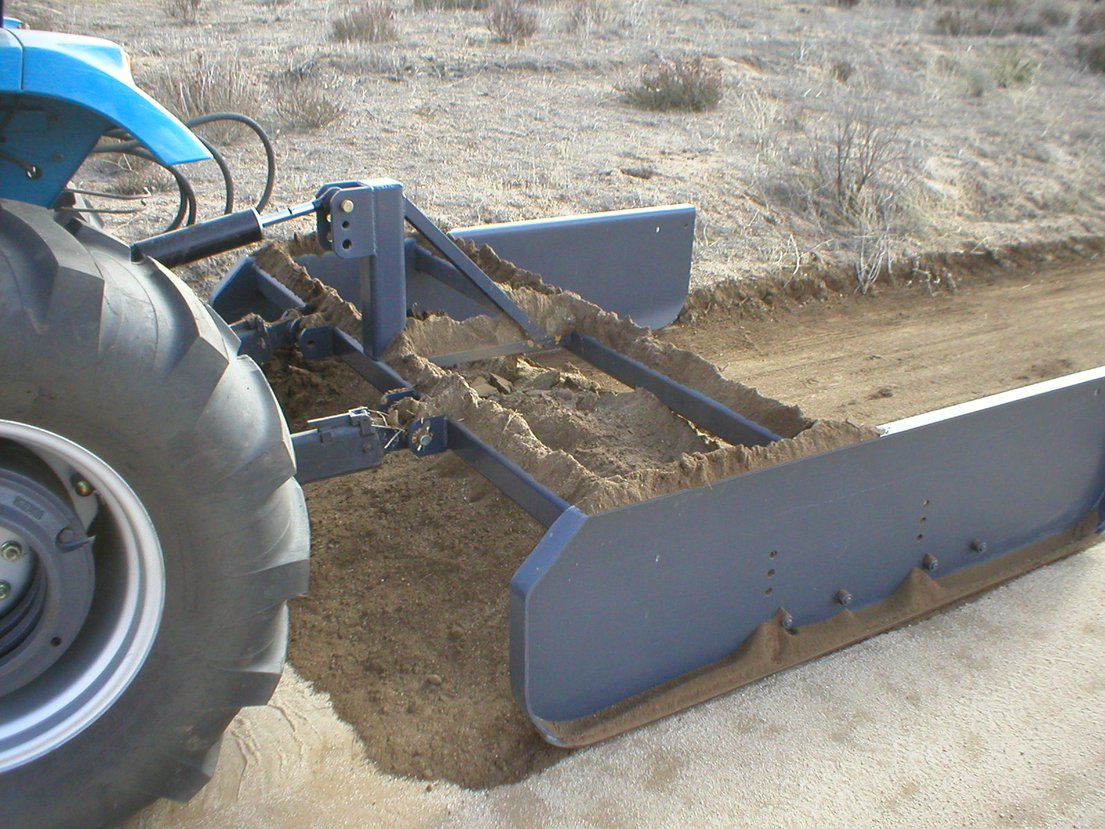

The sides on this unit are 22" tall, and I routinely have material over them. A lot depends on the type of material being graded, moisture content and if I'm lazy that day and don't pay attention. There are a lot of times that I don't pay attention. ;)

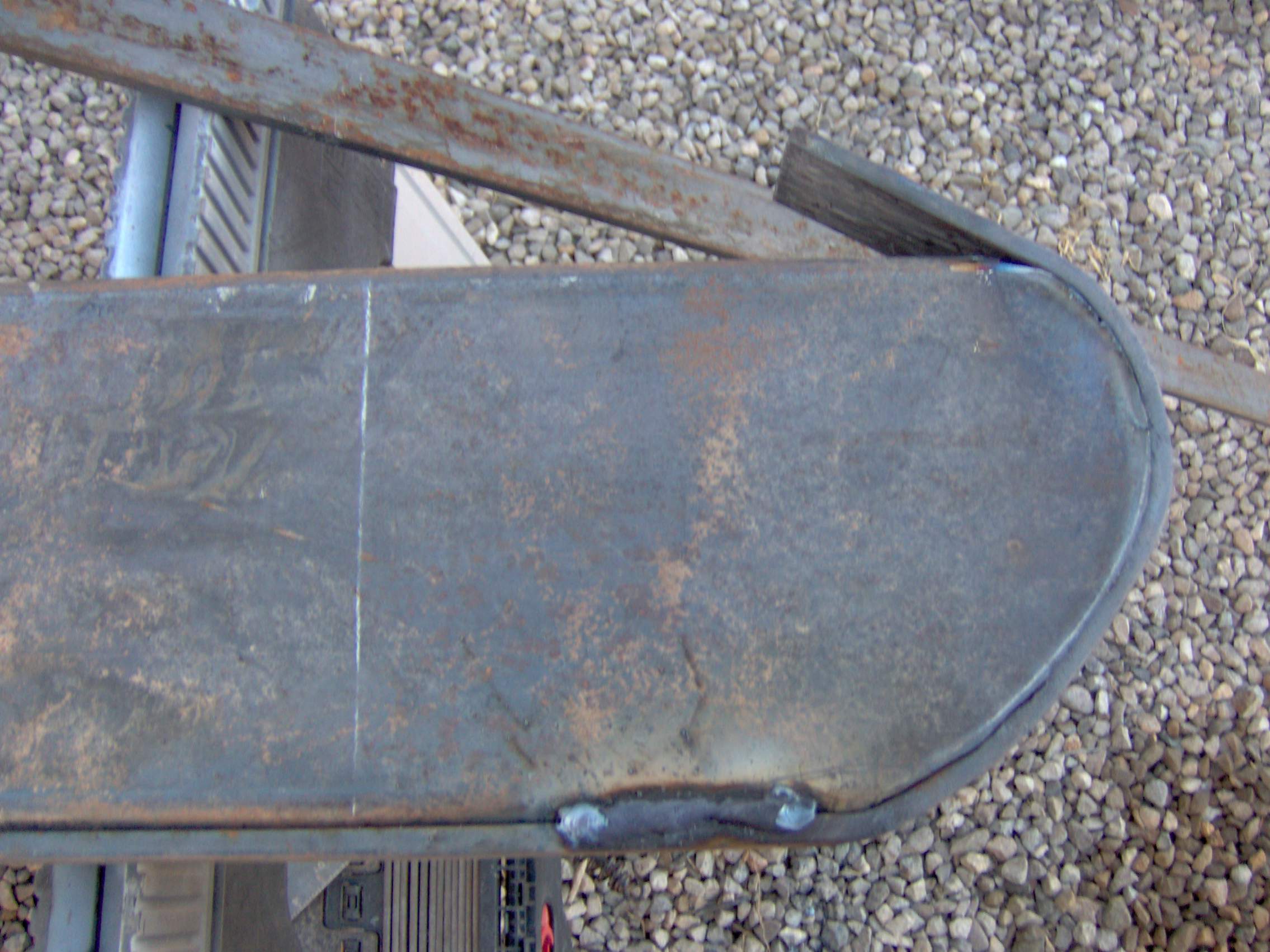

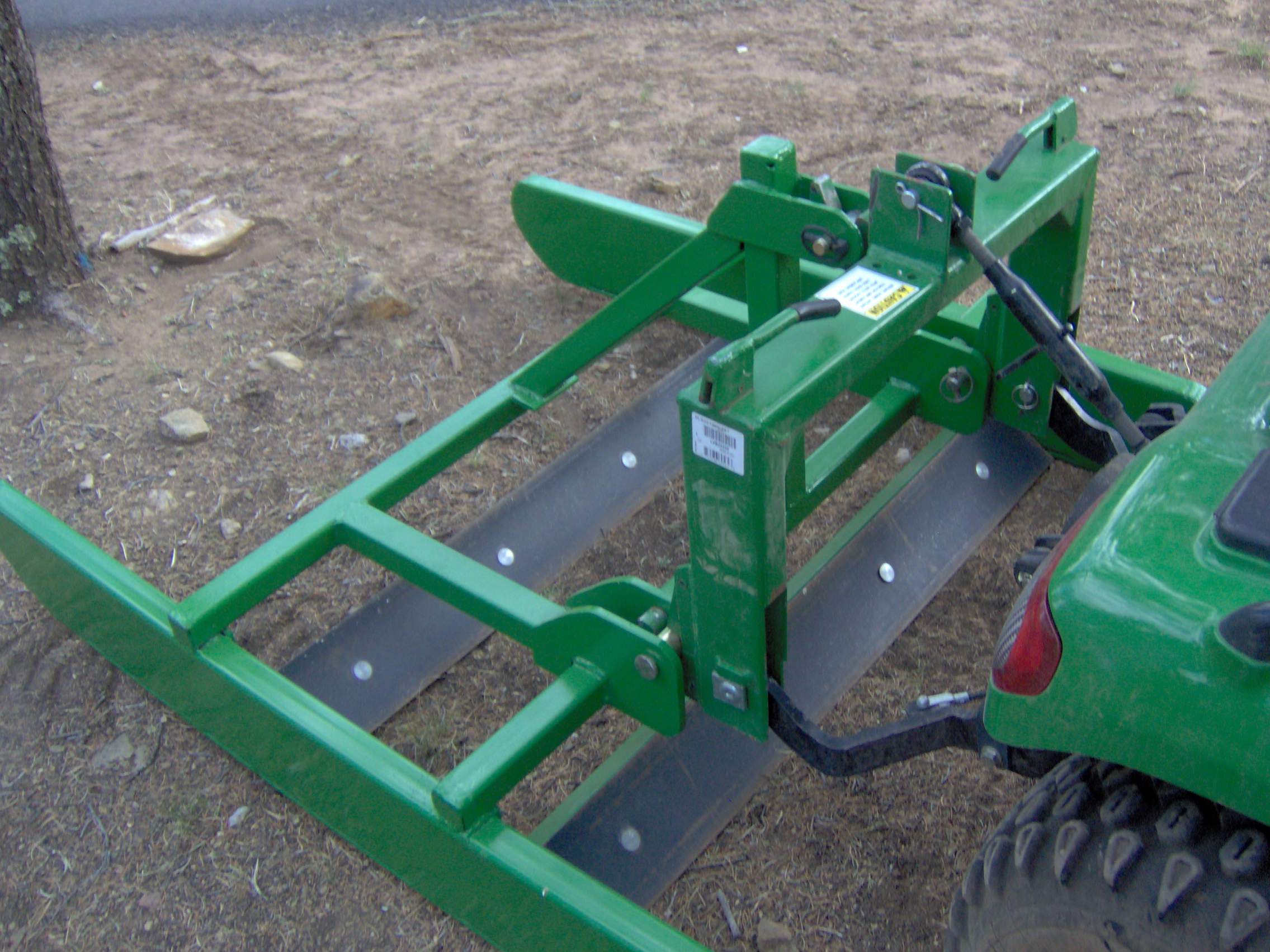

Using the rectangular tubing is a good idea, plenty heavy, and doesn't hold the rocks letting them fall on the grass areas. When I built my small landplane I used rectangular tubing for the skids and add the wear strip on the bottom which also wraps around the end of the tubing to close it in. Here are a couple of pics of the build.
I took those pics to my friend as well.:D
Yup, I saw those pics and that's where I got the idea to use rectangular tubing. :thumbsup:
