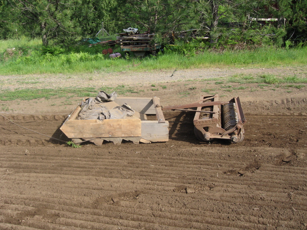

The one thing that I noticed about yours is the blades are straight across, which means you are only doing flat leveling. For some, this grader would be for their driveways, and mounting the blades at an angle from side to side would allow you to crown the road. The amount of tilt on your top link and the angle of the blades controls just how much crown.
I have seen where some people mounted them straight across like yours, but raised them 1/2 to 1" on one side, which means they will never be able to do flat leveling. I like the side to side angle because you can do both with it.
Although these types of graders appear very simple in design, there really is a lot of engineering built into them if you want them to work very good, to great, or not at all.

this is the scrub, it does a good job, the wear edges are reinforced with recycled grader blades.

Down here in Louisiana, we call those Bionic blades. I noticed from your pictures that your front blade was angled way more than your rear blade. We do just the opposite down here. May want to give that a try. My brother and I built one that is 7' wide and we made the front blade where it can be 1" below the edge, even with the edge or 1" high. It is amazing what you can do with one of those blades.
