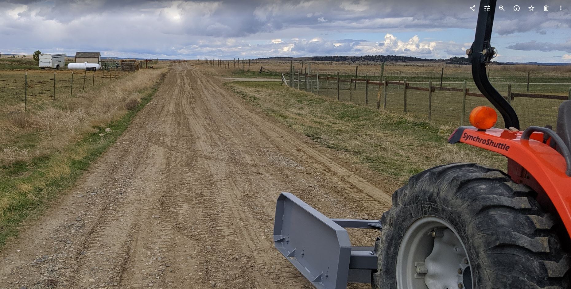

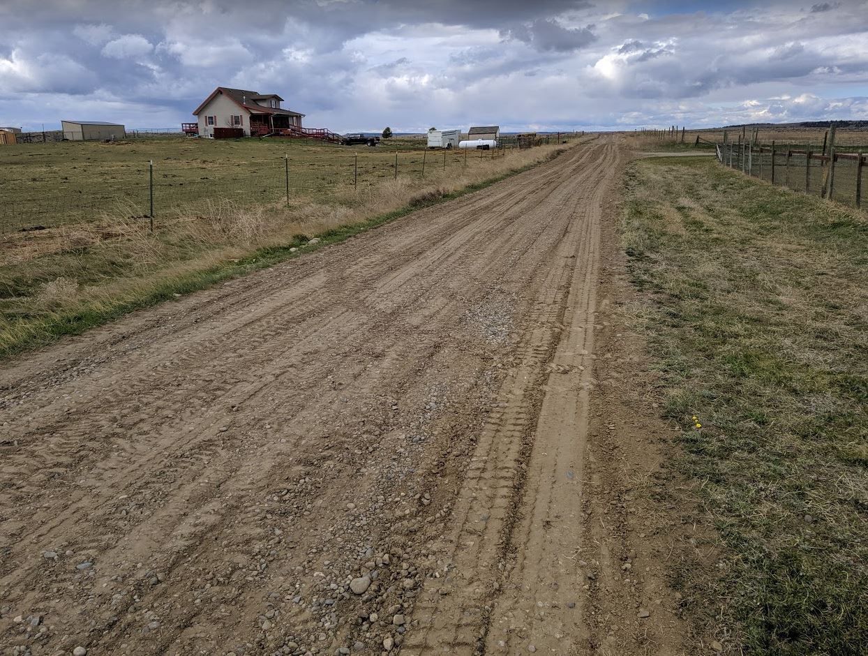

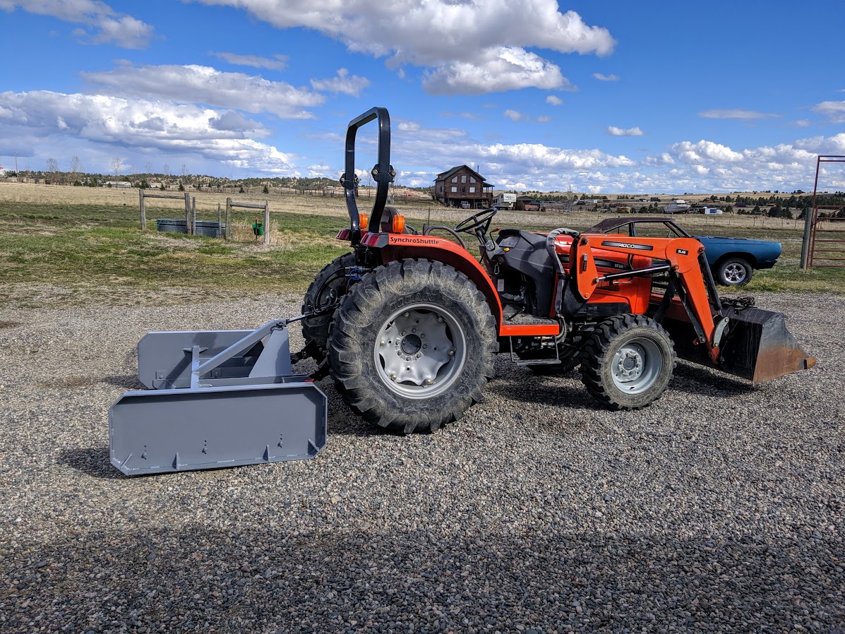

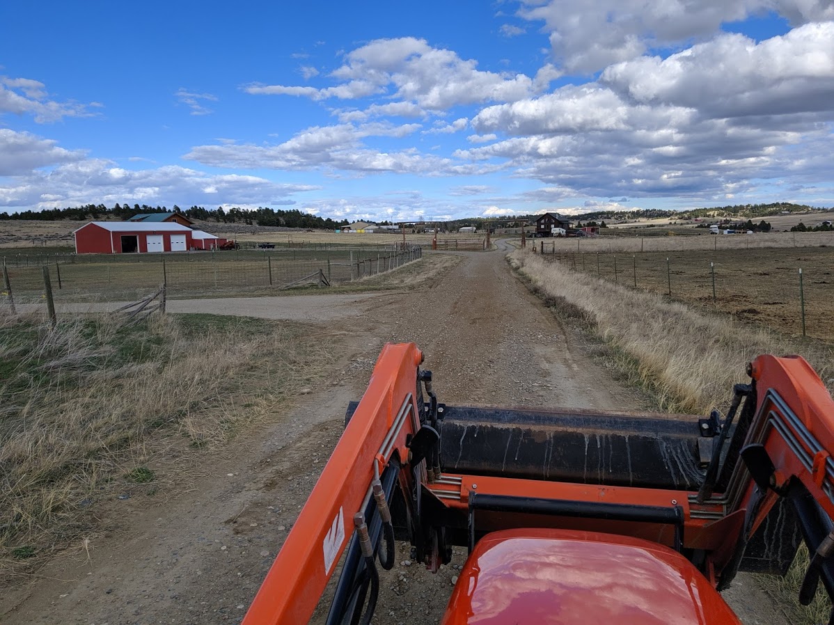

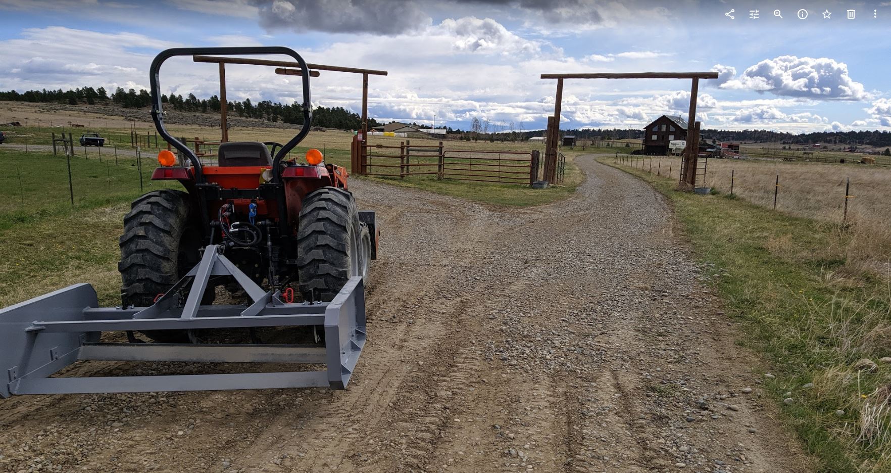

Great day to take the grader/scraper out for its maiden voyage, it just rained last night and dry enough so there is no mud.
Here's a couple of pics before work began
I have to say, this thing is amazing! What used to take me 6 or 8 passes with the 3 point back blade now only takes half that much and you can go quite a bit faster.
The scarifiers make all the difference in the world, they loosen up the packed down road bed so the blade can spread it out smooth. The single 3 point back blade had one hellof a hard time doing that and is why it would take so many passes to get the road smoothed out. I did in an hour what it would take me 3 hours before.
I am totally impressed with this implement and how effective it is in smoothing out my road, and it pulls nice and easy.

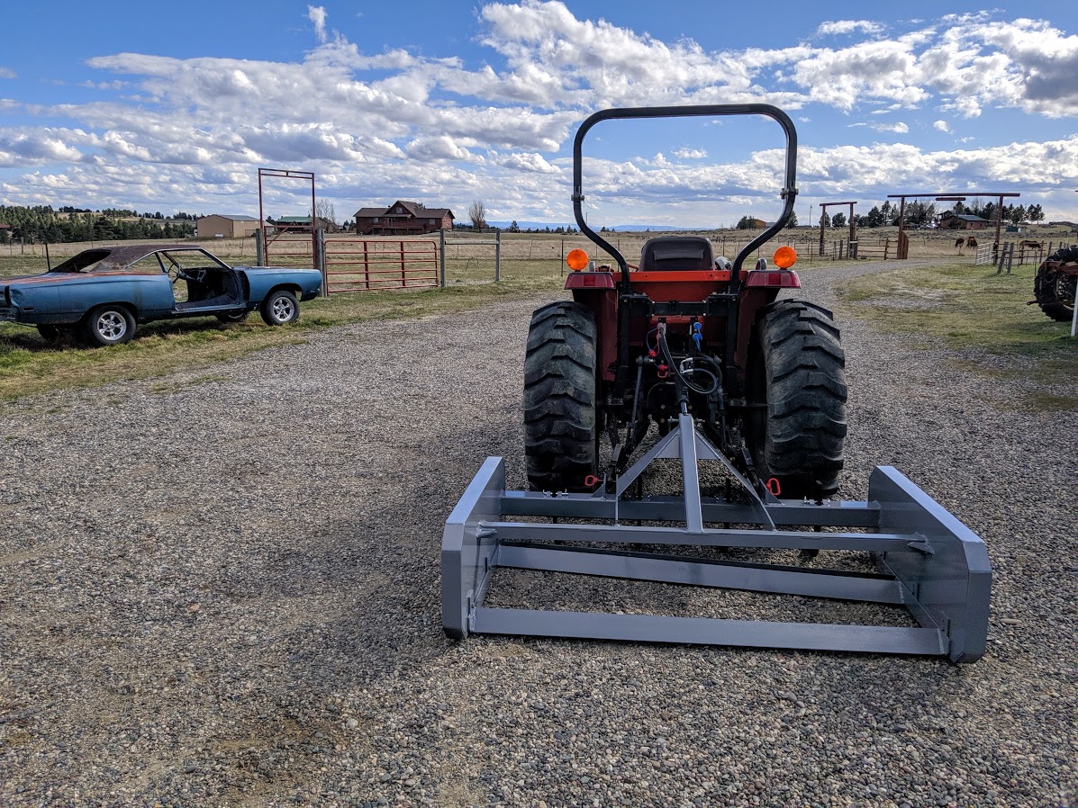

A couple of quick pics of my main driveway and about half of our shared road.
/ Grader/Scraper Build #107
Congratulations on a job well done :thumbsup:.
/ Grader/Scraper Build #109
Glad it works good for you.
I'm always nervously optimistic the first time I use an implement I built....
You definitely live in big sky country!!!
/ Grader/Scraper Build #110
Definitely a great build! Does a nice job.

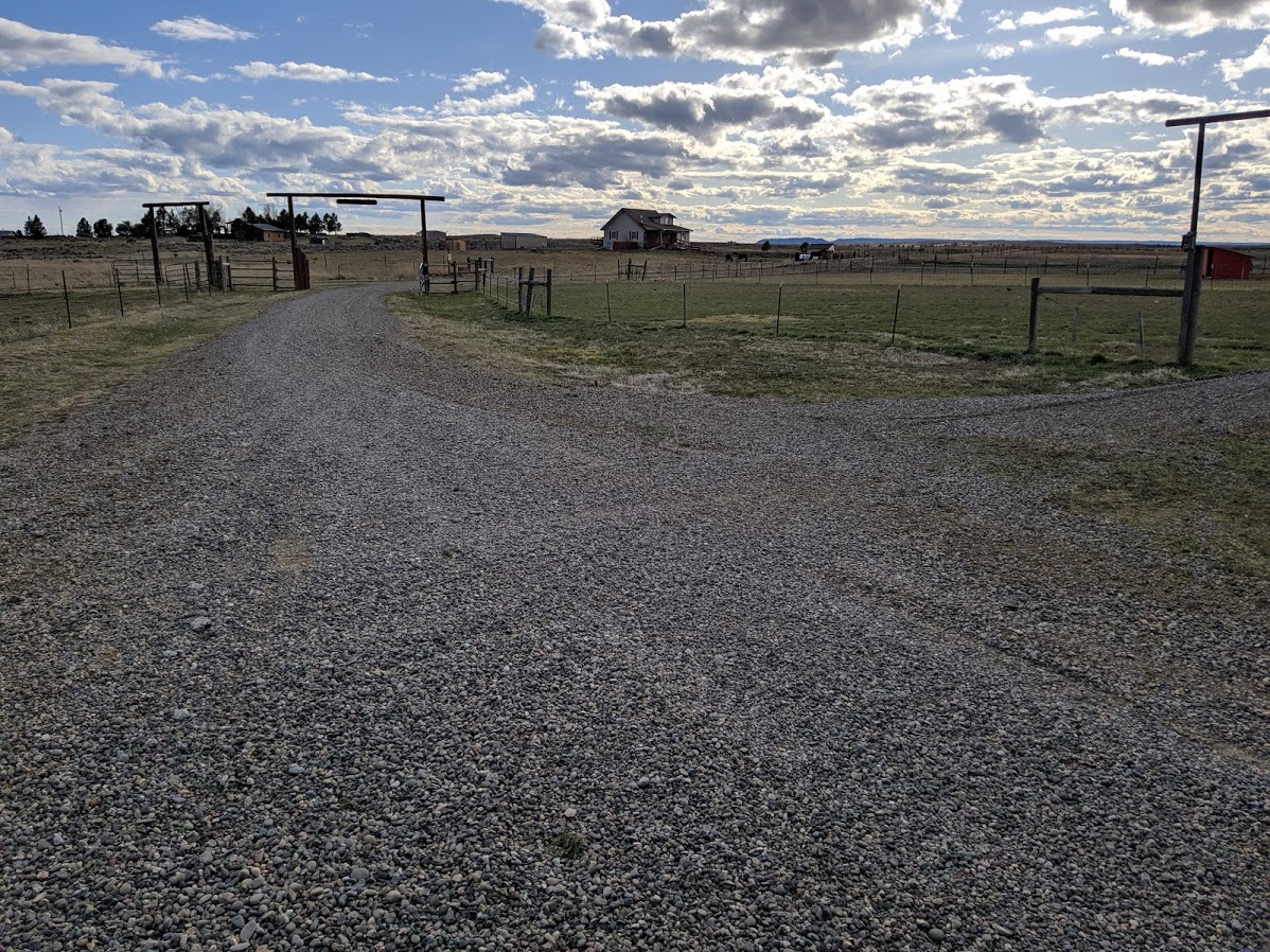

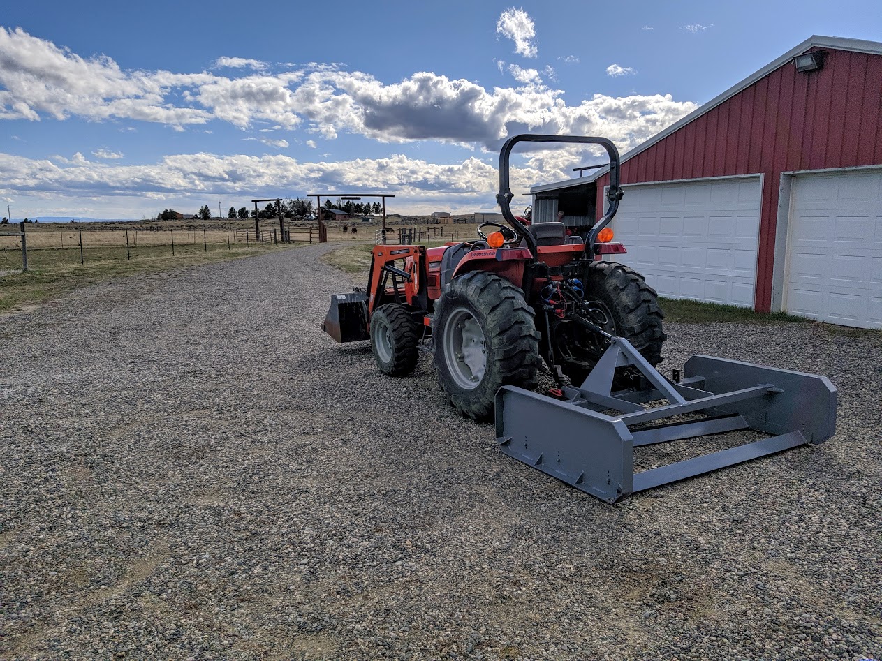

This thing is totally amazing.
This is the first time I really spent a few hours working with it, it rained good yesterday which made prime time grading/scraping conditions.
Then the dual dually garbage truck came, he is like a big steam roller - Perfect!
Wanted to share these pics, I really could not be happier with this tool.
/ Grader/Scraper Build #112
Great work on the land plane. Enjoyed following the build. One gets that warm fuzzy feeling when a project performs well.
/ Grader/Scraper Build #113
Enjoyed your sharing the build and the end results. Your driveway is like a parking lot compared to mine. Have seen better and longer last roadbed after years of use with a land plane. Hope you see the time and material savings over time as well.
/ Grader/Scraper Build #114
Very well done. Professional fab skills. Infact, probably better as most vompanies just can't put the labor into perfection as you did. Next you need to build a 3point roller for tightening the rock after your dress. I always though a large round drum approx. 6 or 7 feet filled with used motor oil.
