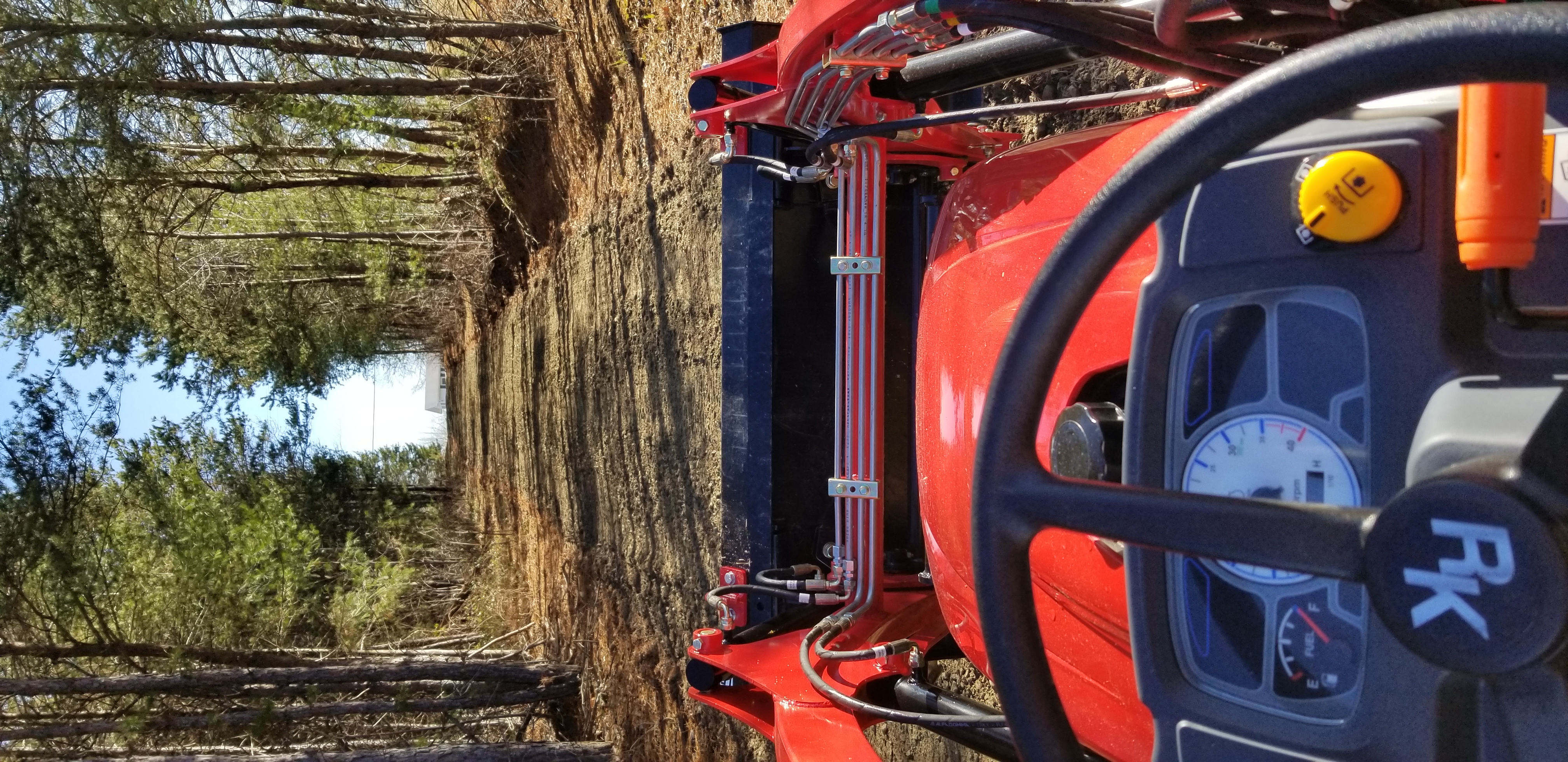

There isn't a lot of room to work with. Farmers can get pretty irate when you start affecting field drainage. Putting a ditch on the right side will become a trap for getting cars stuck in. Think swale with a large crown on the driveway. A rear blade is not going to give you enough weight to get through the tree roots. I would use the box blade, tilted slightly to the side with the 3pt adjustment. Do not be too aggressive , as after each pass the wheels going lower on one side will increase the angle. Don't drive over any exposed tree roots, they have a habit of coming up underneath the SCUTs and damaging things. Keep an ax handy to deal with them.
Do the same for the left side, always better to pull downhill. Remember you only want to engage the lowered part of the blade, not the entire width. Do not remove too much in each pass, 1/4-1/2 inch will maintain an even level. It will easily fill up the BB on a pass. Probably end up doing 10-20 passes. Use the spoil to create a berm along your property. It only has to be slightly higher than the roadway. Your driveway may require a small culvert, an 8" may do depending on water flow. Keep the entrance of the driveway higher than the roadway. I have no idea how much flow you have, so washouts on the roadway are a possibility. Your going to be sending a lot of water down the road, so be mindful of where it will and up.
A bigger tractor would make short work of it, but that's not the point, is it:)

I will take better pics. The feild is shedding water onto me. A ditch will not effect the feild drainage. It will take the water as it enters my property and will direct it around my house and down to the pond like it does now. I'm just want it to down beside my house as apposed to across the front lawn.
