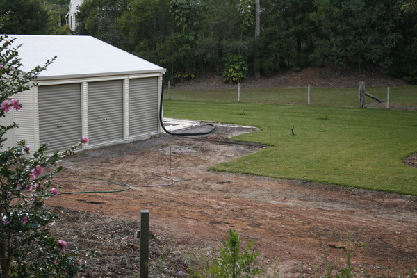

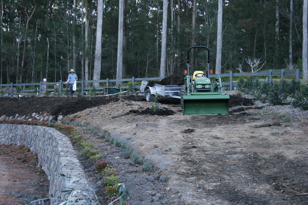

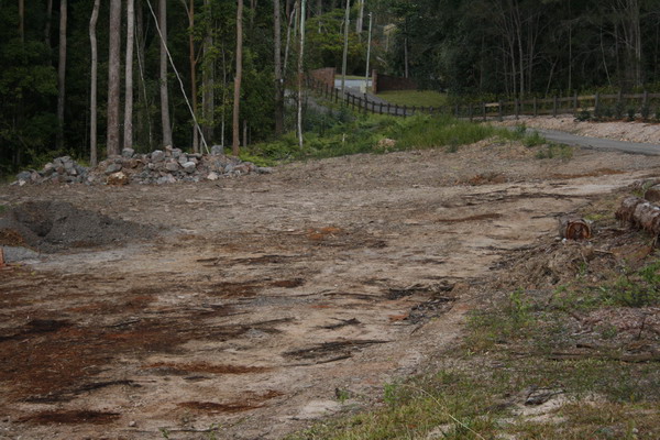

My primary purpose is I need something to help me prepare soil before laying turf. The areas to turf are mostly flat but need smoothing and in some places I will need to bring in and spread top soil. (see pics) The final surface should be smooth and a little compact before laying and rolling turf. Areas that are heavy clay would need to be scarified to help integrate the top soil with the heavy clay. (Which is why I lean to box blade)
My second purpose is to help dig for concreting a slab in front of a shed (see pic) and eventually remove existing asphalt driveway and replace with concrete. I need to remove clay and soil material evenly and without aerating subsoil too much. I have concluded that it is impossible to use loader blade for digging out even amounts of material.

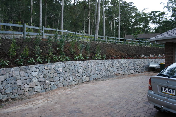

Thought I would throw a few extra piccies of the work I have been doing round the place (rock wall, mulching, garden beds). If anyone wants some of that nice mulch, I still have over 1000 cubic meters available!

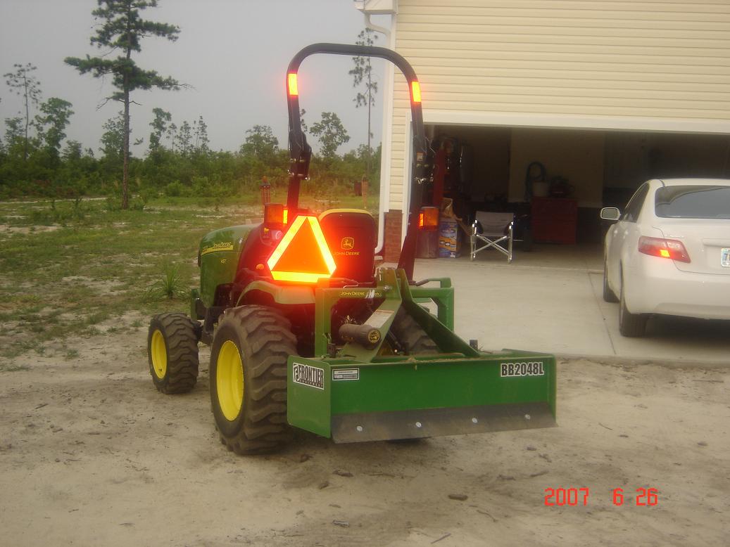

/ Grader or box blade. #3
I like mine, it works real well. I think it is a must have for the tractor.
Shot when new
Shot after a few uses.

I USE THE SAME BOX BLADE AS MAYOR HAS PICTURED ABOVE AND I TOO HAVE USED THIS MODEL ALOT!! I HAVE HAD EXPERIENCE WITH A BB'S BEFORE AND I HAVE TO SAY THE 2048L IS VERY WELL BUILT. ALTHOUGH I HAVE A FULL CATEGORY 1 HITCH I FEEL LIKE THE LOW PROFILE OR (L) MODELS ARE MORE DURABLE AND GIVE MORE GROUND CLEARANCE ON MY 2320!!! JUST MY OPINION.;)

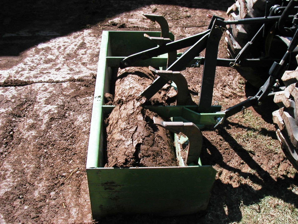

box works great for removing sod
