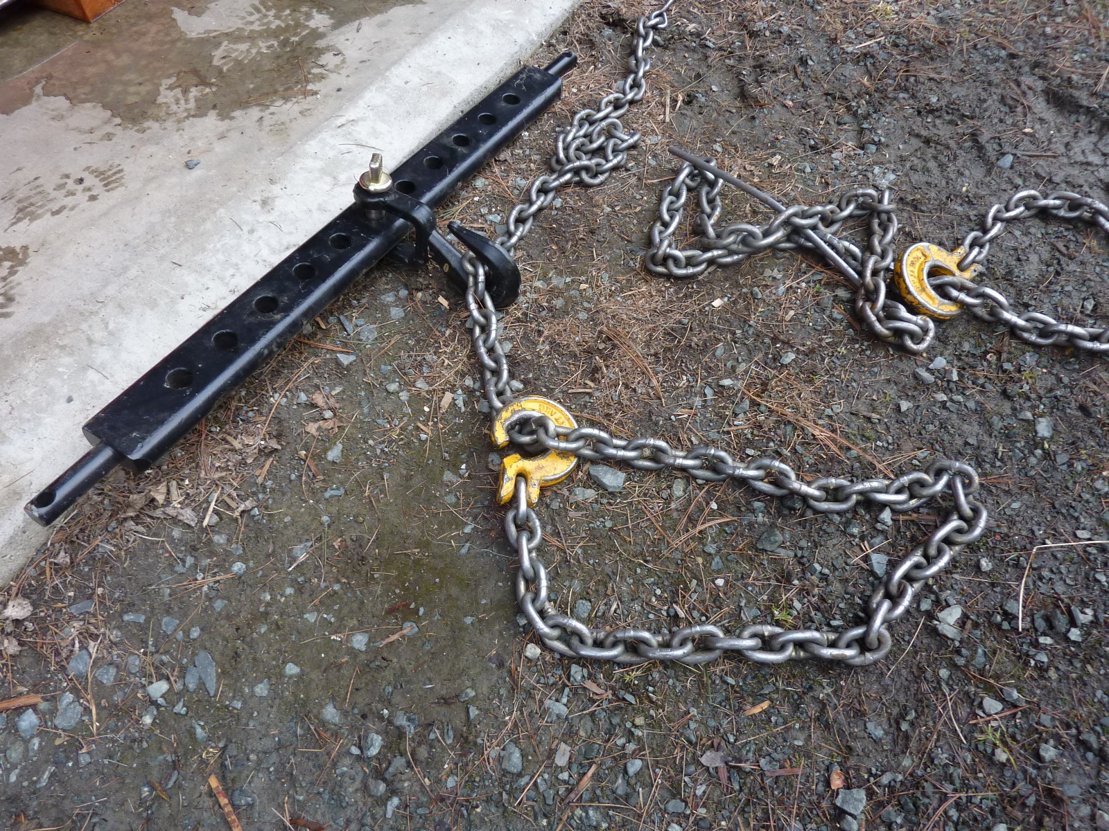

Gordon, where did you get the choker hook...that looks like a nice design I've not seen before.

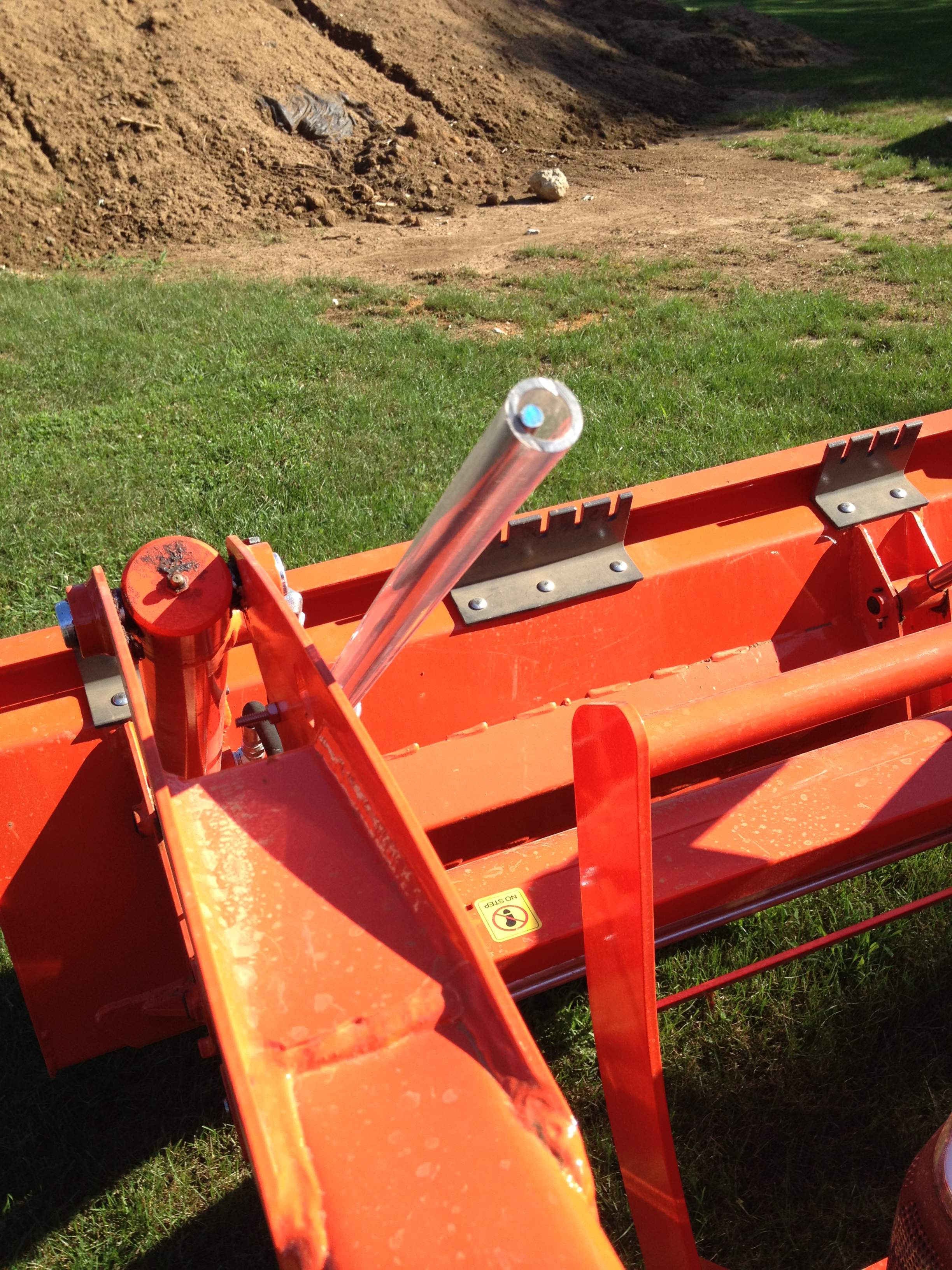

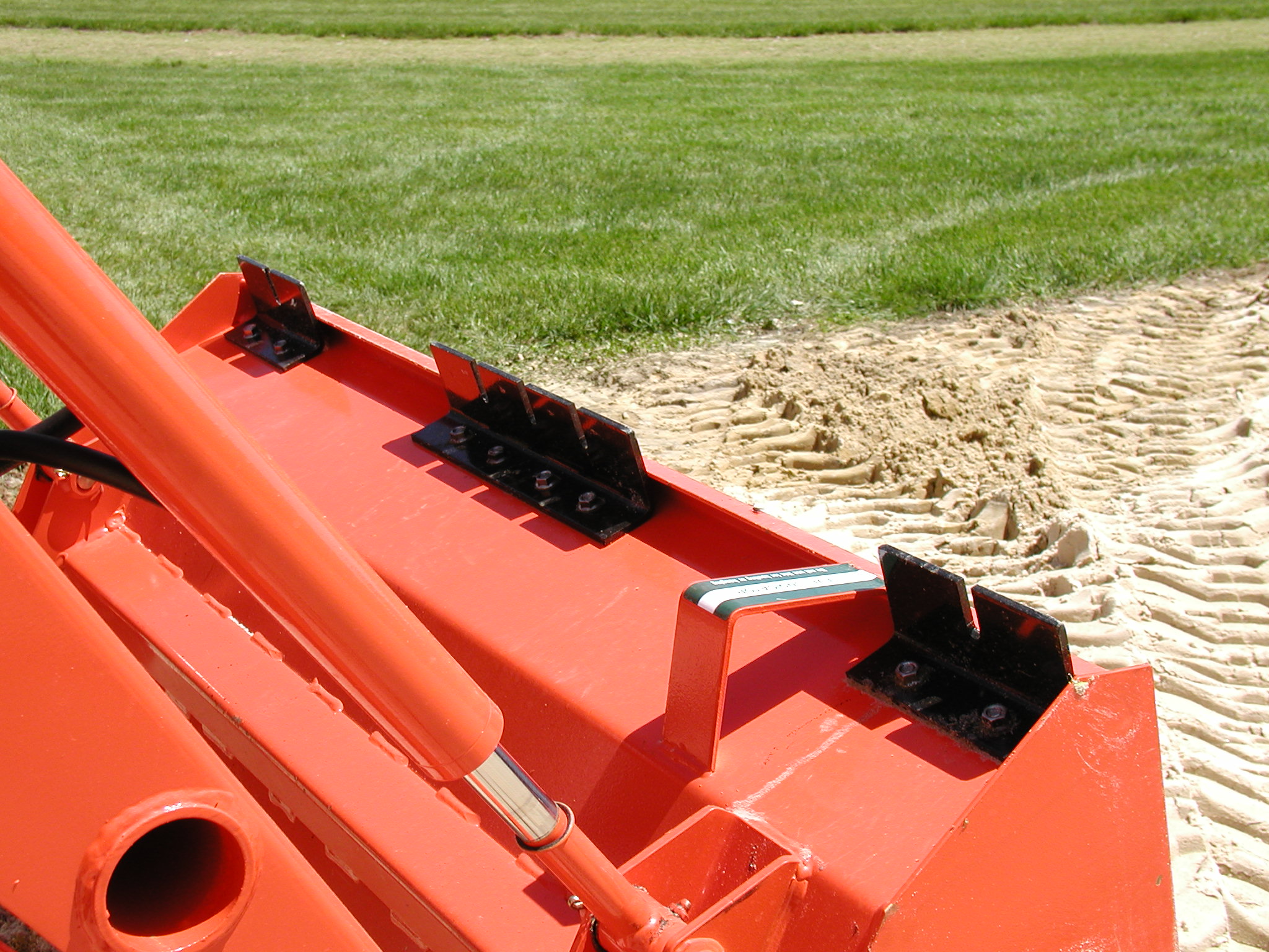

3 hooks on the FEL, 2 in line with the lift arms and 1 centered, on the back, has worked well for me:
