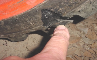

Jerry, many if not all auto-glass repair shops use a black sealant to set new windshields in place. This sealant I think may be polyurethane based, and it remains flexible forever. The sealant also sticks to everything, including glass, rubber, plastic and metal. If you've ever changed a windshield, you'll know how durable and tough to remove it can be. Unlike rubber cement, it does not remain sticky or roll when rubbed. If you really want to try to fill in the gouge, I suggest you clean it up, deflate the tire so the sidewall will be more flexible, and take it in and see if they can fill it. The gun they usually use to apply the sealant has a very small, pointed nozzle so they should be able to get the sealant into the cracks reasonbly well. After its filled, it would be best to inflate the tire before cleanup. The sidewall may swell a little so you don't want to clean it all up and then find you've got a bit of the gouge left. Clean the area up when done so there's no sealant edges sticking out and I think you'll be reasonably pleased with how well the majority of the gouge is filled. I think cleanup is just with point thinner, but it might be something stronger like lacquer thinner - they'll know.

Sorry to hear about you getting gouged. Here is a pic of my "hangnail" in the sidewall. Could see the cord but none broken. Got a tube of "crazy glue" cleand the wound and applied generous amount and pressed into place with blunt screw driver. Can hardly find the place now. I'm with the other who say if cord is NOT broken then run with it.

   / Gouged My Tire ! #30
Picture did not go with text. Try again.
