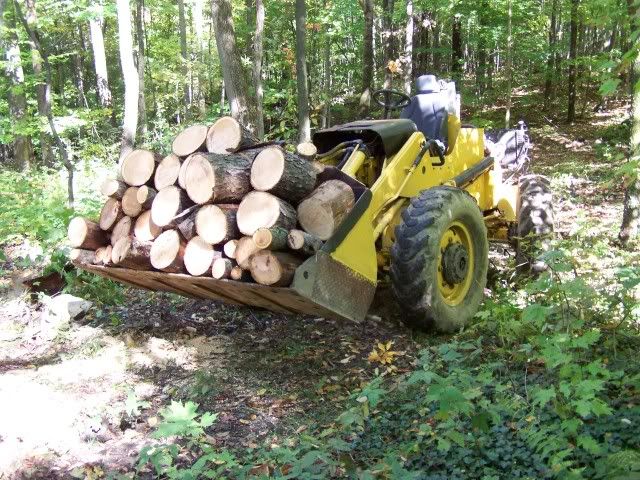

Wood and leaf basket, manual dump. Handy in the fall and winter.

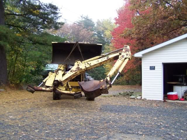

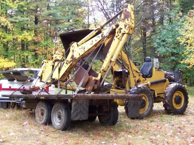

I know its not a "tractor" but its one i'm kinda proud of. Its a 1964 case w7 loader with an AC industrial 60 hoe. I rescued it from junk for 800 dollars in real bad shape.
here it is under restoration. I repowered it with a ford 302 run into a ford aod auto trans and a ford np 208 t-case from an f250. I clocked the case and built driveshafts and a pinion brake.
The new driveline was intended for front engine applications so I did a differential flip to make it go foreward when in drive. The steering diff stayed in the rear, it was just fliped and new steering made.
The pump was mounted to the crank via a homemade shaft that was part toyota truck and part old case pump adapters.
In working condition. I've used the crap out of it and it works great

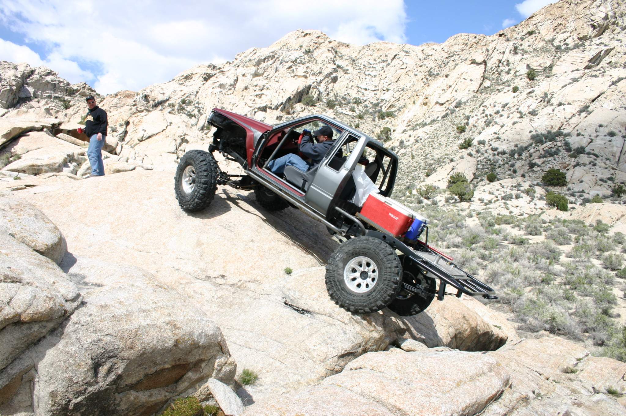

I also tinker with 4wd's. I've built many off road rigs but i wont bore you with all them. This is the current project.

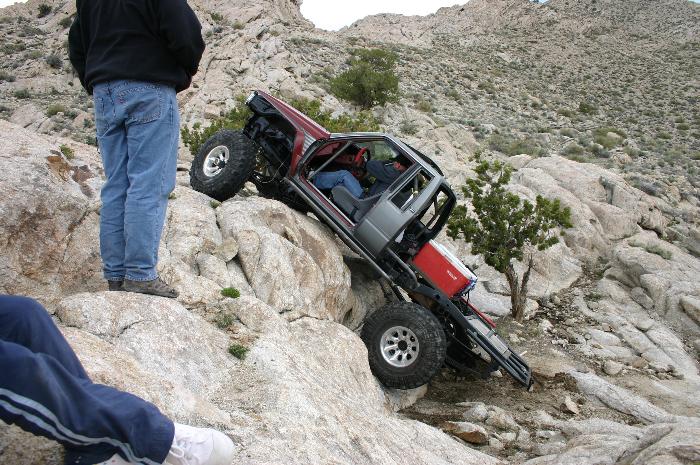

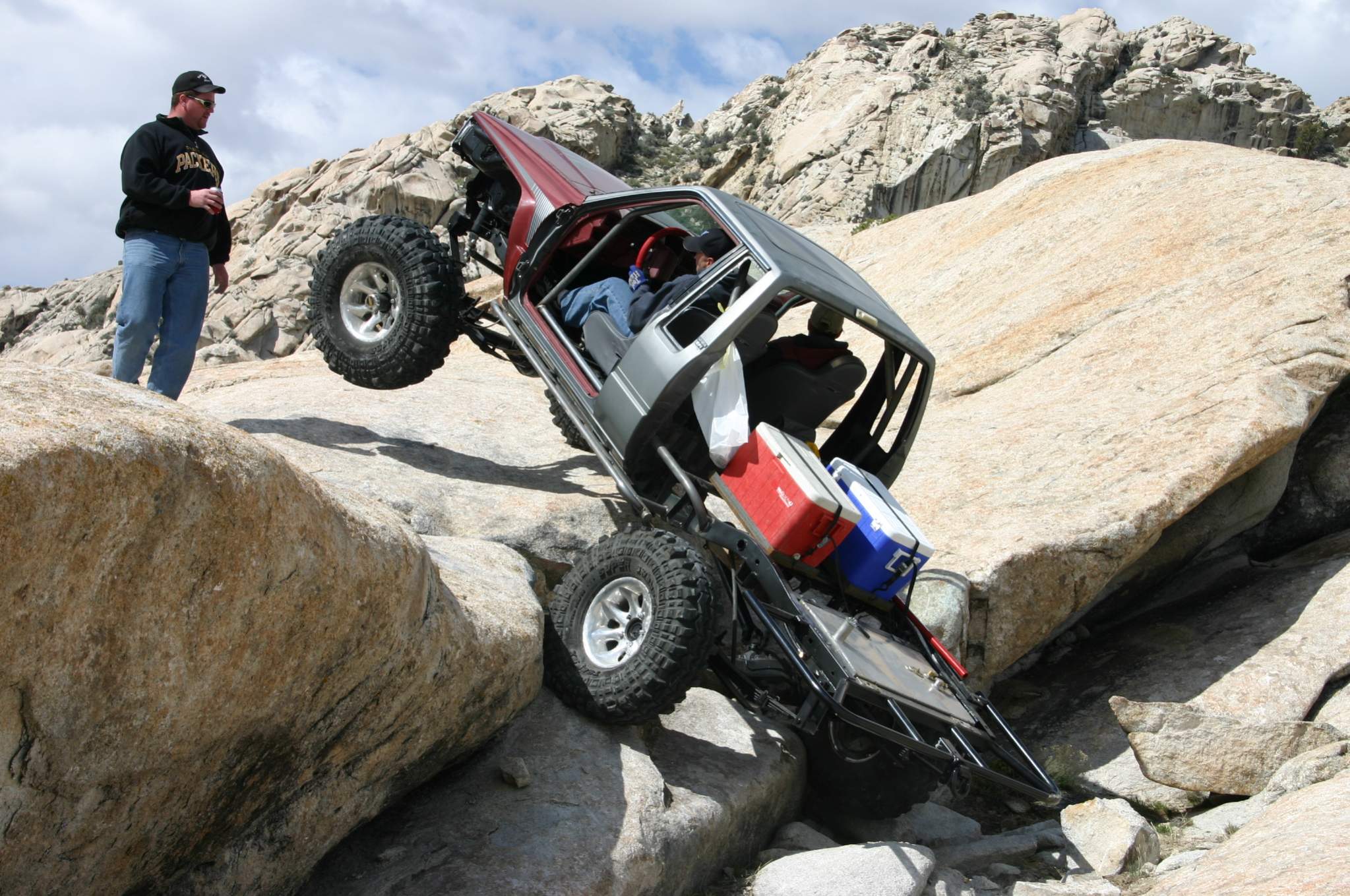

the chassis is a blackout autosports. His design and he bent it for less than I could even buy the tube for. I did the 4 link mounts and 4 link design. the rear is equal length double triangulated with 20* seperation top and bottom. the front is parallel 4 link with bushings on the axle end and a panhard bar. I went with that in the front to deal with the higher speed stuff and jumping. its not going to travel like the best of them but it should be better at speed.
This is the rear steering rockwell top mount. I did the center flip on this axle to center the driveshaft and did the rebuild.
Rear axle has no suspension steer throughout its entire travel.
I'm using single rams but i plumbed them in parallel so its a balanced system like the double rams. it will work like a 4 wheel steer tractor though until you pull a valve to seperate the front and rear. This is probably common knowledge to the average farmer but is pretty innovative in the 4wd world as the common set up is a balanced ram with the front and rear working independently all the time. I think its a good set up for most of the east coast wheeling and will work great on tight trails at higher speeds.

Very Cool ! I got to hand it to you on repowering that loader and then adding the hoe, Nice job !
/ Got welder?
thanks kevin, I really like that machine too. It was a fun project, taking a worthless hulk of old iron and making it into a workable and easily repairable piece of equipment again. it turned out better than i expected, in low range it has more power than it would ever need. in high range it will go faster than you want to and will push snow real well in high range too. the hoe works great, i put an electronic fast idle on it and it runs the hoe amazingly well at about 1200 rpm. Makes for some good fuel economy when using the hoe. It drinks the fuel moving snow though.

I love wheel loaders, always have. I was looking at purchasing one long before I bought my first tractor. I have no practical use for one but my entire adult life I have wanted one for nothing else but to "play" with and have around for the odd task. I've looked at more than a few W14's and never could justify something that size. I've seen several of those old W7 loaders and never felt any affection for them at all...suddenly I have to have one. How does that work? ;) Excellent job on everything!
/ Got welder?
#17

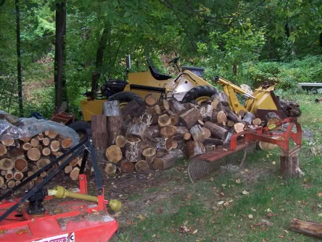

Thanks for all the comments. The w7 is sized about right for me, its not to big but its big enough to "play" with. It will clear land, it pushed that stump in the picture above right out of the ground and the hoe does real well on it. The steering's pretty scary with any amount of speed, I'll eventually change it over to a full hydro steer. Its handy though, I've done alot of digging with it, used it as scaffolding to hang OSB and for moving building supplies, even made an attachment for the loader to set my trusses. Works good for gathering firewood too. It doesnt have differential locks but still does well in the woods. The axles look like rockwell 106's with planetaries so I think you can get lockers for it. I cant confirm that though.
I kinda enjoy cutting and gathering wood.
I dont know what I'd do without it to tell the truth, the hydraulic power is impressive for the size. I can lift and move anything I can haul home.
This summer its going to clear another 10 or so acres of field/pasture at my dads. I need to build some ROP before we start removing that many trees.

can you post some closer pics of your wood basket? just curious.
