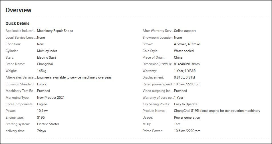

   / Got to use my DIY diesel generator, #20
Here is suitable engine, but you better bolt it down to a concrete base and build a shed around it!
