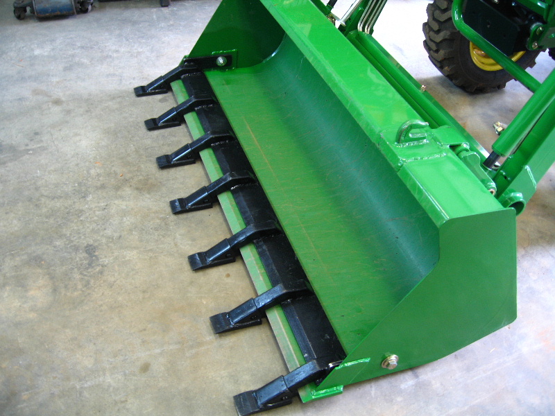

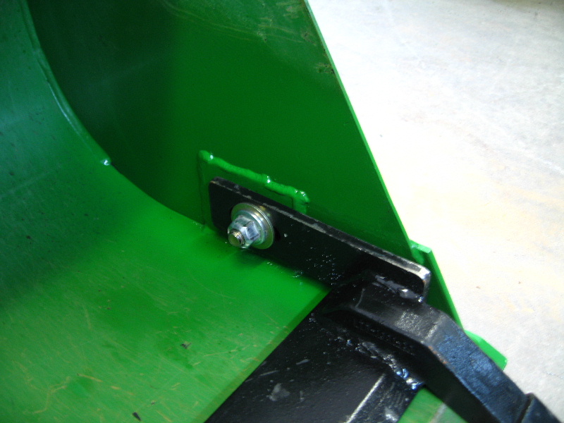

Finally got time to mount the new Markham tooth bar. had them make it a little narrower than normal. i wanted to weld the gusset plates to the inside. 1/4 inch plates worked perfect. :) I thought the 1/2 inch plates thay sent was a little over kill. i wanted a clean look on the outside of the bucket. I did not use the bolts that came with it. i used the large grade 8 bolts from the big JD tooth bar. i have not even put it in the dirt yet. and i know i am going to like it much better. i got where it just slips off with ease. i had to pry the JD bar off and beat it on with a hammer. and it weighed a ton. way over kill. this one is heavy. but not to heavy to carry around. it looks well made. The JD bar only had 6 teeth. this one has 7 teeth. thay are a plesure to work with.
I think i am going to like it. here is a few pics.....;)
Chris....:)

Yes i just got it..:) and yes i got another one made by JD it is to heavy. its to heavy for a 3000 seris. and it has 6 teeth. this one i have now has 7 and is easier to work with. i think i will like it better. the JD bar has teeth the size of a 963 Cat. way over built for compact tractors of any size...;)

Chris, that new toothbar really looks good on there, and you did a great job with the install as usual. It looks much better matched to the loader than the JD one did.

I agree , its a much better fit than the JD bar was. it looks like it should be on a compact tractor , and not a bulldozer...;)

Was that original a standard toothbar that JD makes specifically for your bucket... or just one the JD dealer came up with that happened to fit? :confused: Maybe a JD skidsteer toothbar???

I agree. Excellent installation job. Did you pay extra for an additional tooth? Or are 7 teeth standard in your size? :cool:

Dougster , it is a JD toothbar for a 61 inch bucket. thay also make a 73. I do feel there for a skid steer. the bar is way over built. its more than you need on a 4000 seris compact tractor.
as for the markham. yes i paid 26$ more for the extra tooth. it puts the teeth closer together. i think it will help digging in hard ground. also the teeth are alot sharper. the JD teeth are very blunt. i feel it was made for something with alot more power than even a 40 Hp tractor...;)

Gord you must not do much welding.....:)
I have painted it twice. once when i welded the hooks on.
and i had to repaint the sides , after i welded the gussets on
for the tooth bar. in order to weld something you haft to grind the paint off
to the bear metal. and the back side gets burned. so you haft to repaint.
i also keep my crap clean. if it gets dirty , it gets washed. i am trying to take care of it. this mess cost as much as a new car. you would not
leave dirt on a new car , would you...:D so i am doing my best to take care of it . i know its a tractor and gets scratched up. but soap and water is cheep...;) but your right. i have used the hoe about as much as the loader.
