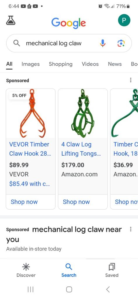

Couple thoughts or observations; #1; are you allowed to work in the abandoned ROW? Rail roads typically take their property rights Very seriously. #2; assuming you want/get/take the job, I would try to winch individual pieces out, until the jab breaks up. I do think the crane would be the first choice, but I would worry about access. Maybe a Lull extendable off road forklift? Maybe with a claw on a chain, similar to what you use to move jersey barrier with a front-end loader?

Couple thoughts or observations; #1; are you allowed to work in the abandoned ROW? Rail roads typically take their property rights Very seriously. #2; assuming you want/get/take the job, I would try to winch individual pieces out, until the jab breaks up. I do think the crane would be the first choice, but I would worry about access. Maybe a Lull extendable off road forklift? Maybe with a claw on a chain, similar to what you use to move jersey barrier with a front-end loader?View attachment 848281
