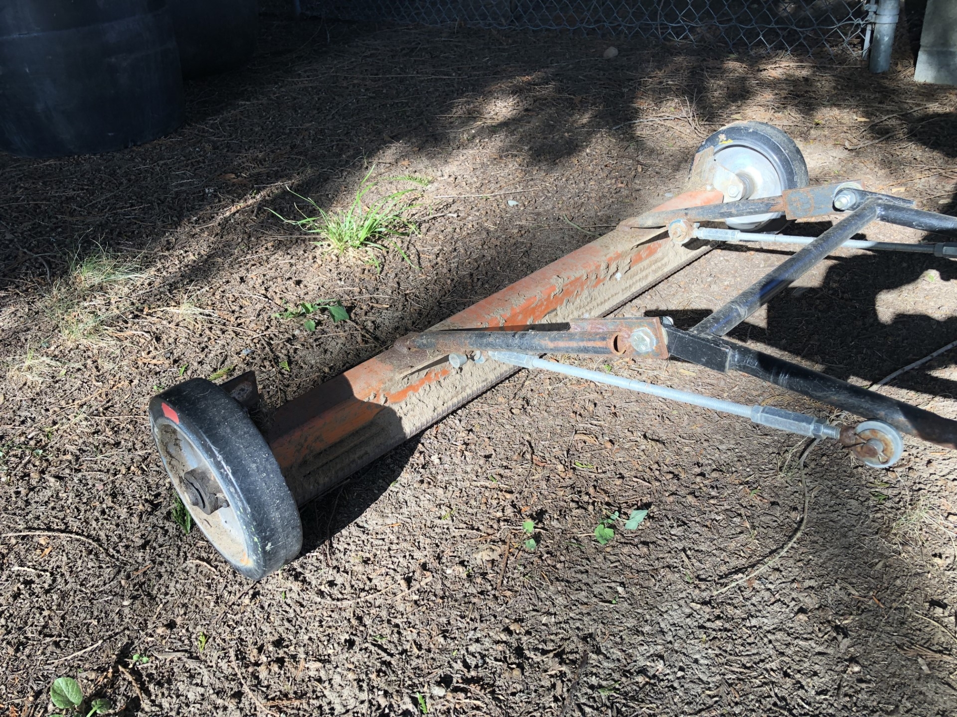

/ Gopher mount leveling. #24
I pull this behind my rider before I mow to knock down all of the mole hills. The cutting edge is just slightly above the wheel contact diameter so it spreads the dirt and rocks out over a small area without tearing up the grass and I rarely catch anything with the mower blades. I built it out of stuff laying around the shop, about 42" wide, the cross tube is filled with steel rems so it's heavy and the cutting edge is welded up from rebar.
I tried a trailing front mount at first so I could do it all in one shot but the geometry was tough and it wanted to dig in and drop anchor, not fun!
