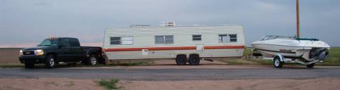

MrJimi said:
Thanks Paul, I wonder how many people will put a hitch in the 2" receiver to pull another trailer behind it ? see picture
Jim

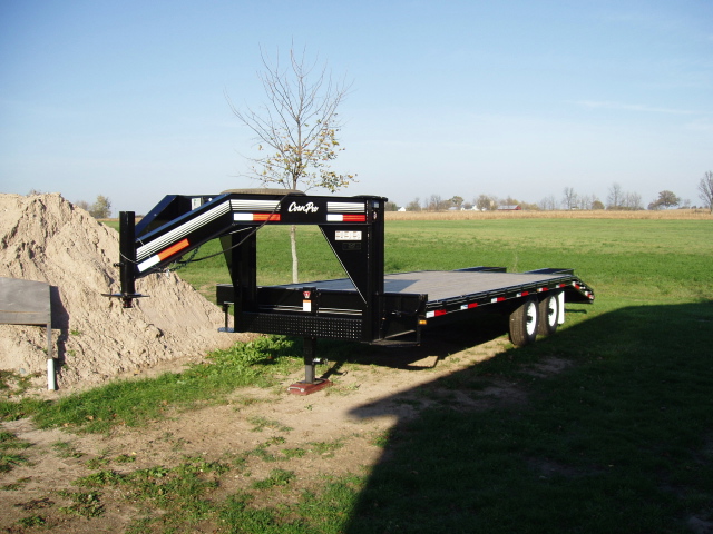

Jimi, Paul- That picture looks like what CornPro calls the Center Lift dovetail.
I think the crank jack is only an option on the adjustable dovetail, where the entire full width tail goes up and down. Also they call it adjustable but then say it is 2-position, so I guess it can only be flat or one angle and the jack is to allow you to change from one to the other??
Looks like a ball hitch also near the receiver, but it's hard to tell in the photo. I guess the full-width adjustable would have the receiver option as well but they don't show a rear view. The center-lift looks like a good option if you wanted to be able to have a perfectly flat deck with the tail raised level and no ramps standing up in the back so as to be able to load overhanging material.

Here in Indiana we double pull all the time. I tow my big boat, 15,600# empty and my jet ski, about 1,200# all the time to Tennessee. My neighbor does just as the guy in the pic with a camper and a bass boat and the guy down the road takes his camper and a tandem axle car hauler with quads and golf carts on it. In Indiana you do not need a CDL until you are over 26,000#. Does this mean every one should do it, no. But some of us with some smarts and the truck to pull it safely and good trailers with breaks and lights that are operational can do it just fine. I will say you must plan your stops for food and fuel a little more wisely.

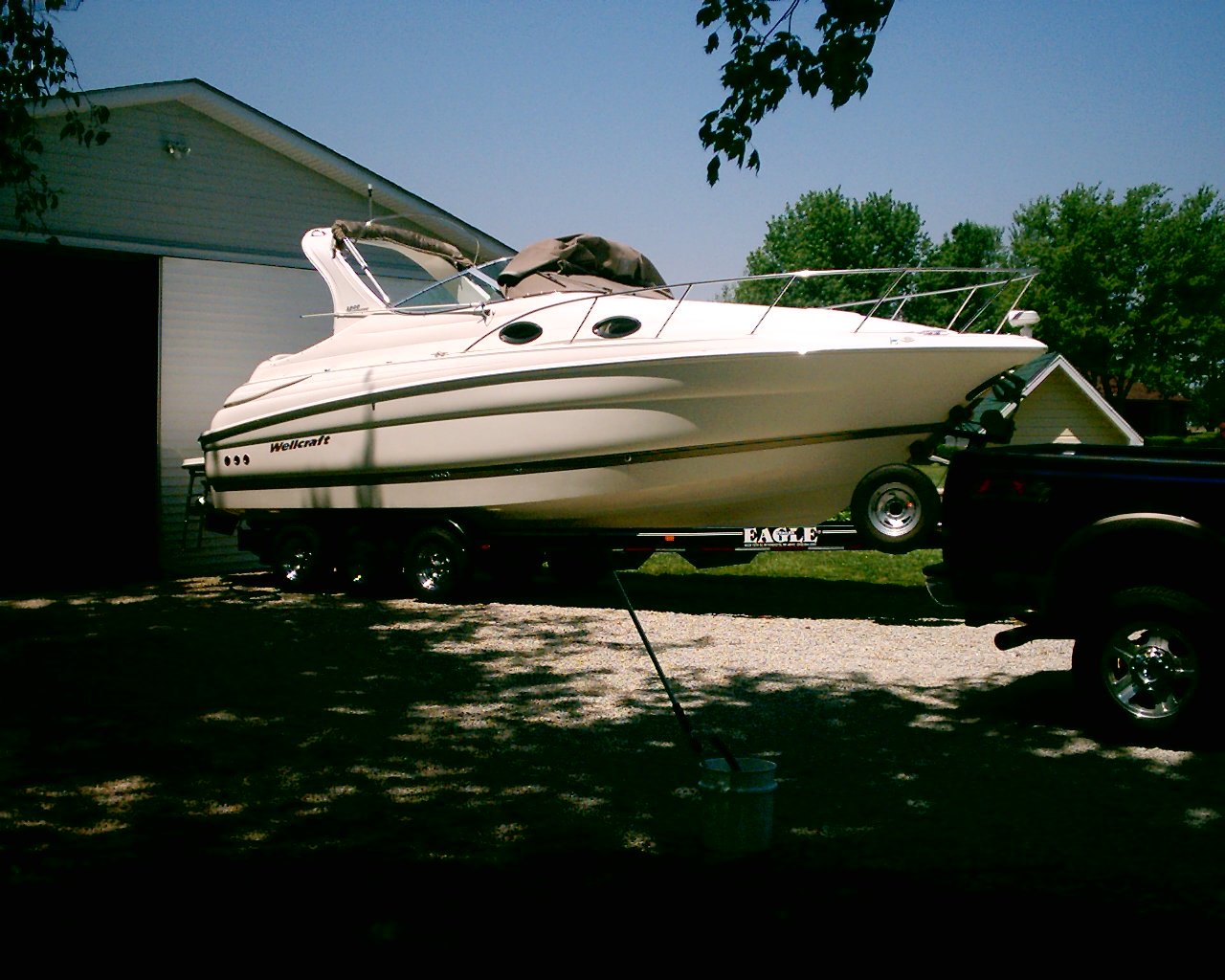

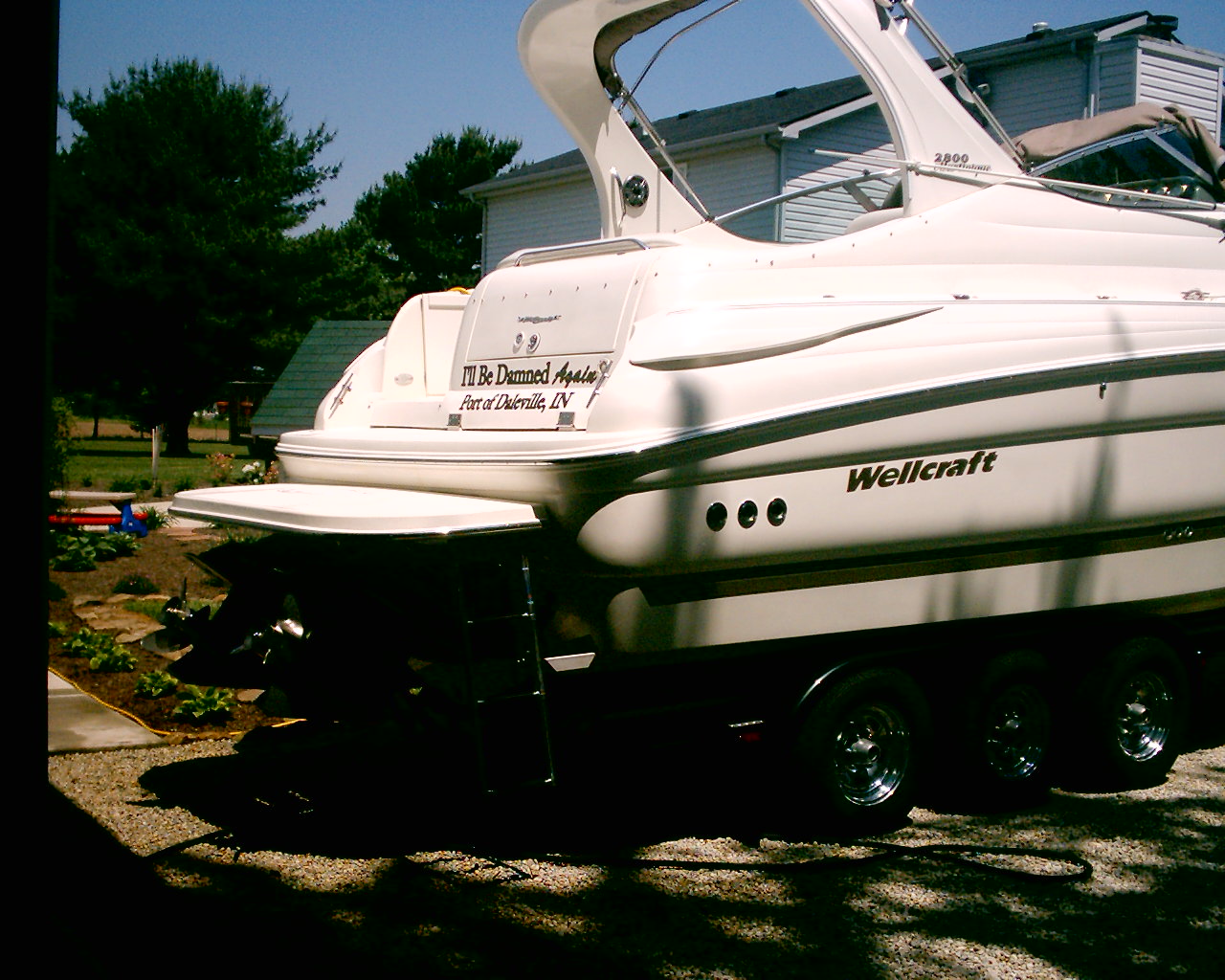

I checked with the dmv when I started doing double pulls and they said for a private party the 5th wheel/goose neck law did not apply. They said that the only rule that applied was the 65' total length, 26,000#, and the brake rule on anything over 3,000# rules. Of course the truck, hitch, lights, and all safety gear has to be up to the job.
As far a putting the jetski behind my boat I made a custom hitch for the boat trailer. It is a clamp on design made out of 1/2" plate steel that sandwiches the back of the boat trailer with 2 plates and 4 grade 5 1/2" bolts so there was no welding. It has a standard 2" receiver tube and I made a custom 5' long draw bar that utilizes 1/4" cable and turnbuckles going up to the boats transom tie down rings to relive some of the pressure. I also made up some 6' long safety chains out of 1/4" cable to run from the jetski trailer to the boat trailer. It has been towed this way about 4,000 miles with no issues. I don't have a pic but here is a pic's of the boat to give you some idea. You can also see the tail end of my 2006 f-350 6.0L diesel 4x4.
Chris

The final order was 22' + 5' with the adjustable (two position) dovetail, chain box cover, dovetail jack, stand up ramp option, and second drop leg jack. I did not order the two speed jacks because it was an expensive option and I don't drop and hook this thing 5 times a day. They are a drop leg so they crank pretty quick if you only need to raise the trailer less than a foot or so.
