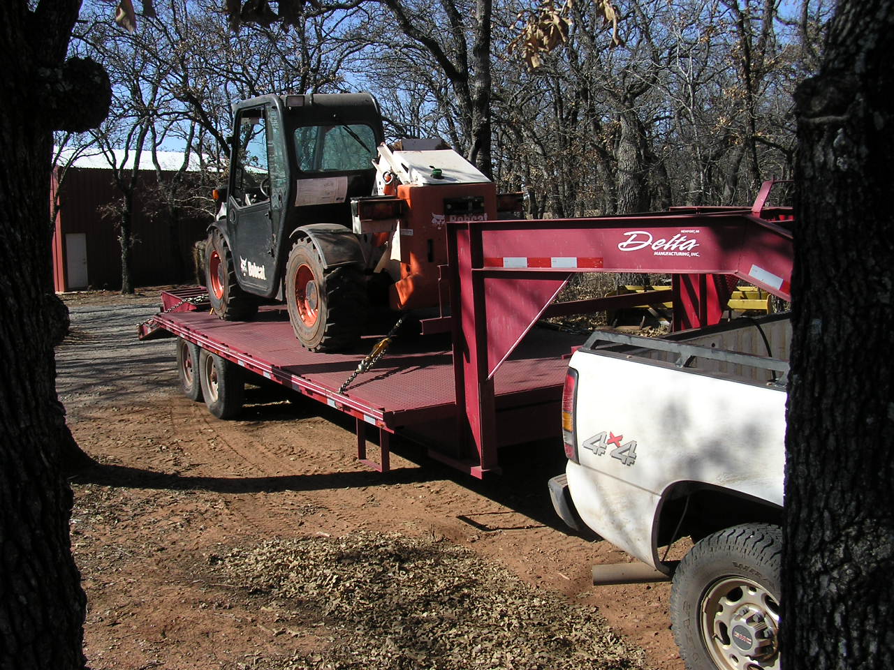

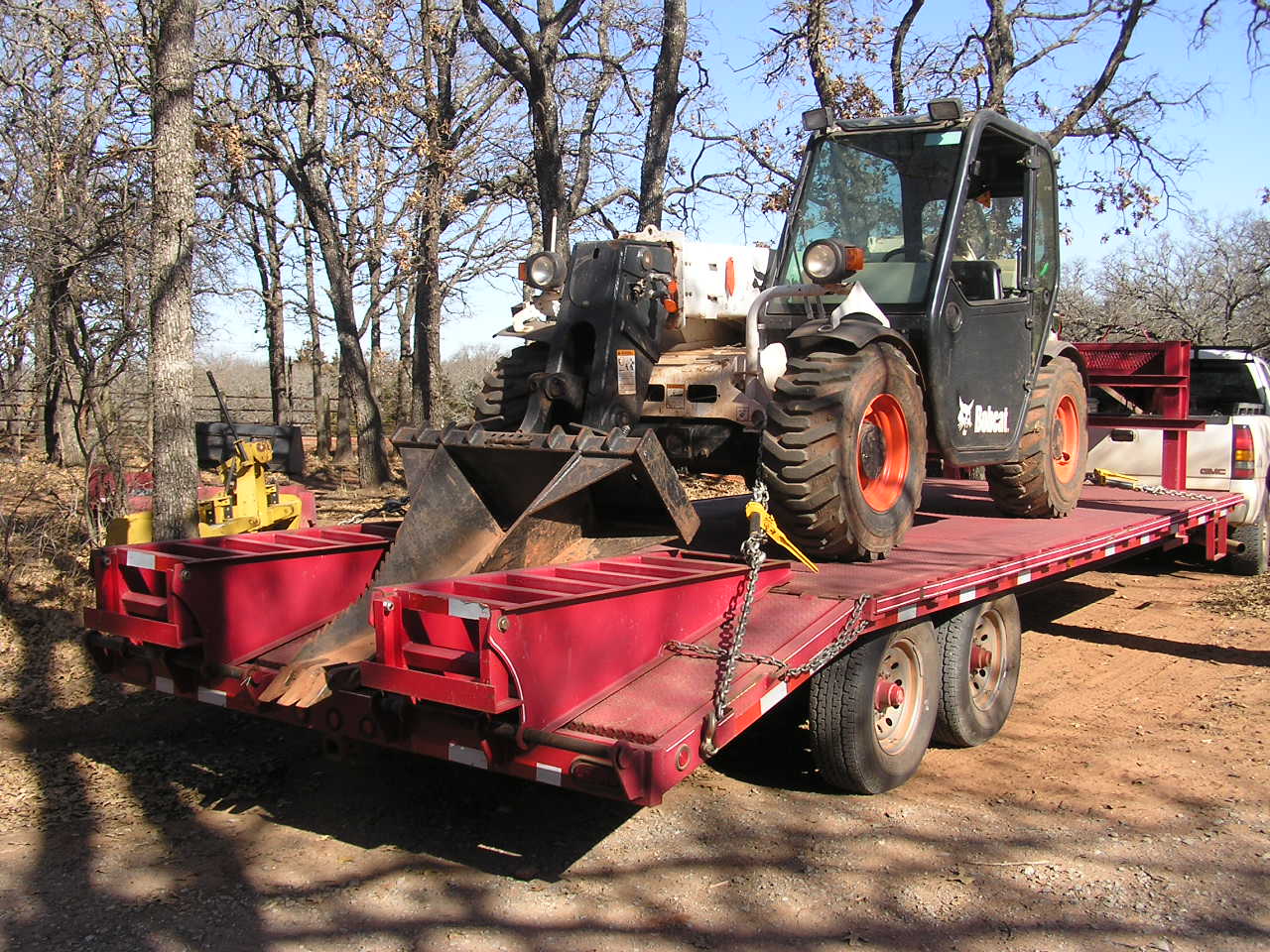

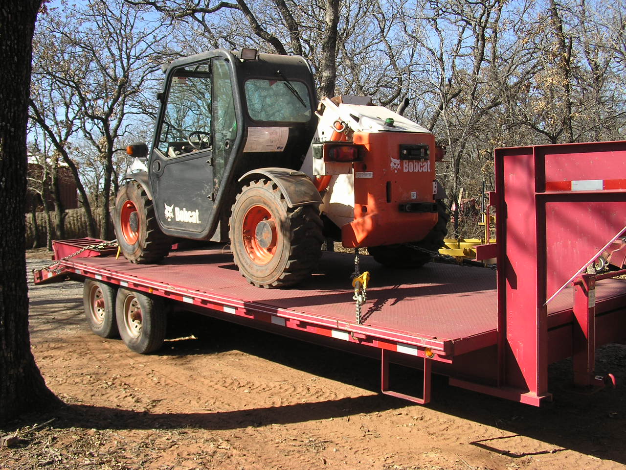

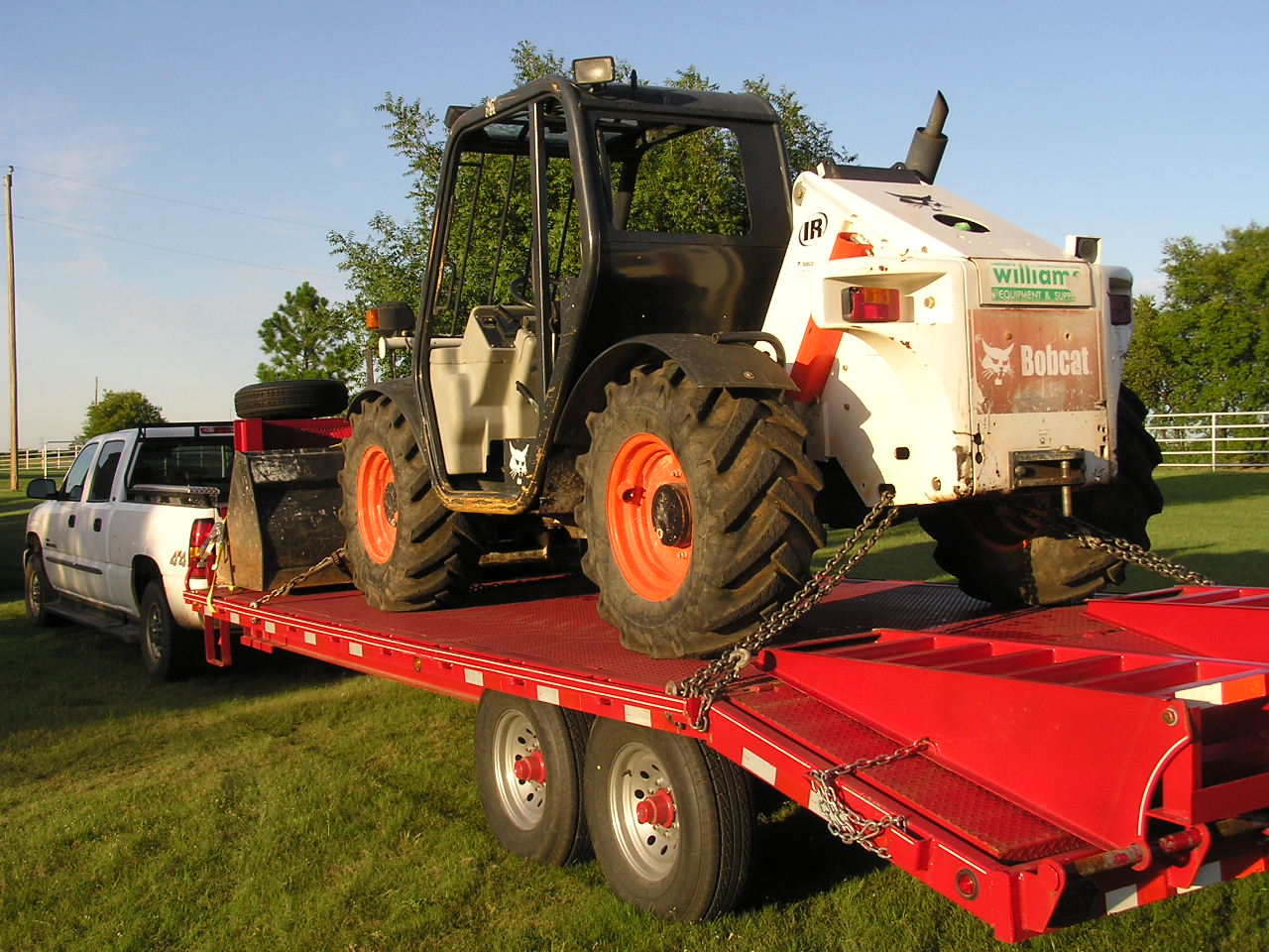

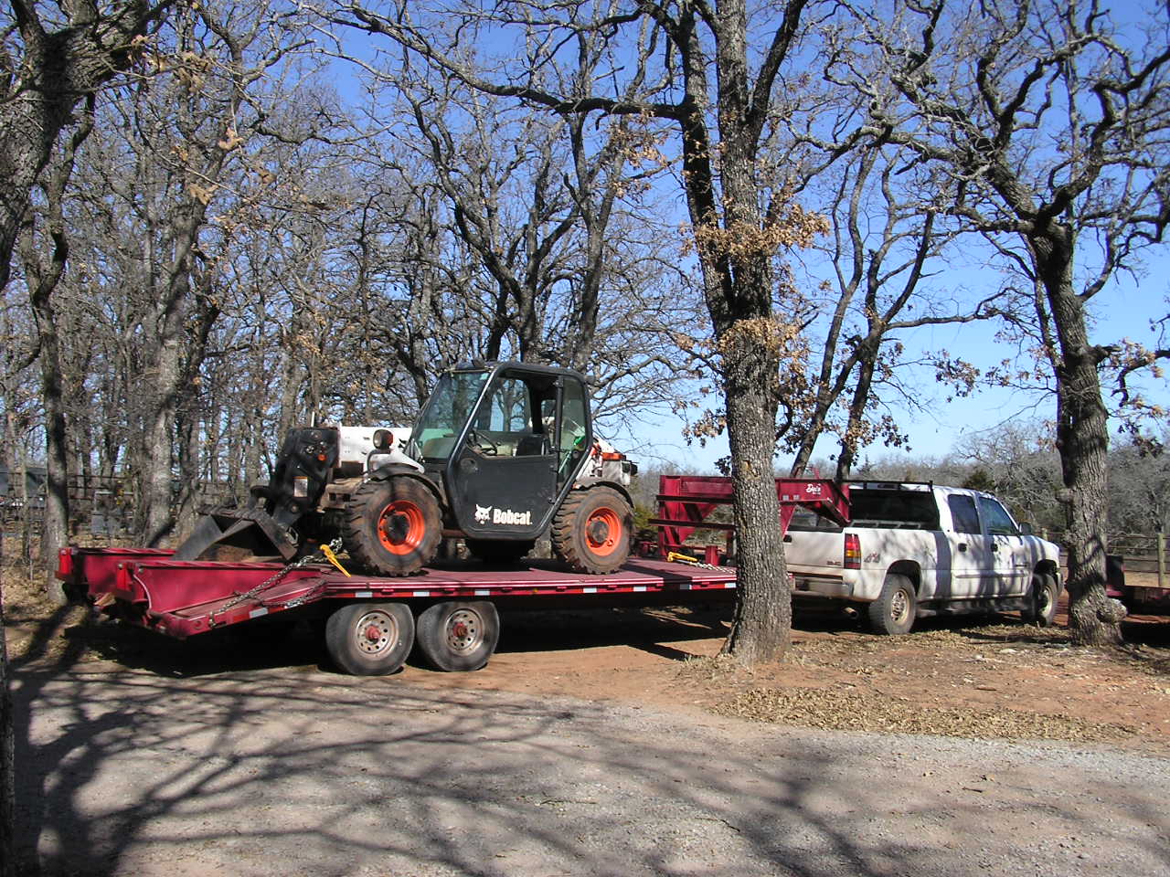

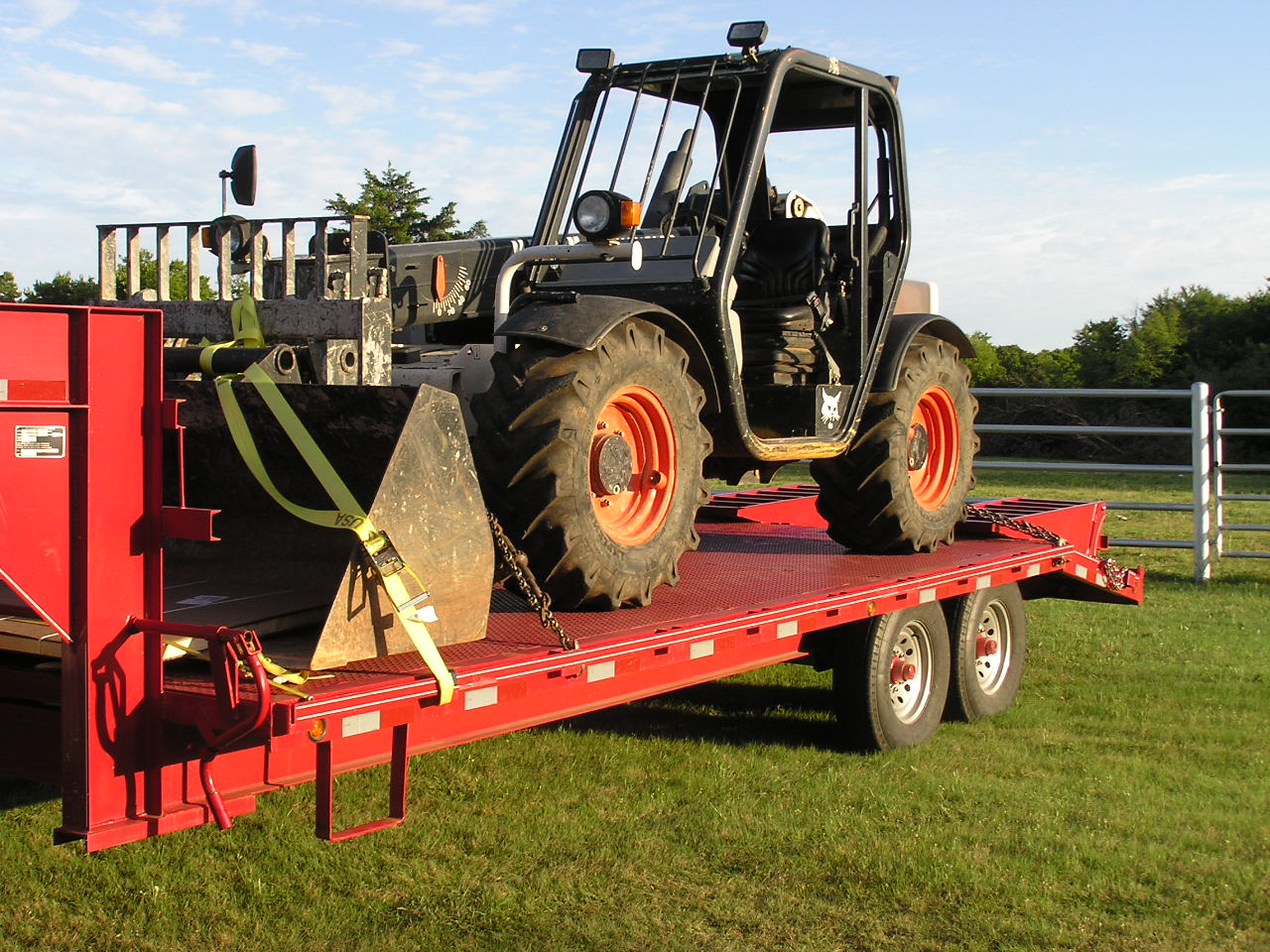

8K axles were optional ten years ago on my trailer, still available now: Equipment trailers from Delta Single Wheel Flatbeds
Probably should have ordered it with them. :(
Heaviest load that I weighed was 12,640, on the deck. 3440 on the gooseneck ball, 14,200 axles, 24,940 GCVW, 3/4 ton GMC.
From Sept. 2009.
   / Gooseneck Trailer for m7040 #56
That's a good load. How far did you carry it?
Hauled it home from Arkansas, about 430 miles.
The V417 that I have now is smaller and a little lighter, the same scales showed 12,660 on axles, 2,300 pounds on the ball. With the steel deck, the trailer weighs 5K.
I haul it backwards to protect the windshield.
