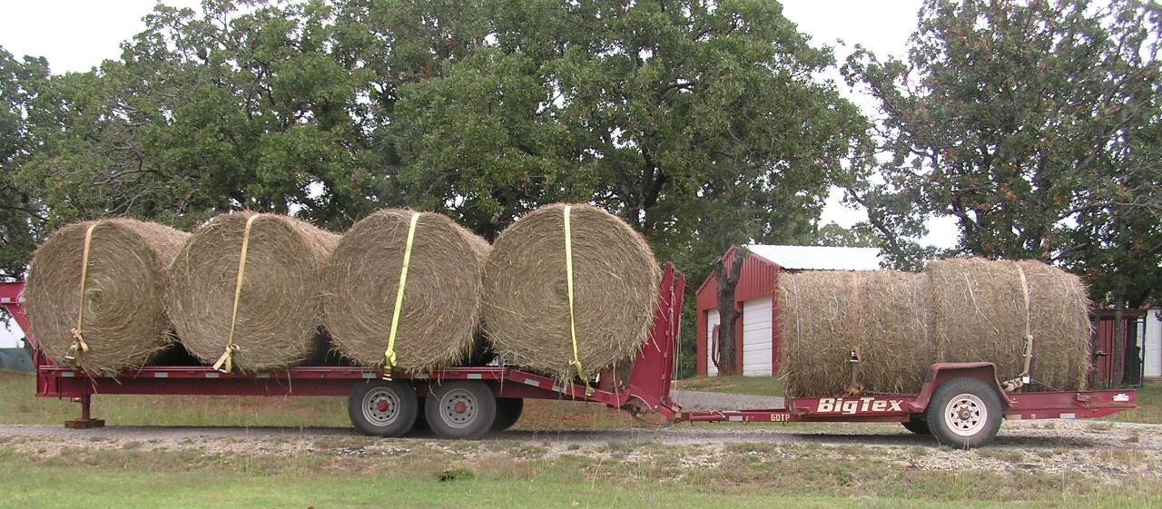

Yep, it is in post #54 GCVW was 24,940. Online search shows max truck capacity of 9200, max towing capacity of 14,200 = 23,400, so I was over that by 1,540 pounds. The total trailer weight was 17,640 on a 14K trailer, if I did all the math right.
For us guys using SRW we'll easily exceed our GCVWR using a heavy duty trailer.
Yep, like every time we haul 10 5x6 round bales. :D
