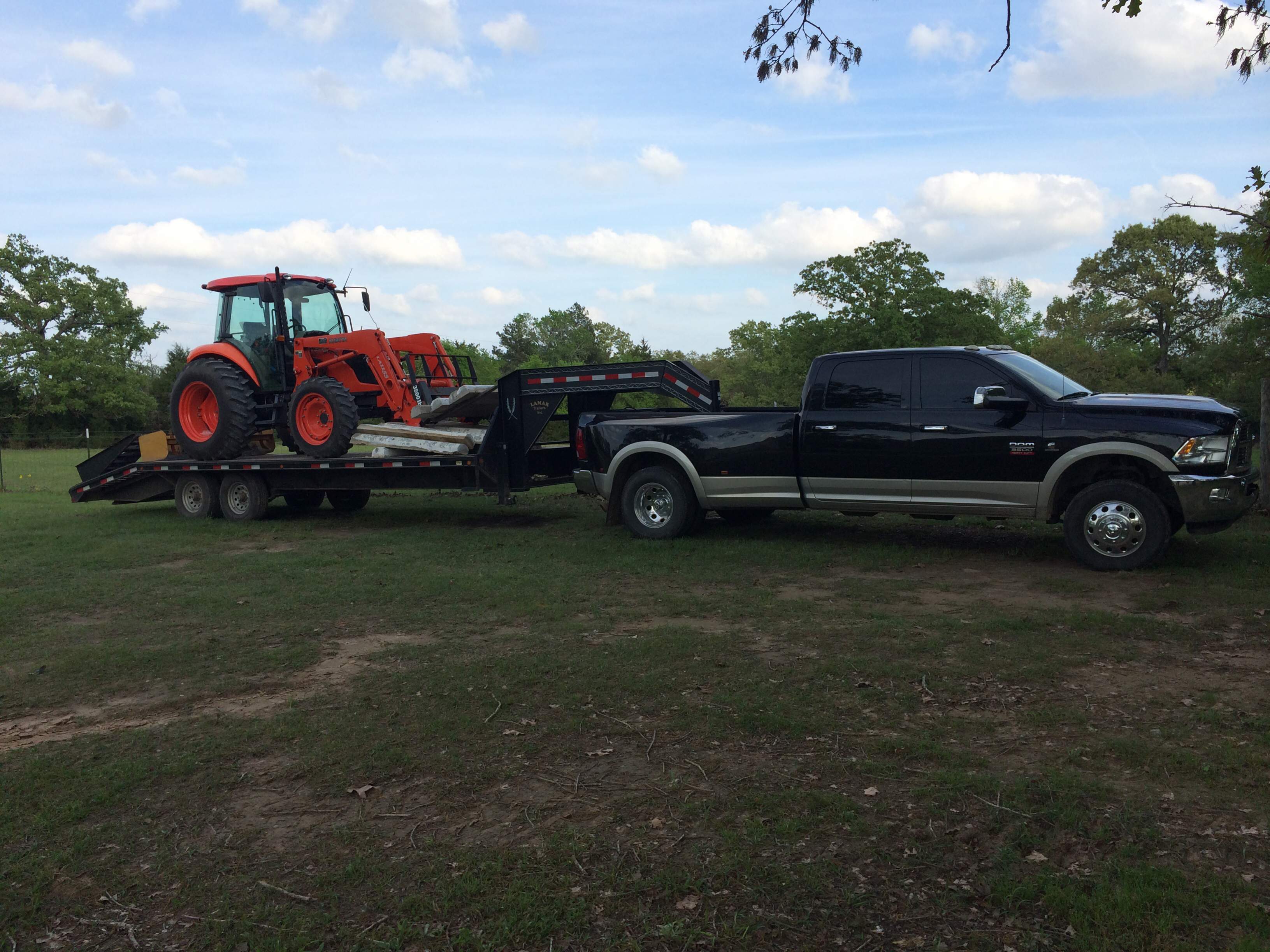

image.jpgI find the GN a lot easier to back up and into places. Most the length of GN well is over in your bed so total yes it longer off the truck but not much on it. I find pulling the GN is way less stressful than the bumper pull,they just pull so much better loaded.
Heck keep the Bp you got and get the GN too,that's a win win...

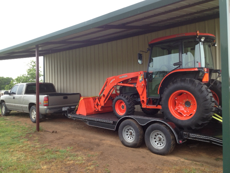

I outgrew my 7K H&H 20' BP tilt bed trailer last year. I had a GN a few years ago but as mentioned before, have to swing wide on turns, it cut corners short and tough to back up in a narrow drive and it weighs about 1k more than BP. I sold the H&H and bought a 22' (actual length 23'9" deck) PJ 14K full tilt BP. This PJ model places the axles further back and makes it easy to handle. Tows great and easy to back into my tight drive.
Make sure you check your truck receiver hitch capacity tag. I had to upgrade mine. I bought a Curt class 5XD hitch. I use a 25K rated 2 5/16" ball on a WD hitch
Curt XD Receiver Hitch specs:
Towing Capacity
Weight Carrying Capacity: 16000.0 lbs.
Tongue Weight: 2400.0 lbs.
Weight Distribution: 17000 lbs.
Weight Distribution Tongue Weight: 2400 lbs.
