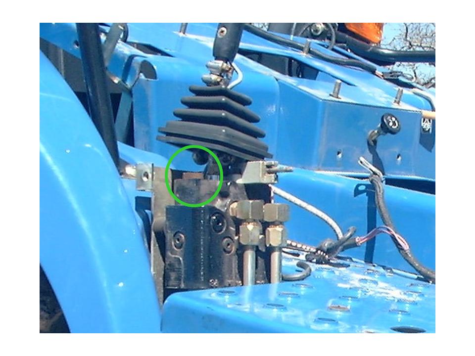

What everyone seems to be hinting at, I believe, is that you are having some type of loader valve problem. On my tractor, the loader valve (joystick valve) must be in neutral for the fluid to flow to the 3PH. This is the power beyond function/port on your joystick valve. What happens on my valve is there is also a plug that has to be installed inside the valve to route the fluid to the 3PH instead of back to the sump. If that plug gets loose, similar sypmtoms appear to what you've described. My guess is that you valve has something similar, although I'm just not sure if your valve looks anything like mine. I would guess this because you have to have a backpressure situation before fluid flows to the 3PH. That's why it won't work until you curl your bucket all the way up.
Anyhow, on my valve there is a hex head cover that has to be removed and the plug is below that. It takes an allen wrench to tighten the plug. I've included a picture of my valve and the cover's location, but I have no way of knowing if your valve looks or works anything like mine. It does seem strange that you would have this happen at the same time as the hose leaking. Coincidence? I'm just not sure.:confused:
