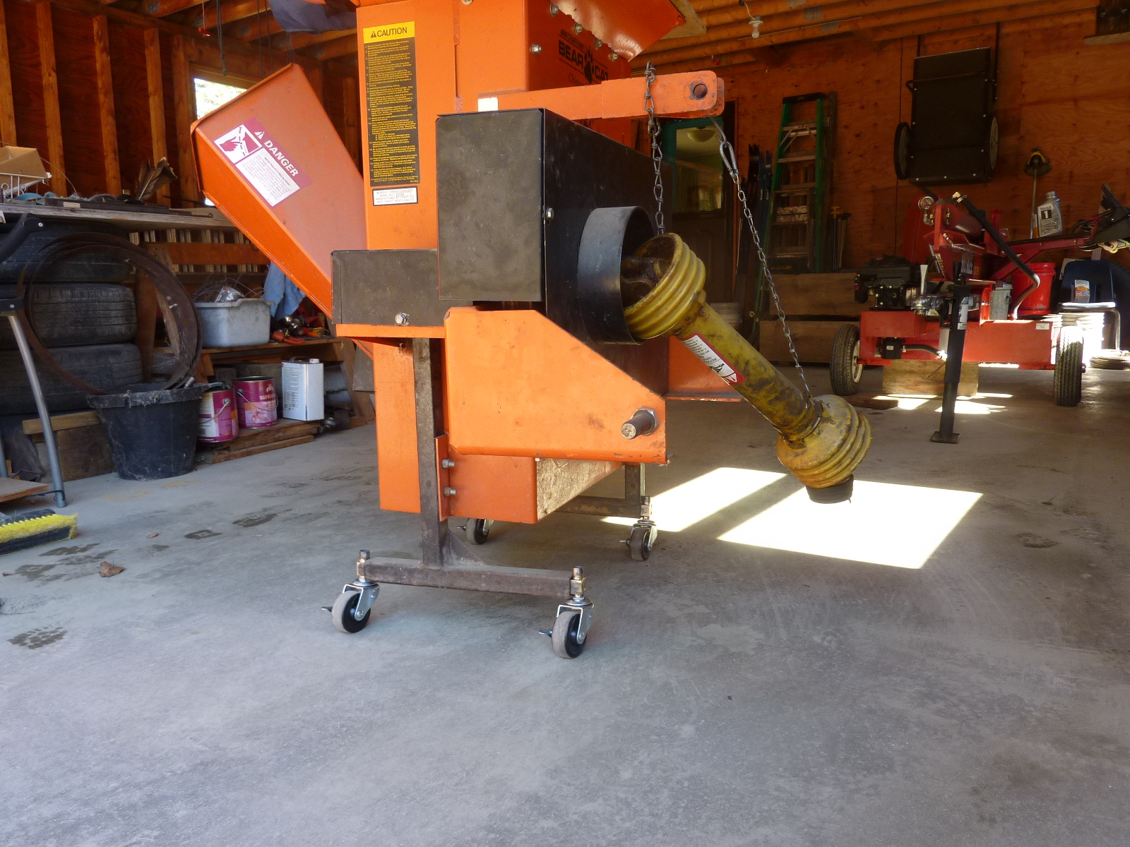

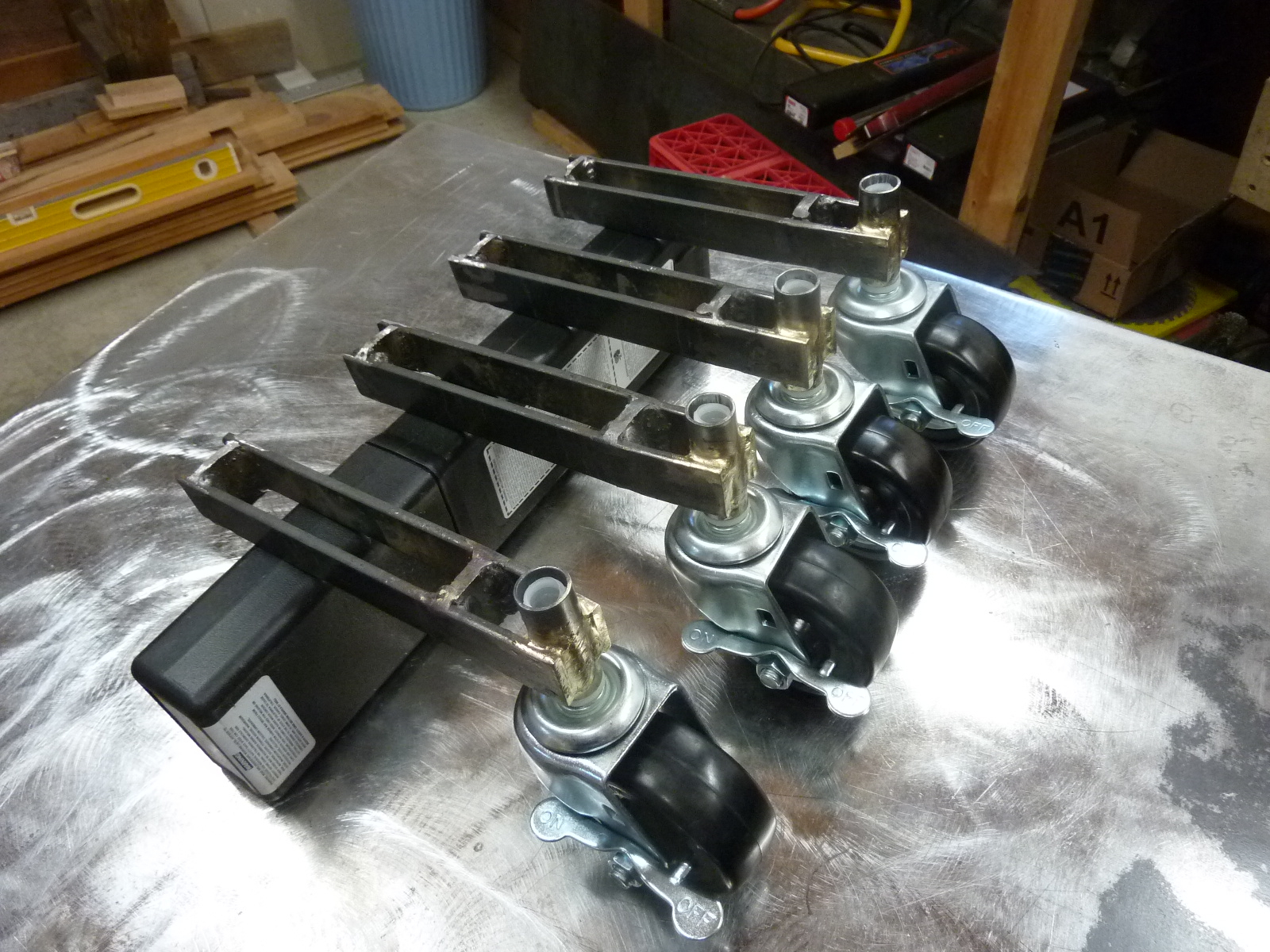

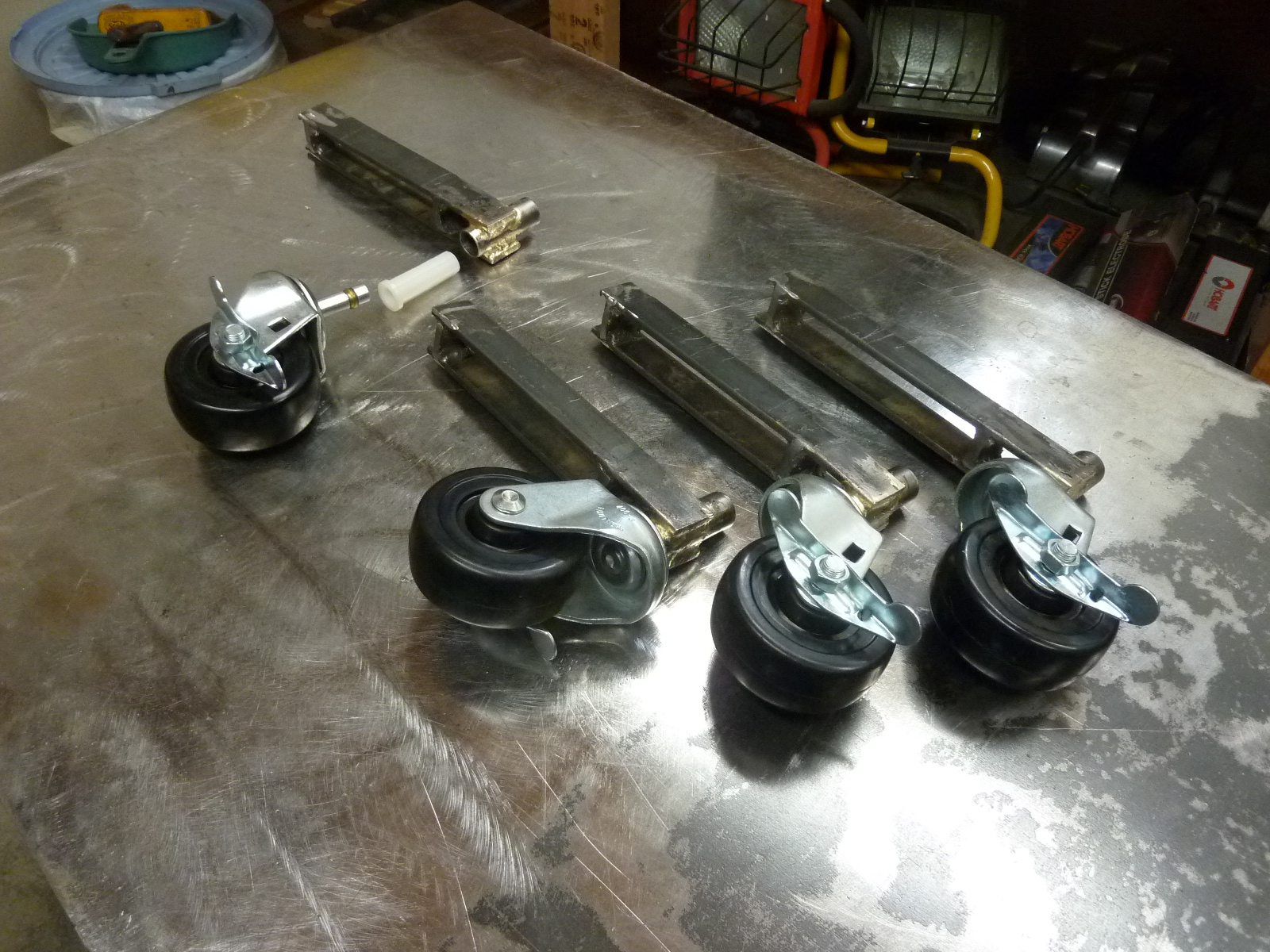

Surplus Center has lots of casters. Maybe you can find something there. I made some for my chipper and used SC casters. They just slide into the square tubing.
