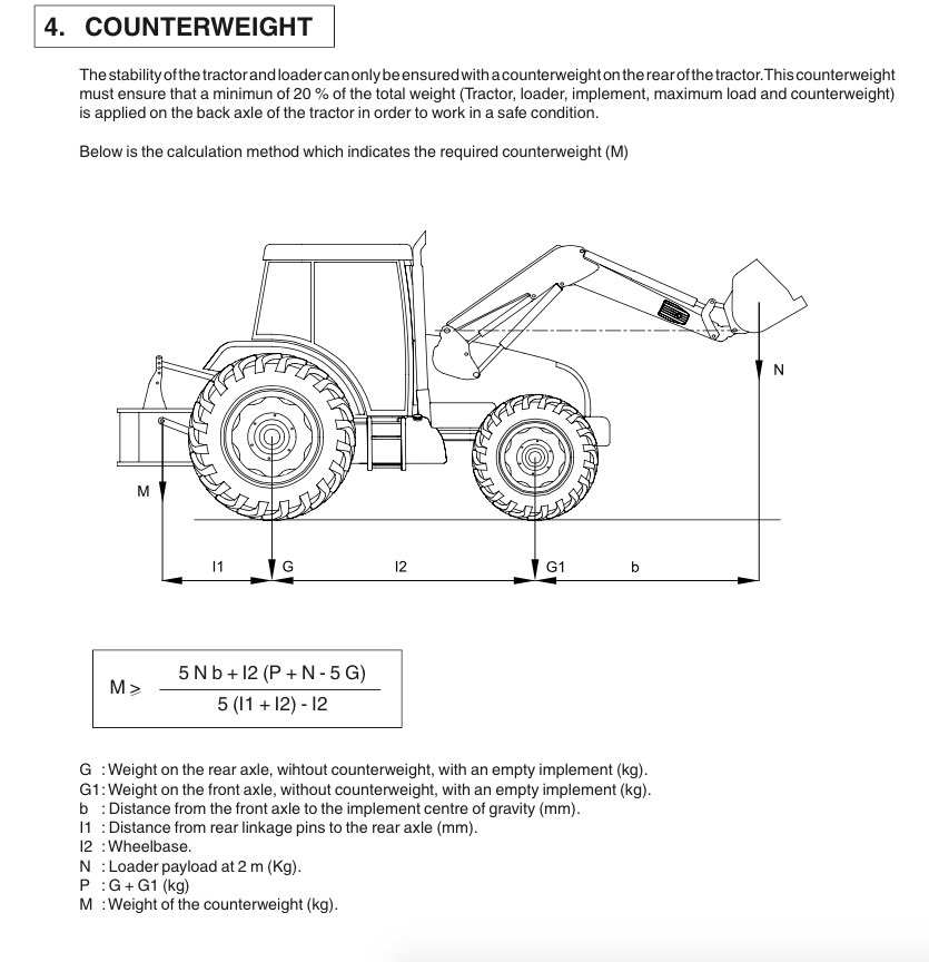

You値l regret not loading your tires Drew. I致e got filled tires, on my 100 HP New Holland, and wish it was even heavier when pushing out dead trees, etc. Lots of choices of fluids from water with RV antifreeze, WS wiper fluid, or RimGuard.
Rick, I agree you get extra stability with tire loading, which is good for slopes as a way for lowering the centre of gravity, however I thought Drew's land was flat, so it is working with the loader that will be his main consideration and that calls for the weight to be further back. He is almost certainly going to need a heavier counterweight than before on the 3pt for both stability and to prevent overloading the front axle when lifting heavy loads with that new much higher rated FEL.
Drew, Massey should be able to tell you what weight you need - the equation the manufacturers use to work it out looks like this
