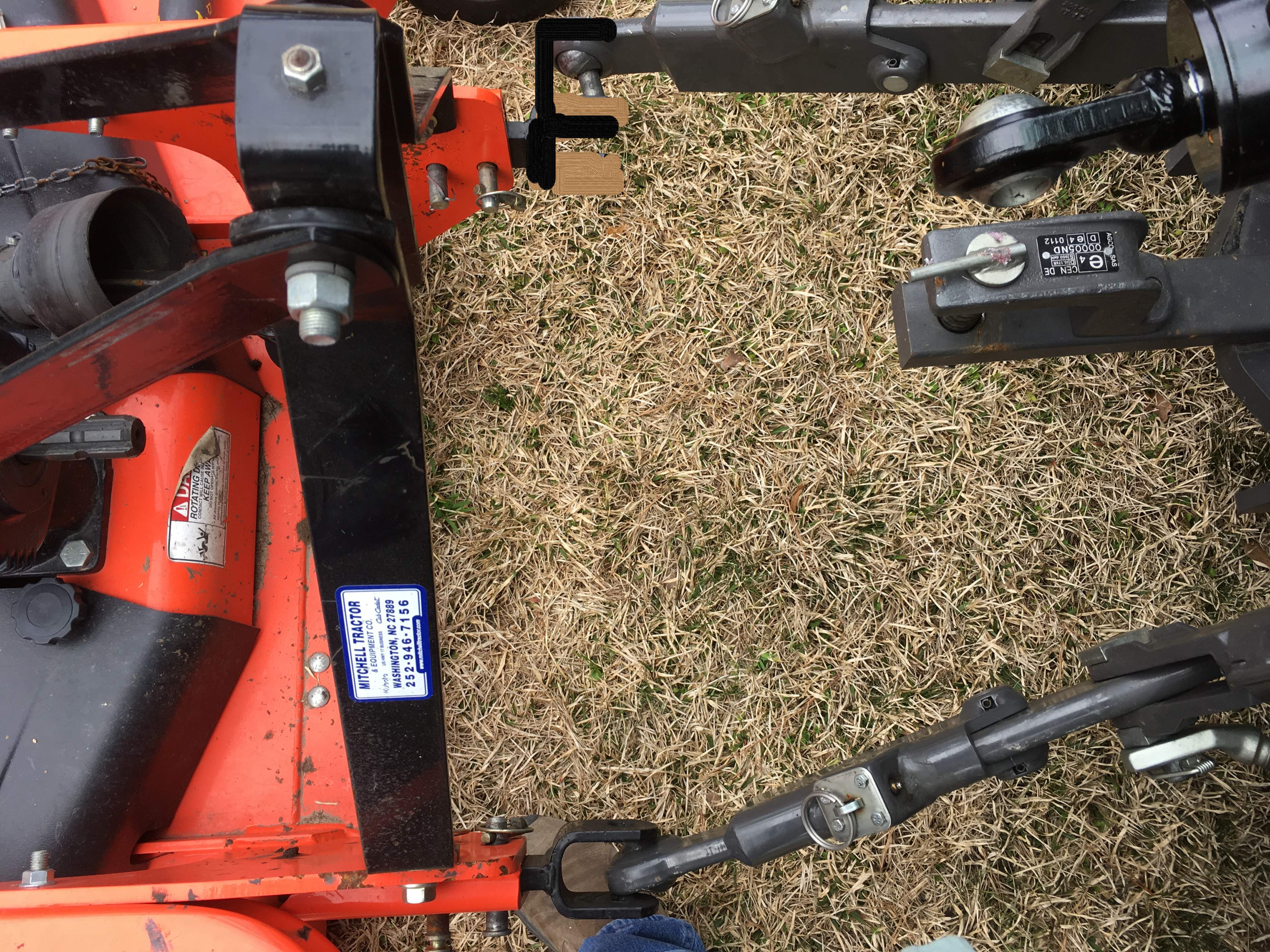

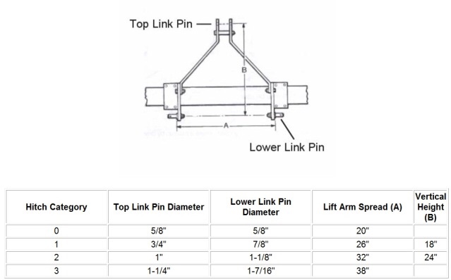

great pic Ron and thanks for info. LP quick hitch is likely strong enough, but definitely would need some fabrication work.
Here is a pic of the mower issue.
Seems like a longer version of this lower link pin from Tractor Supply would work, Drew.
267806
Probably want to put a sleeve between the two ends of the "C" on the mower end to keep it from collapsing, and it might need extra length welded on to reach the 3PH arms, but I seem to recall them being available in several diameters and lengths. At four bux a pop, they aren't expensive and could save some time int he workshop even if they require modification to work.
Can you adjust your 3 point arms inwards?
Your other option may be to get new brackets welded on the mower.
Drew, does your MF have telescoping stabilizers with multiple holes for width adjustment of your lower arms? Similar to below? (Yes, I know that's a European configuration).
If you adjust them for minimum width, of your lower arms, what is limiting you. Length of stabilizers?
My small tractor, LS XR4155HC has CAT 2 hitch and I still easily hookup to both CAT 1 and CAT 2 implements. Tractor Supply sell CAT 1 to CAT 2 bushing for both upper and lower pins.
My telescoping lower stabilizers offer plenty of width adjustment to accommodate both CAT 1 and CAT 2.
It sounds like you need additional length for your stabilizer bars?
Can you take a picture of your 3 point stabilizers?
Afternoon;
I can see two fairly easy ways to take care of that problem.
Any halfway decent welder/fabricator shouldn't need two hours to do either one;

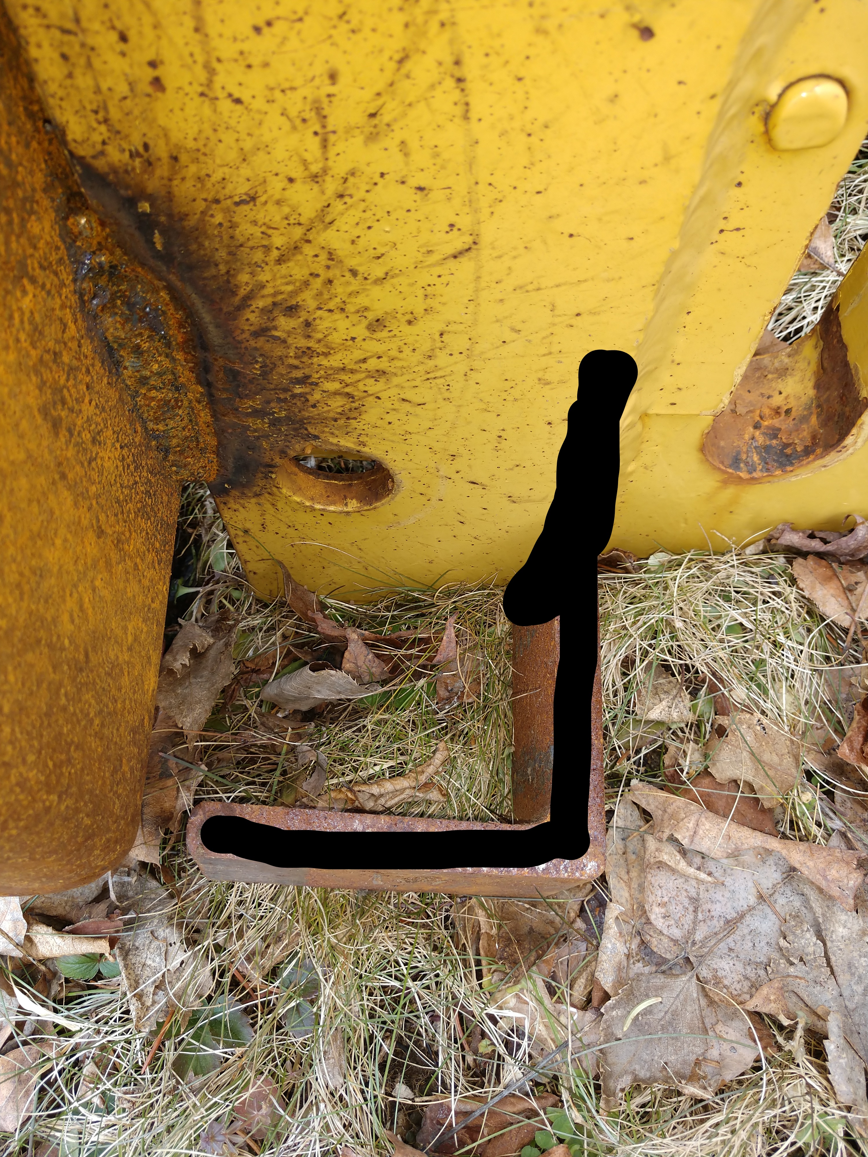

1) modify your existing mower hitch arms,
cut the ears off, weld on a sideways extension and two new mounting ears, with cat 2 holes (1 1/8")
2) buy a cat 1 quick hitch and 2 6" pieces of 1/2" thick 4" x 4" angle iron with an appropriate hole bored in it and weld it to the quick hitch
I would bore out the quick hitch to 1 1/8" holes and use a long cat 2 pin, but a cat 1 pin and a bushing in your lift arm would work also.
I am surprised that your lift arms don't have bit of a bend to be more square with your implements.
Just have a better job done then my photo editing is.
You may need to remove that top strap off your drawbar it may get too close to your pto shaft,
If it was me I would make new arms for the mower, but a modified quick hitch would work on other cat 1 implements.
I don't like the quick hitches as they get in my way reaching in to connect the pto's.
Good luck
