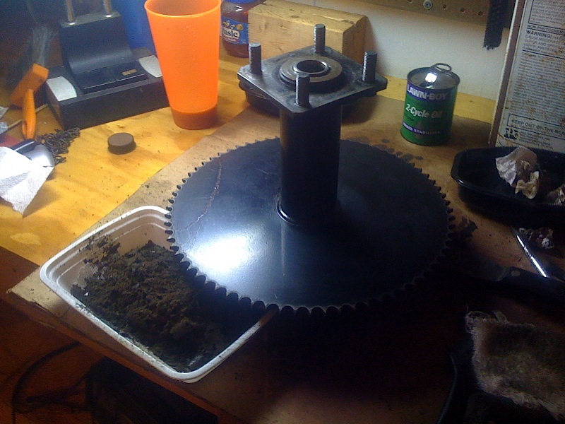

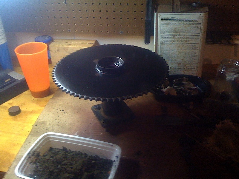

Got the drive wheel hub/sprocket assemblies cleaned up and reinstalled:
attachment.php
attachment.php
   / Good morning!!!! #35,583

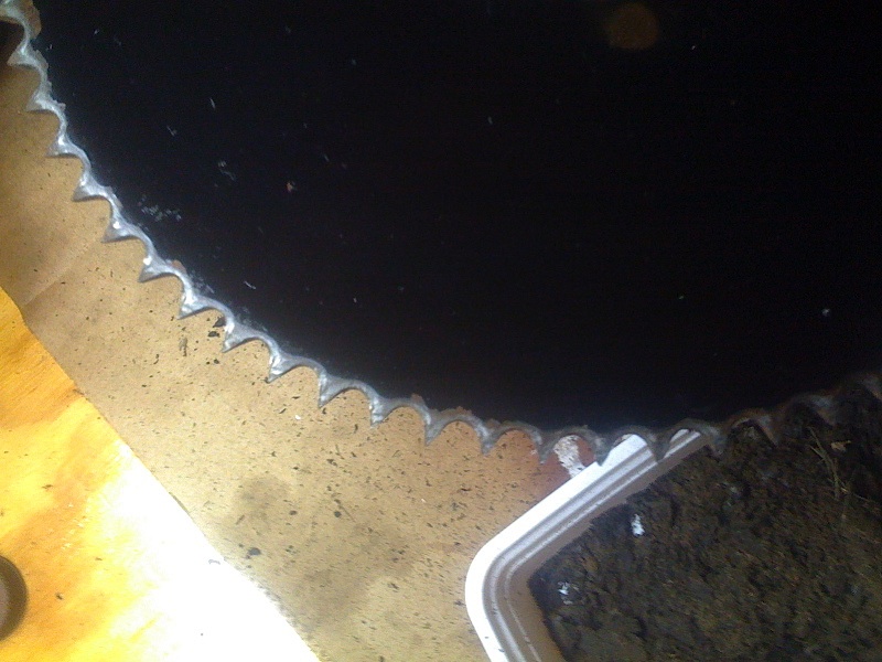

There was a slight amount of hooking discernible on the teeth:
attachment.php
... so when I reinstalled them, I swapped the hub/sprocket assemblies from side to side, to reverse the hook direction. Then I pumped the hubs full of the red Mobil 1 synthetic grease, after I got the castle nuts and cotter pins installed.
Given the sprocket diameter, I'm pretty sure there's enough tooth left to outlast me.
