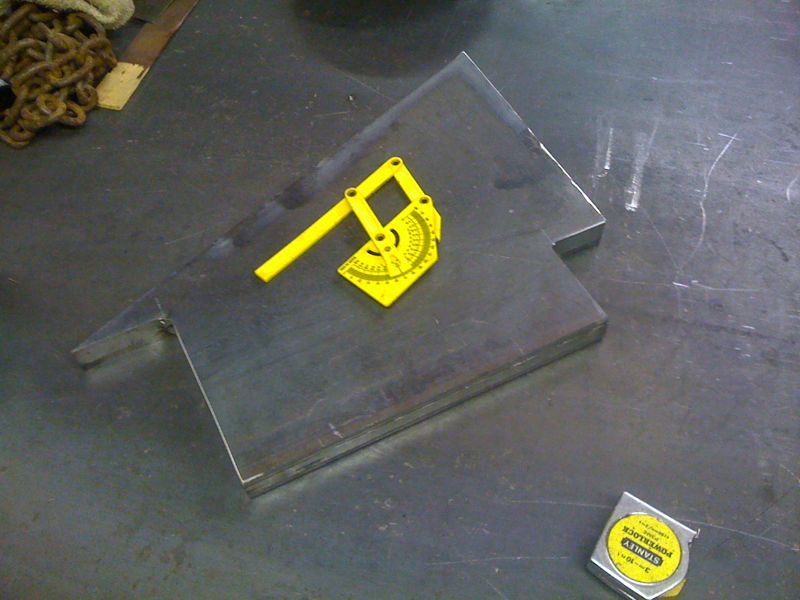

67F @ 07:00 ... heading to bed here in a few ...
Didn't get much cleaning done last night ... ended up doing a whole bunch of grinding though: the tractor-side SSQA brackets, side plates for the shrub bucket, and parts for the grapple.
The image below is four pieces of 1/4" plate that were cut with the O/A torch from the 4' x 8' sheet of plate. They will serve as the bottom of the masts/towers for the upper jaw of the grapple and as mounting points for the SSQA attachment plate.
Being cut with the torch, the edges were pretty rough and the size varied a good bit ... so I tack welded them together and then ground them, so that they would be fairly close:
They will provide an additional 20 degrees of roll back (my loader only has 26 degrees of rollback) for a total of 46 degrees.

What about a plasma cutter?
LOL ... what about a plasma cutter ?
Short of a CNC-driven plasma (or maybe a pantograph), there's going to be some variation ...
We used a 4'+ piece of 3" x 3" x 3/8" angle as a cutting guide for the torch and the cuts were pretty close (UB's hand was lot more steady than mine ... :laughing:)
Ya gotta understand and keep in mind: I laid out and modeled the grapple in a CAD package with the numeric accuracy set to .0001" ... :D
Given the above, when I say "the size varied a good bit", an 1/8" is a lot ... from my perspective ...
In the big scheme of things, for lots of stuff in this project (but not all), precise fit up really isn't all that critical.
If there's an 1/8" (or 1/4" or ...) gap, just fill it with weld ... ;)
