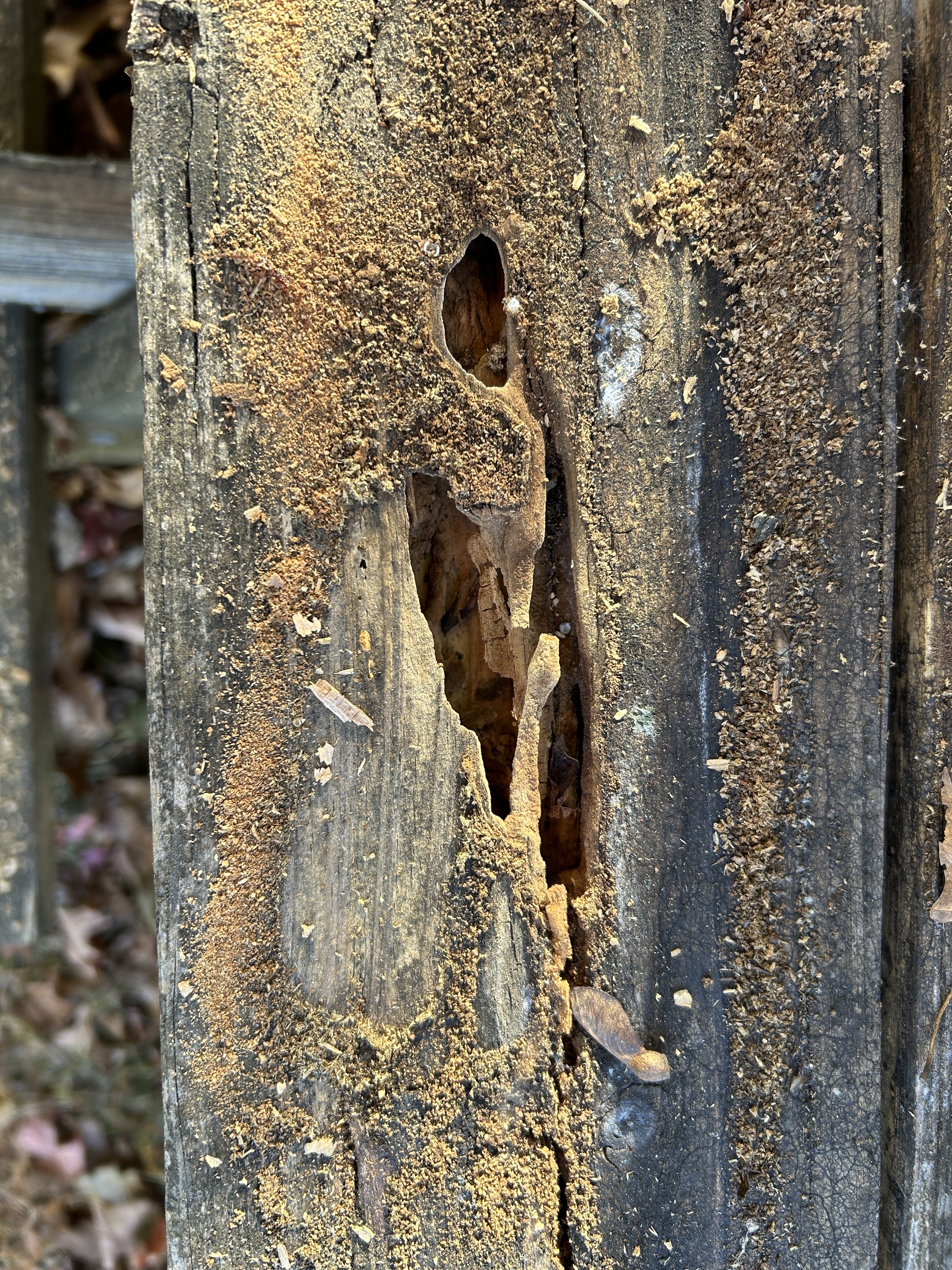

Moved some of the old 16 ft deck boards that have been piled on top of my old picnic table in back yard. Discovered a bunch of carpenter ants in them, they did some damage. Ants made big hole in picnic table board also. Then moving other old boards and found a bunch more. I sprayed them all. All this old pressure treated lumber.

Top of picnic table:
Sorry about the picnic table and boards.
Given what has been used in older pressure treated lumber, I'm not sure I would want to be anywhere near the old PT if it is being burned. Some of the stuff I used when I was a kid is now solidly in the hazardous waste category (e.g. "penta", pentachlorophenol), and some types are/were organic and could turn up in the smoke and fumes.
But maybe yours is just plain old copper arsenate.
All the best, Peter
