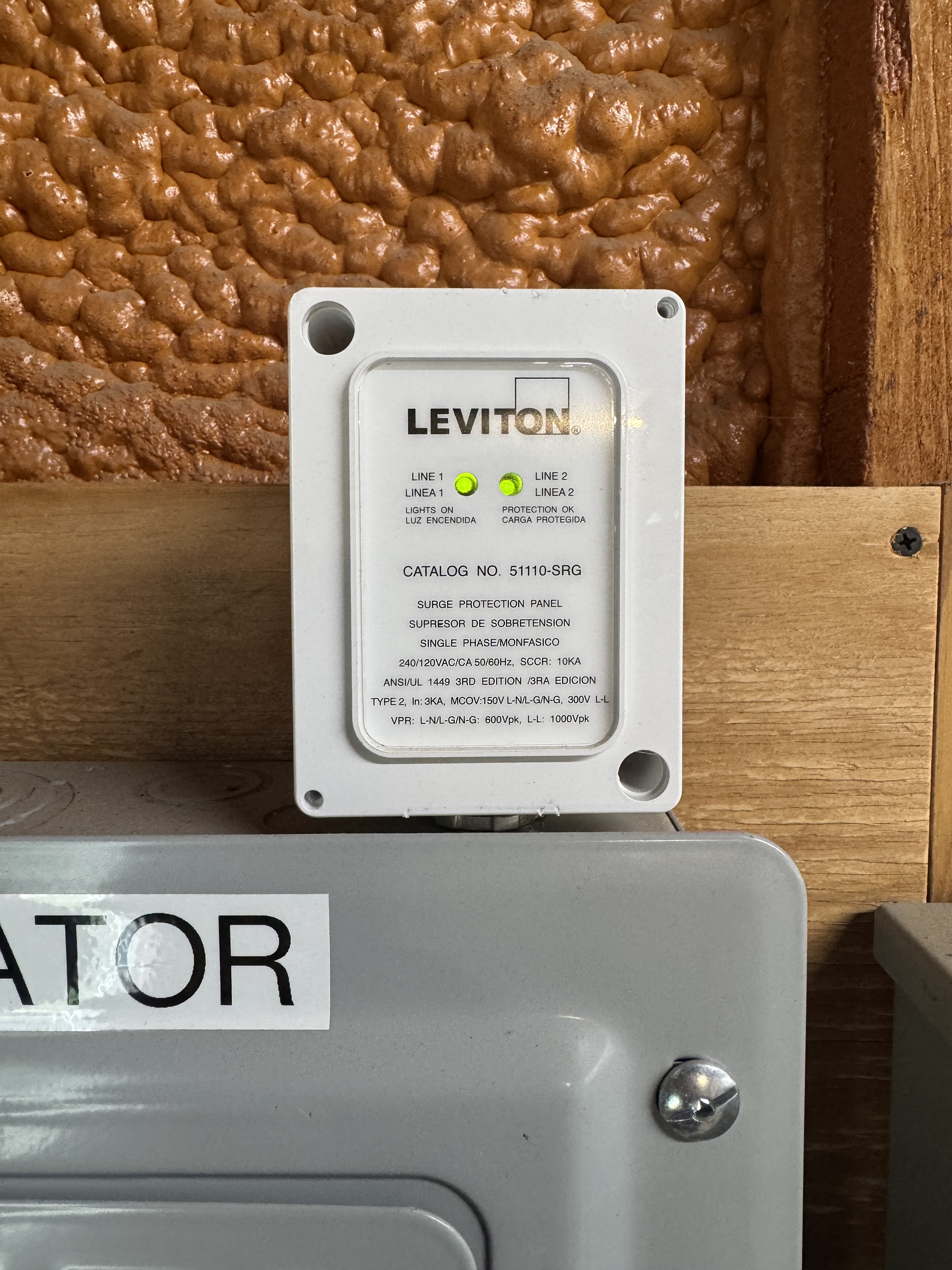

How do you know when to replace them?
Most whole house units have LED’s to indicate their health.
When an MOV sacrifices itself, it’s usually in a grand way, blowing themselves apart and leaving a tell tale burnt smell, usually evident in power strip type surge protectors.
They generally fail shorted, so the failed device will usually trip the breaker on the circuit itself connected to.
But generally they are in the “if it ain’t broke, don’t fix it” category.
