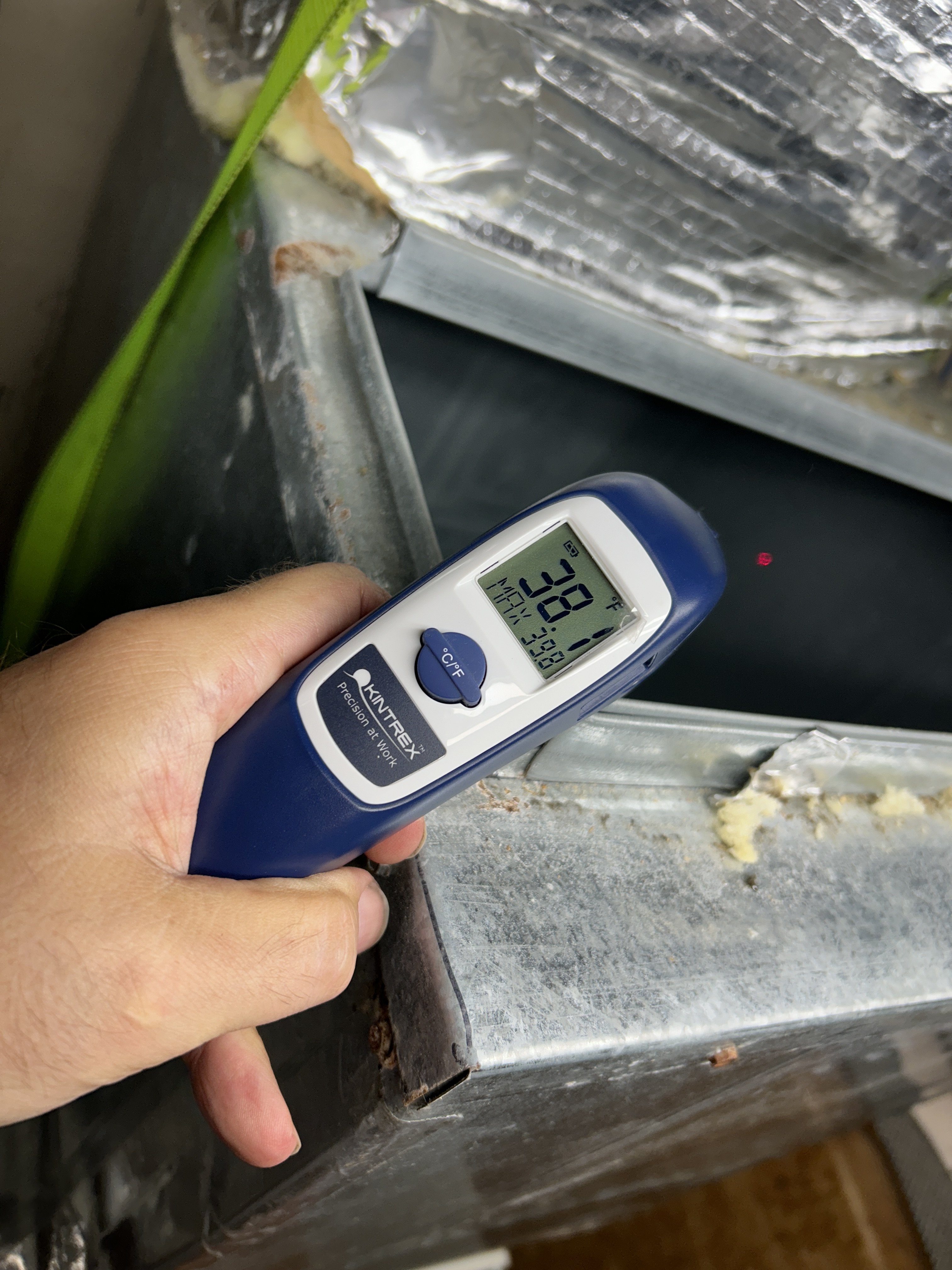

Anyway nice cool day for new geo unit to put out 38° air on the first test.
Didn’t get one hose tight enough, leaked a little water.

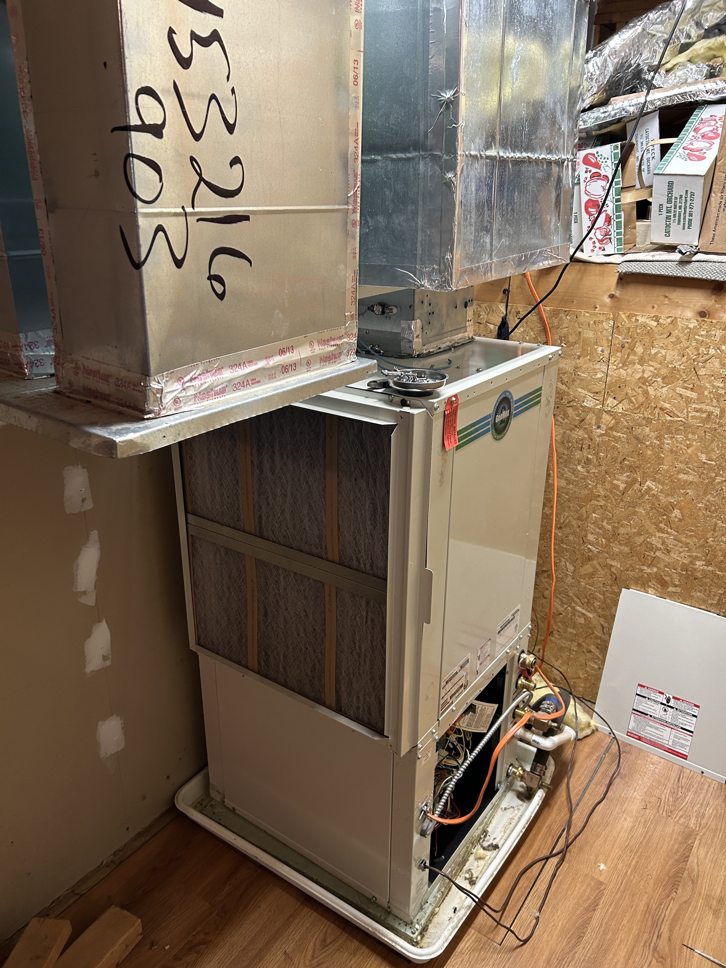

Starting to put ductwork back together.

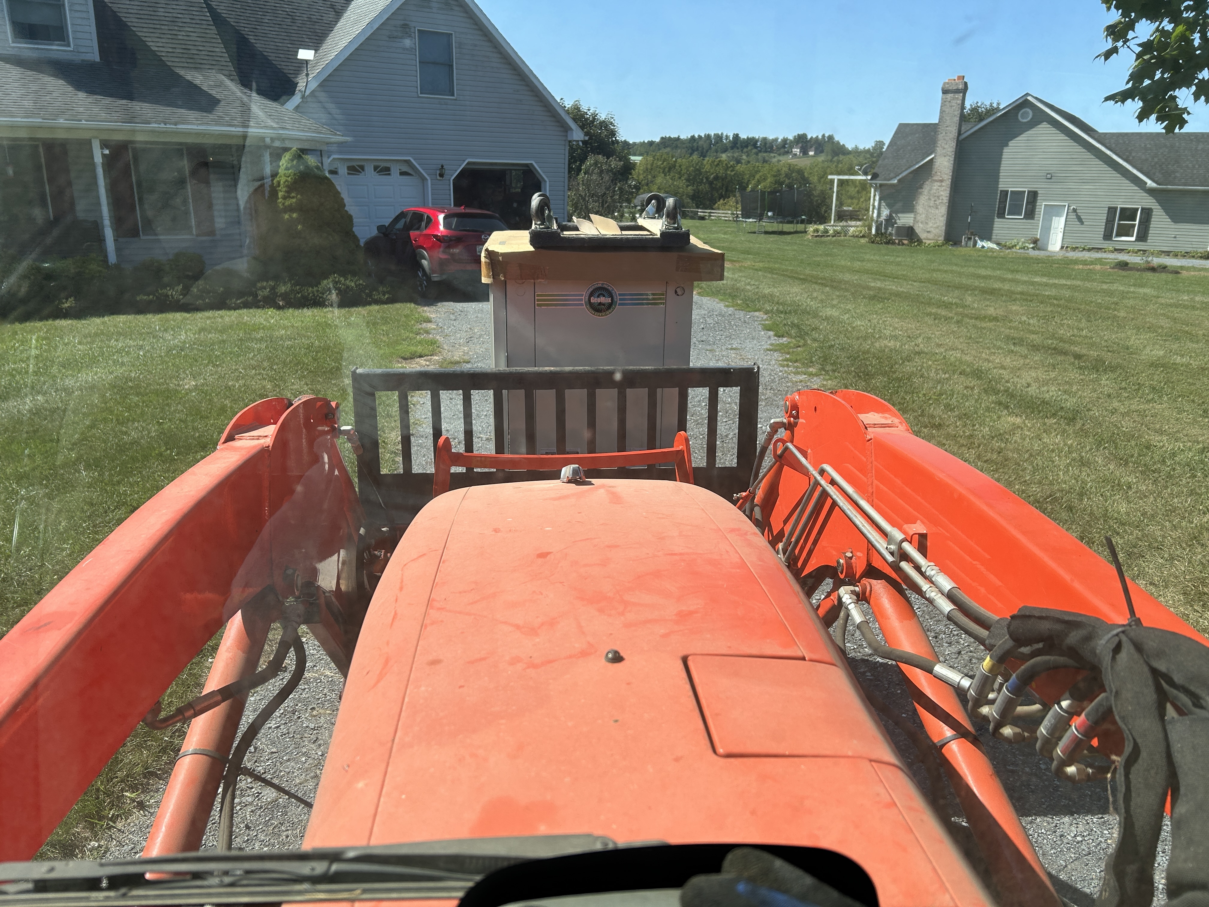

Old unit already bolted to pallet and in the barn
Wasn’t as hard as expected, slid it out in the pan, tilt one side and throw a couple blocks under, then slid over edge of pan onto a dolly. Good thing I still have the handicap ramp into garage. Reverse order for the new install.

The ductwork reinstall will be a pain, especially my homemade return plenum. I had to partially disassemble it to cut the tape that sealed inside the old unit. Probably won’t tape it this time, or try to tape from outside.

Got upstairs ductwork back together. Need to insulate some. Just need return plenum and heat coil wiring.
Smells in the room, I’m hoping it’s the glycol from dumping some water, and not Freon.
Should finish tomorrow, but I could run it now.
