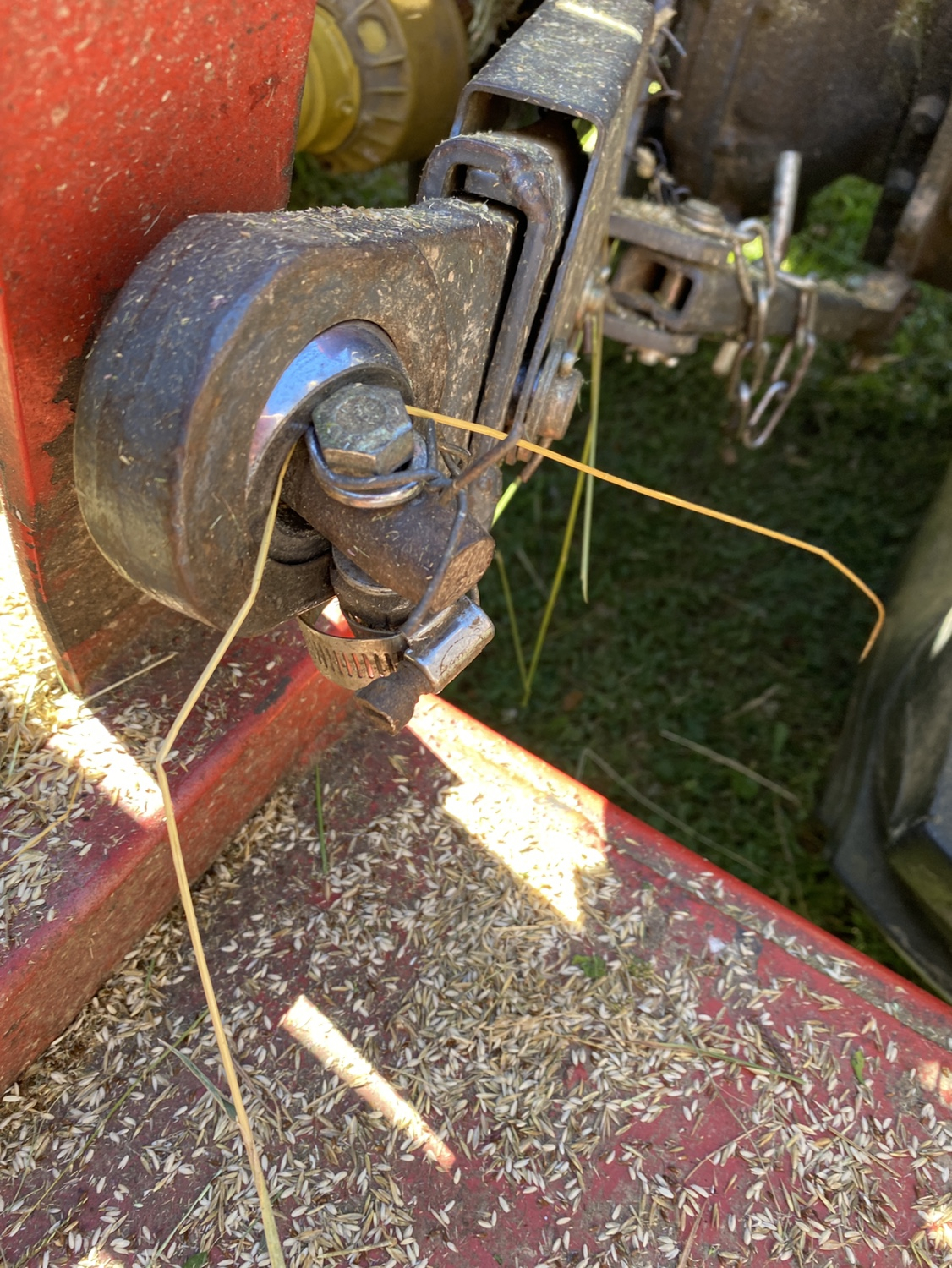

So here is dads lynch pin.
A bolt, washers, wire, hose clamp.
He said he kept losing the lynch pin.
The problem was the L5030 has larger cat2 arms and the mower had cat1 pins. There should have been sleeves in the tool box, so I went to TSC and picked up a few.
By the looks it work well.

You may want to replace the special Lynch pin with a bolt for the bucket because it is easily lost when using it to do tree work and Kubota wants lot money for it. The standard TSC pin is not nearly as strong as the Kubota Lynch pin.
How about a tether on the pin? Or a carabiner Instead of a pin?
If you keep the Lynch pin on a tether and loose the long shaft for the bucket you are out some money. Lost one shaft and discovered one half way out before loosing the second one.
