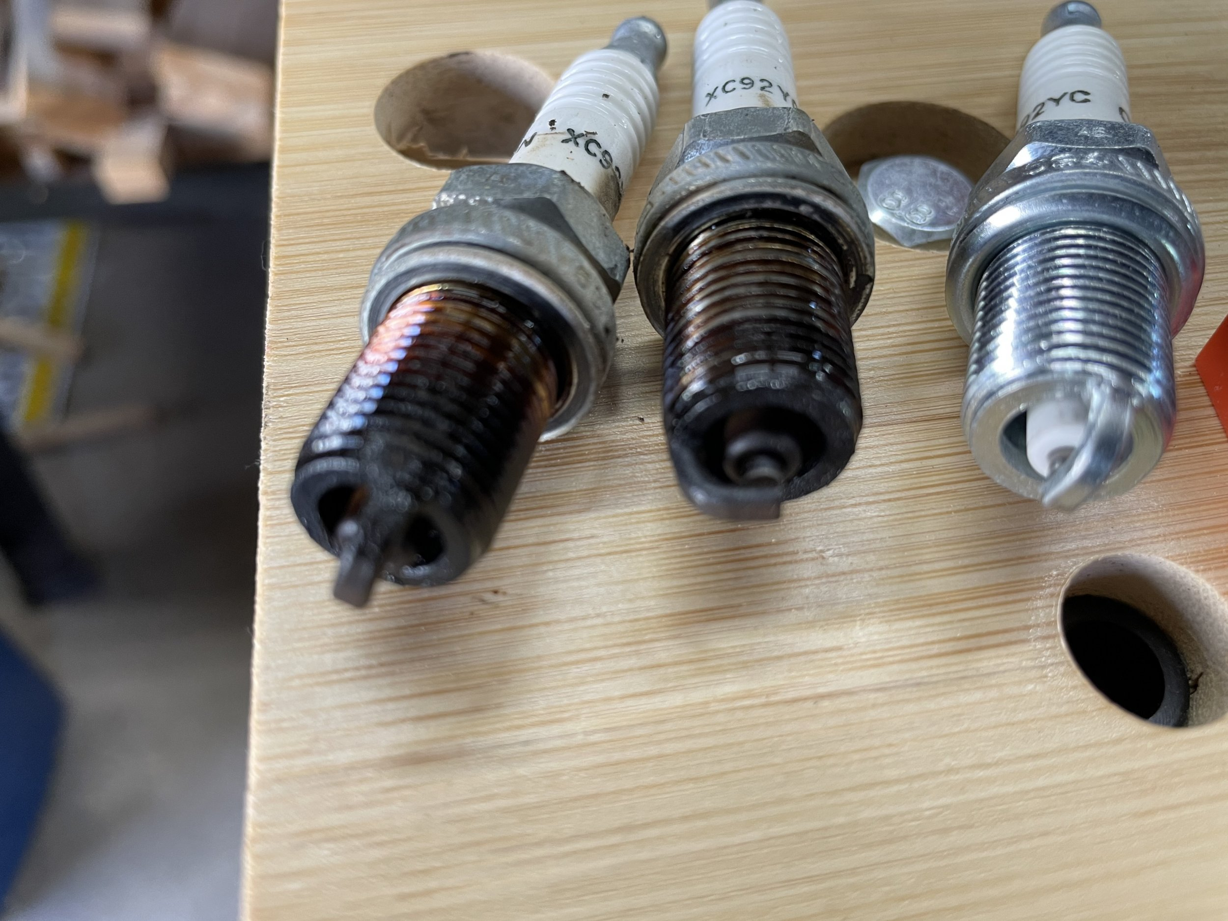

partially successful in garage
fixed one mower and botched the other
replaced mower blades on JD X390, greased it while somewhat up in air, that went easily other than bashing a knuckle.
Then the fun stuff, replacing air cleaner and plugs on Gravely, 23hp Vanguard twin.
backfired and popped and ran awfully, felt like a shorted out plug wire. Wonder if one wire broke while pulling it off.
Need to start from scratch again, make sure QC12YC plugs are gapped at .030, maybe one got pushed in
I reconnected the plug wires very carefully, seemed fine. I screwed something up.
will try again tomorrow
plugs were wet, from being started and stopped and not run hard enough, plus choke is generous

Put the old plugs in and try it our first.
I had a plug once with a hairline crack that did that.
I have a plug tester if you need it.
