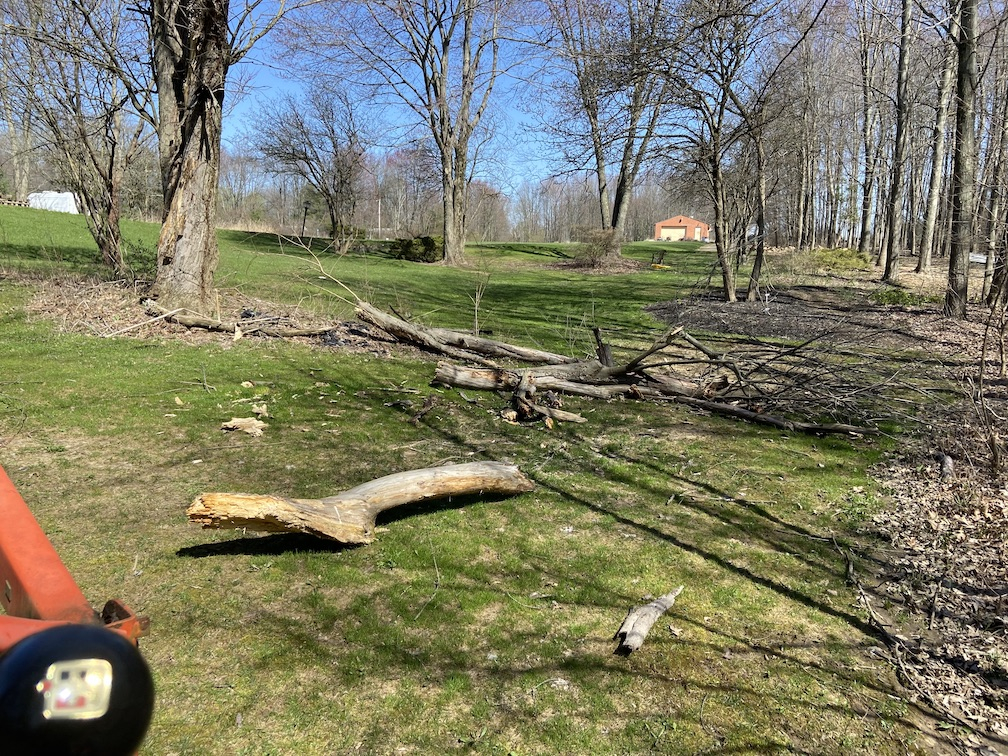

Put pallet forks on Kubota yesterday and removed the parts of the dying maple that had fallen down and threw those up on the brush pile. Took three trips to get them all:

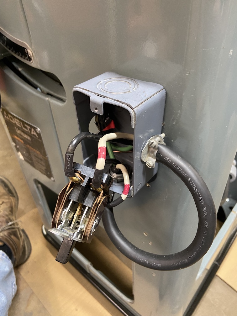

Then headed up to the shop and got back into working on the saw.
Got VFD mounted in metal enclosure, then metal enclosure mounted on the saw cabinet.
Installed the worm gear, shaft, and hand wheel to raise and lower the blade.
Then after that I got the wiring done on the Snap Switch that will feed 220v power to the VFD:
That took more than an hour, as the box was so shallow that I had to relocate one set of wires from the bottom to the side, and replace the bolt securing the box to the cabinet with a flat head machine screw so there was enough room for the switch to fit in the box and get the cover on.
Even so, it was a very tight squeeze with the 10 ga wires.
After that I started wiring the power feed to the VFD. Will need to take another look at that today and make sure there aren't any stray strands of wire in places they shouldn't be.
