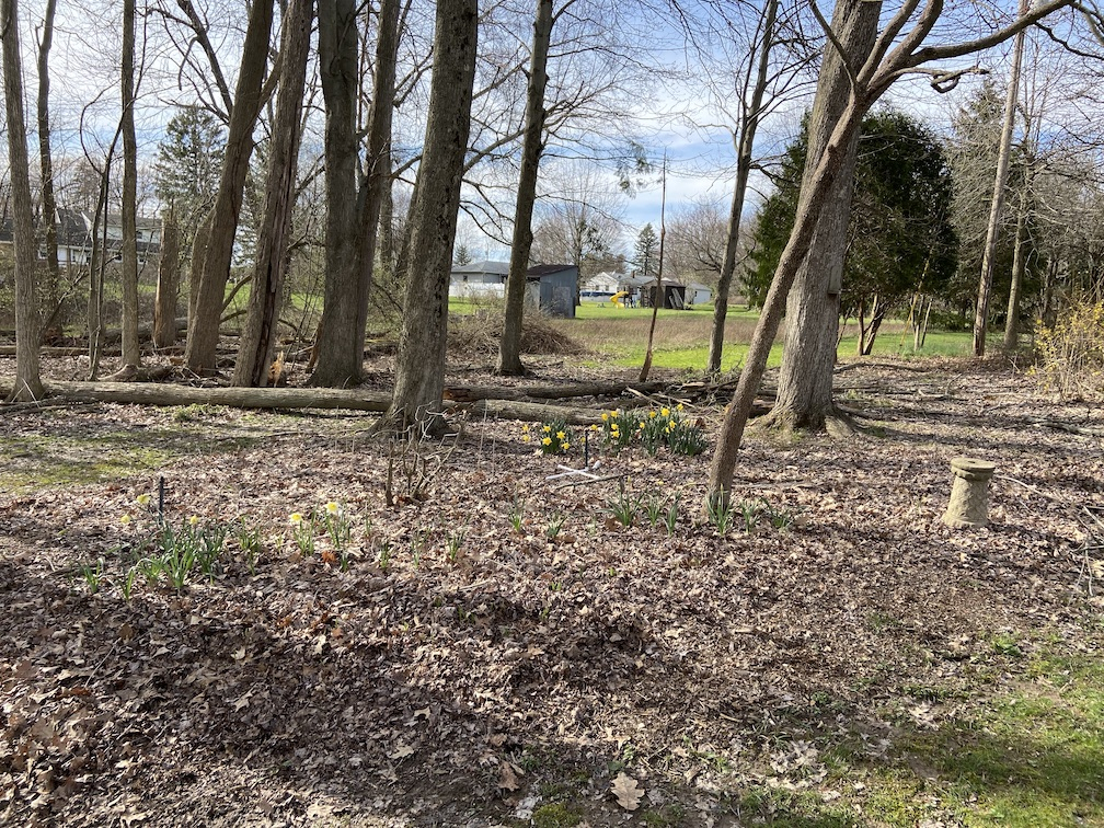

Daffodils going strong, poor arborvitae that got completely de-limbed by falling ash tree in center of photo:

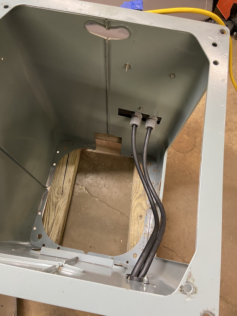

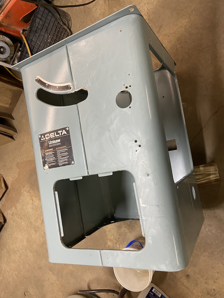

Cleaned inside of saw cabinet and got all the contact cement in there removed:

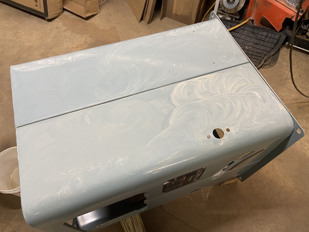

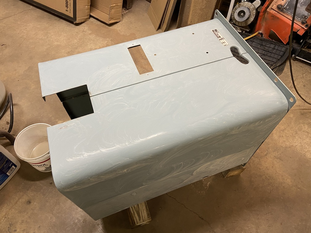

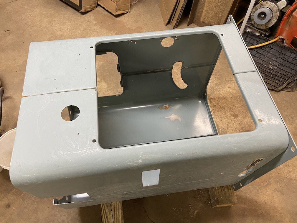

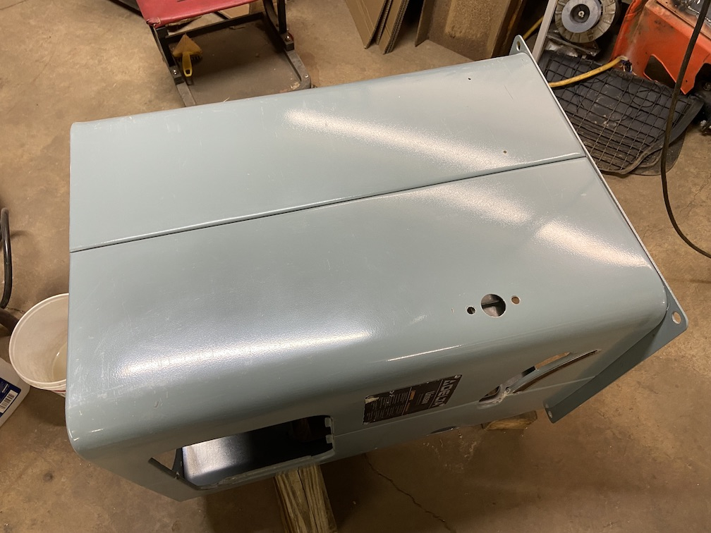

Then hit the exterior one last time with polishing/rubbing compound, cleaned up fairly well although the finish is not perfect:
Could probably improve it further ... if I wanted to spend more time on it (which I don't ... :giggle: )

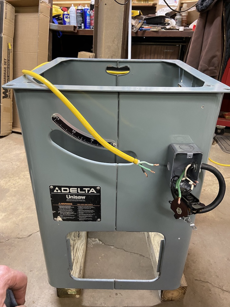

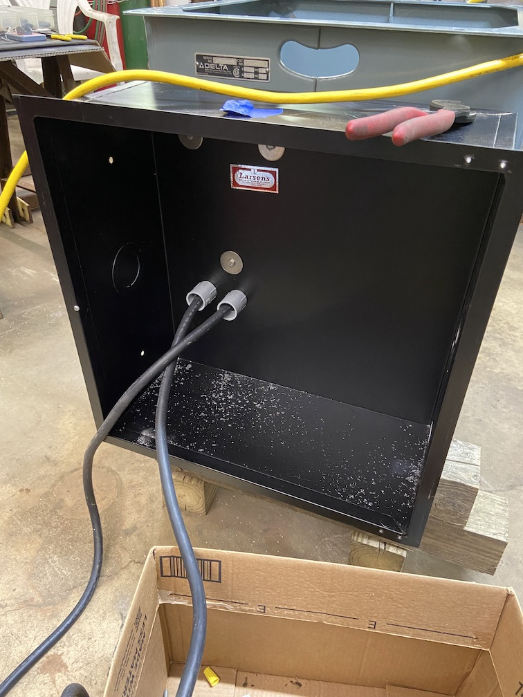

Decided on rear of saw as mounting location for metal enclosure, got it temporarily mounted to figure out wiring lengths and runs:
Used the 10-3 cabling that came with the saw for the runs for power out to the switch and back to the VFD:
There will be one more cable that comes through that cutout in the back of the cabinet to feed 3 phase to the motor from the VFD.

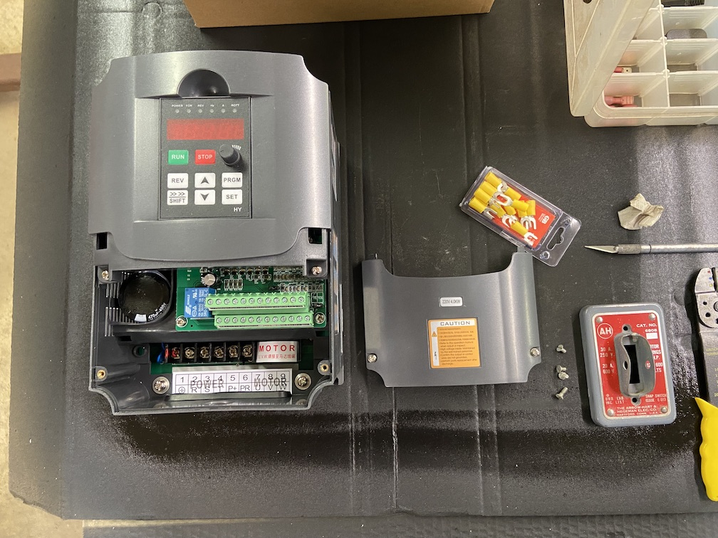

Got switch box for power to VFD installed would have gotten it all wired up/completely installed too ... but I ran out of ring terminals in the size I needed:
Yellow cord is a 220v extension cord I made up that I'm considering lopping off a section of to use to wire the On/Off paddle switch to turn the saw itself on and off. Not sure if it will work (may be too big), as VFD manual calls for wire diameter of 0.52mm for external controls ... which seems awfully small to me (28 gauge ?)

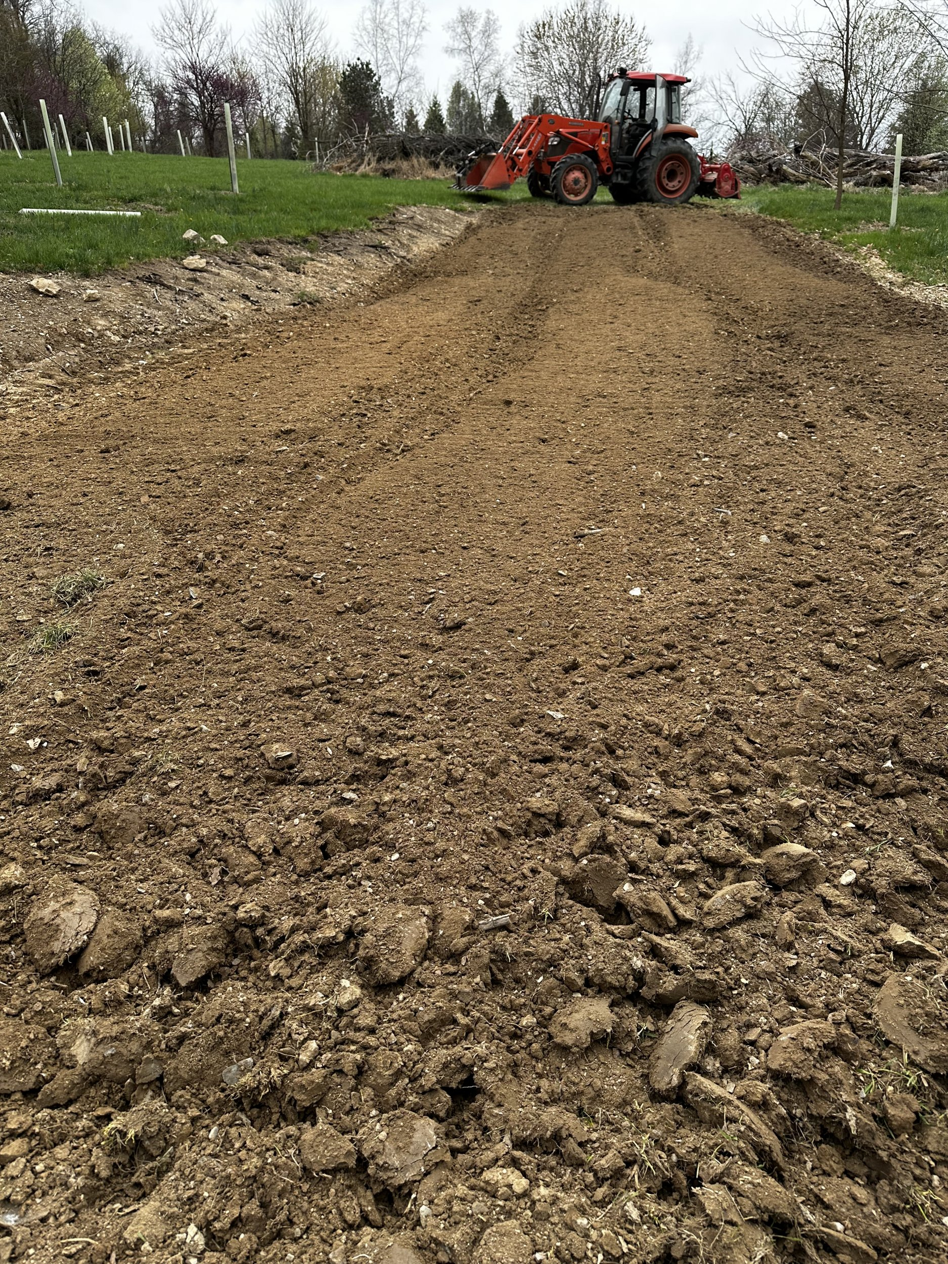

Hauled more gravel over on the ramp and spread it out with the minix blade and compacted by running over it with the tracks.
Cleaned up the area that had been excavated by running over it with the tiller and using the bucket to move the high spots.
