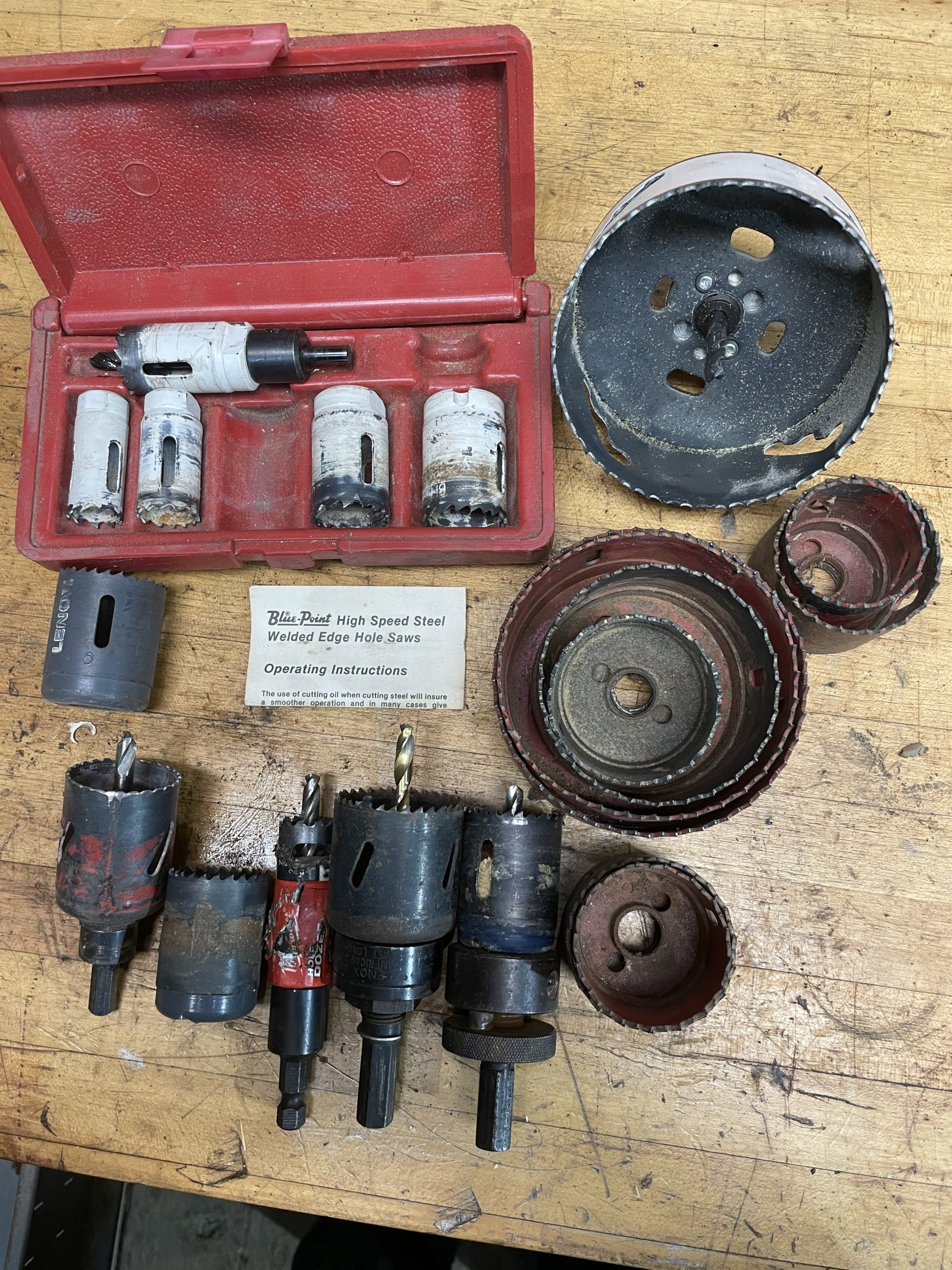

Looking at installing more of the barn gooseneck lights. Did one last year. Two more to go. Was finding in one of the drawers the hole saws and it looks like the big Lenox hole saw will work for the junction box. The last one installed I used tin snips to cut through the steel siding. I don't know if the hole saw will work in steel siding or I should just go back to using a tin snip
The issue with cutting profiled siding with a holesaw is keeping it centered if the pilot drill is not on a raised section. In that case, I have had good luck with cutting a hole with the holesaw in a piece of 3/4” plywood and then clamping or screwing that to the surface to be drilled, using it to guide the holesaw. It works well when cutting a hole bigger and there is no meat for the pilot bit as well.
