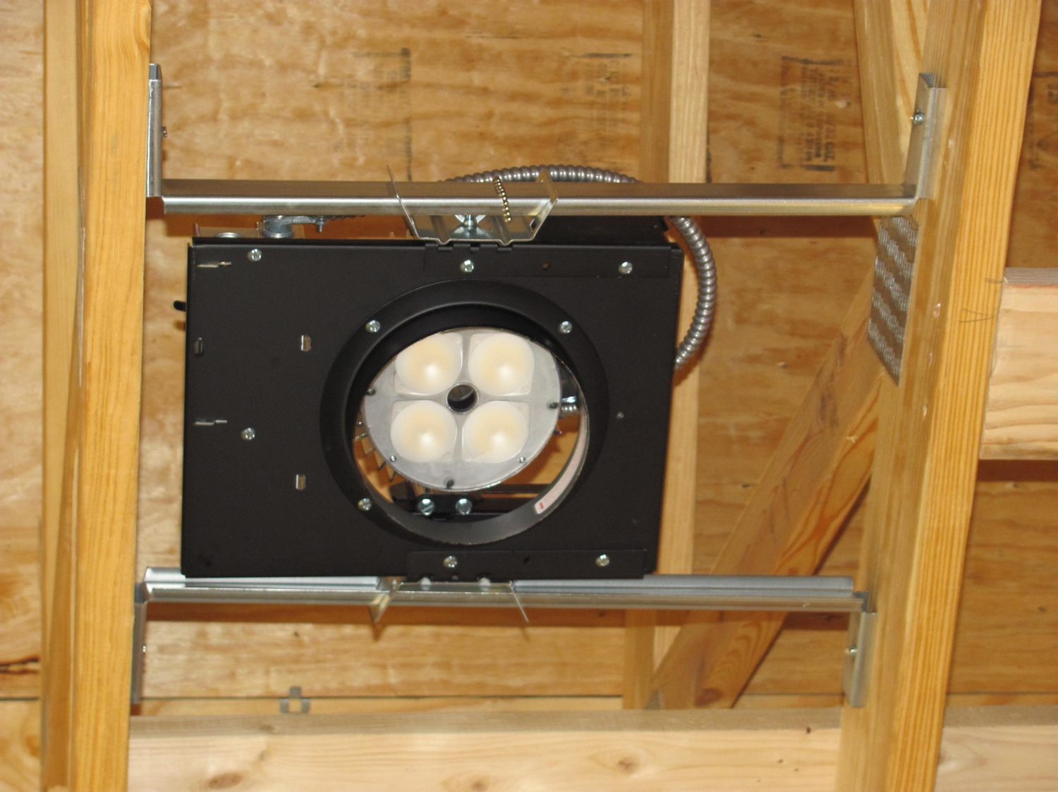

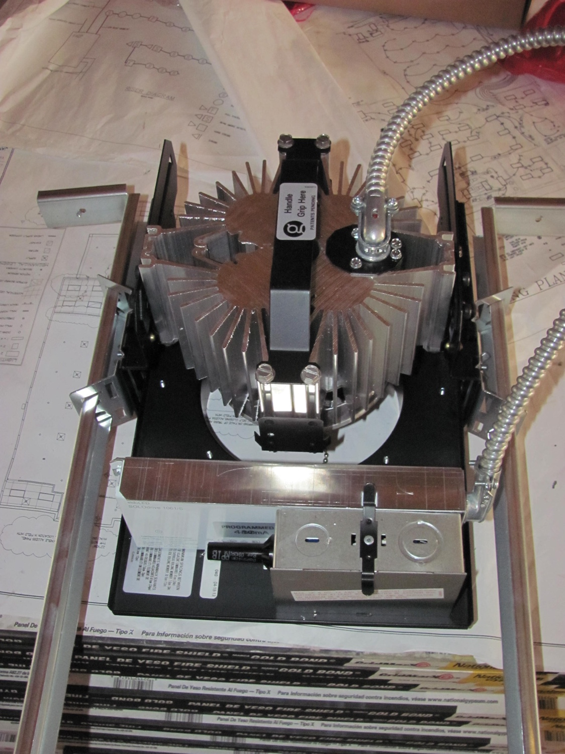

These are the LED lights we are starting to have issues with.
Huge heat sink on top. The LED segments attach to the bottom. Manufacturer does not sell a replacement LED element, nor is this model even made anymore.

One of the issues with servicing LED’s has been the rapid progress in design and manufacturing. The development of consumer LED has been somewhat stunning. Seemingly every year, there has been new and improved LED lights and fixtures. Sadly, the old “latest and greatest” was quickly obsoleted as design/manufacturing moved on.
Definitely sucks when your “obsolete” light dies and it has to be completely replaced
   / Good morning!!!! #146,888
We have some fixtures like that, too, BEF. This one has one LED mounted on a board in each unit, with a plastic lens over it, and a plastic bezel mounted around that to hold it in place. She told me it had started pulsing. I let it run for a couple of hours yesterday after removing all the plastic it's encased in, and it never had any problems. I'm thinking it's heat-related. It's the light over her piano, so she got annoyed when it started pulsing over her sheet music ... which I can completely understand.
I looked on the Lowe's website to find replacements, and found a plethora of bad reviews commenting on the same thing; units go out and replacements aren't readily available. The distributor did reply on a couple of them offering to get them parts, so I'm going to contact them to see what they can do. We like the light, but may have to eventually replace it with something more serviceable. For now, I'll see if I can get parts to keep it working.
Naturally, it's 5-year warranty has just expired. :rolleyes:
Tell her to play like Keith Emmerson from ELP with a strobe light effect. :)
