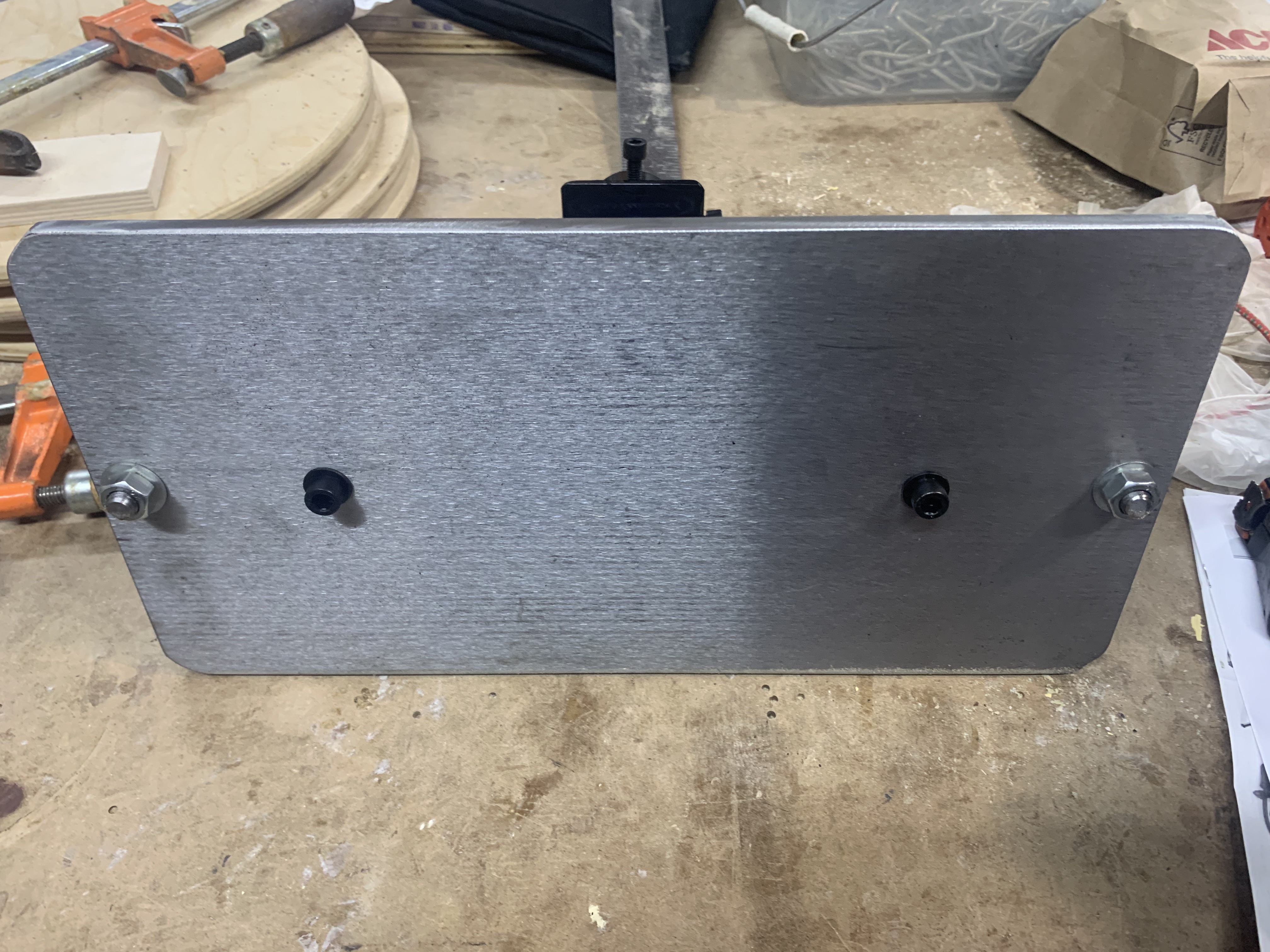

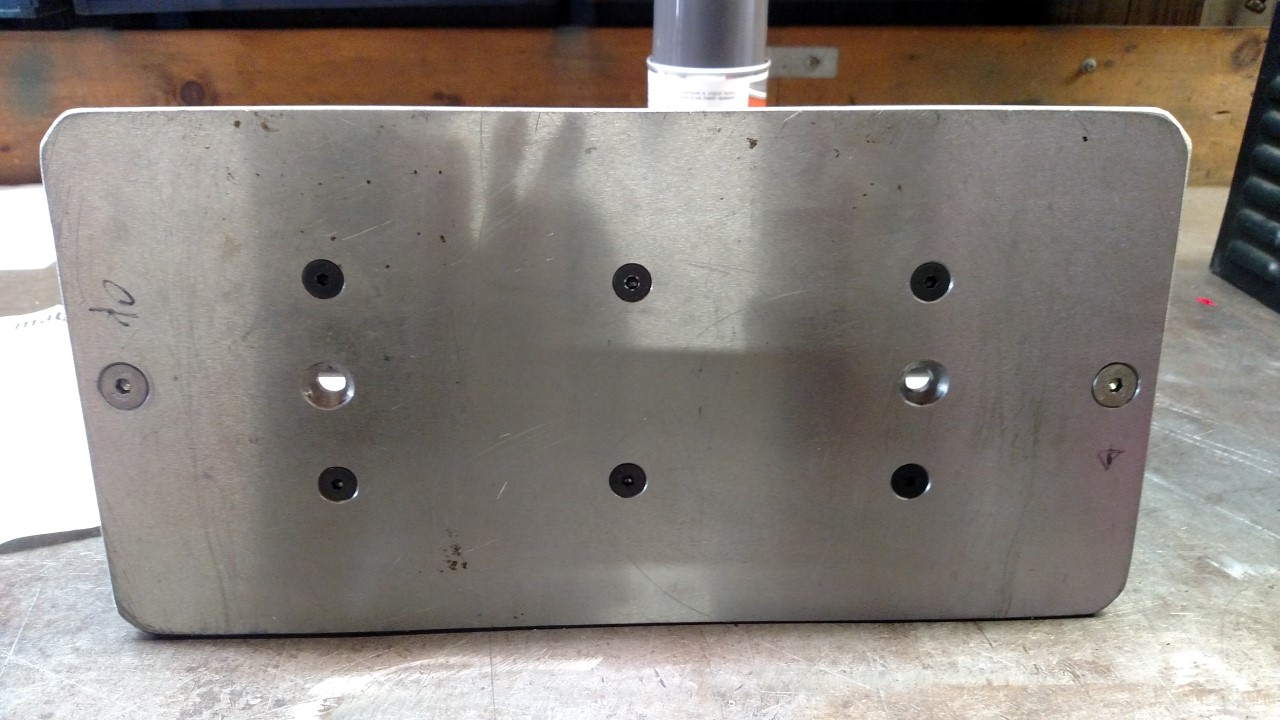

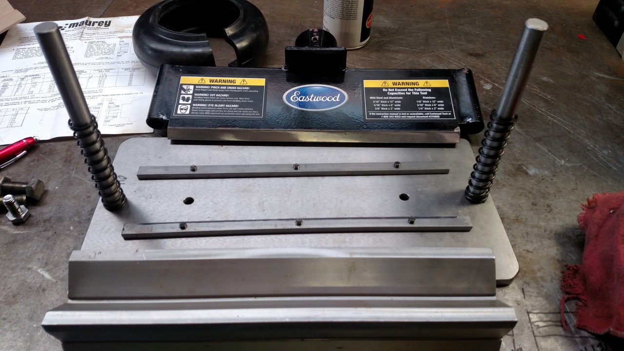

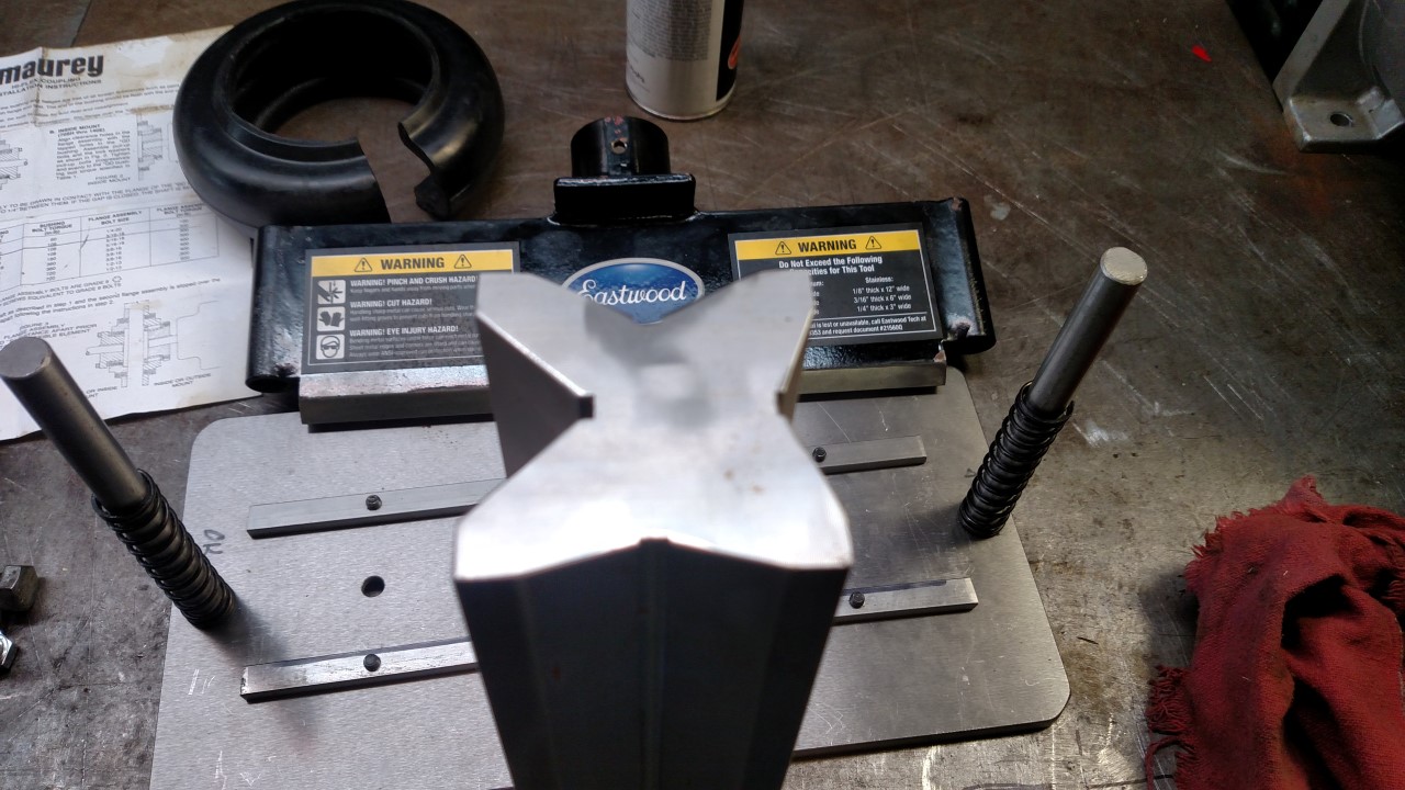

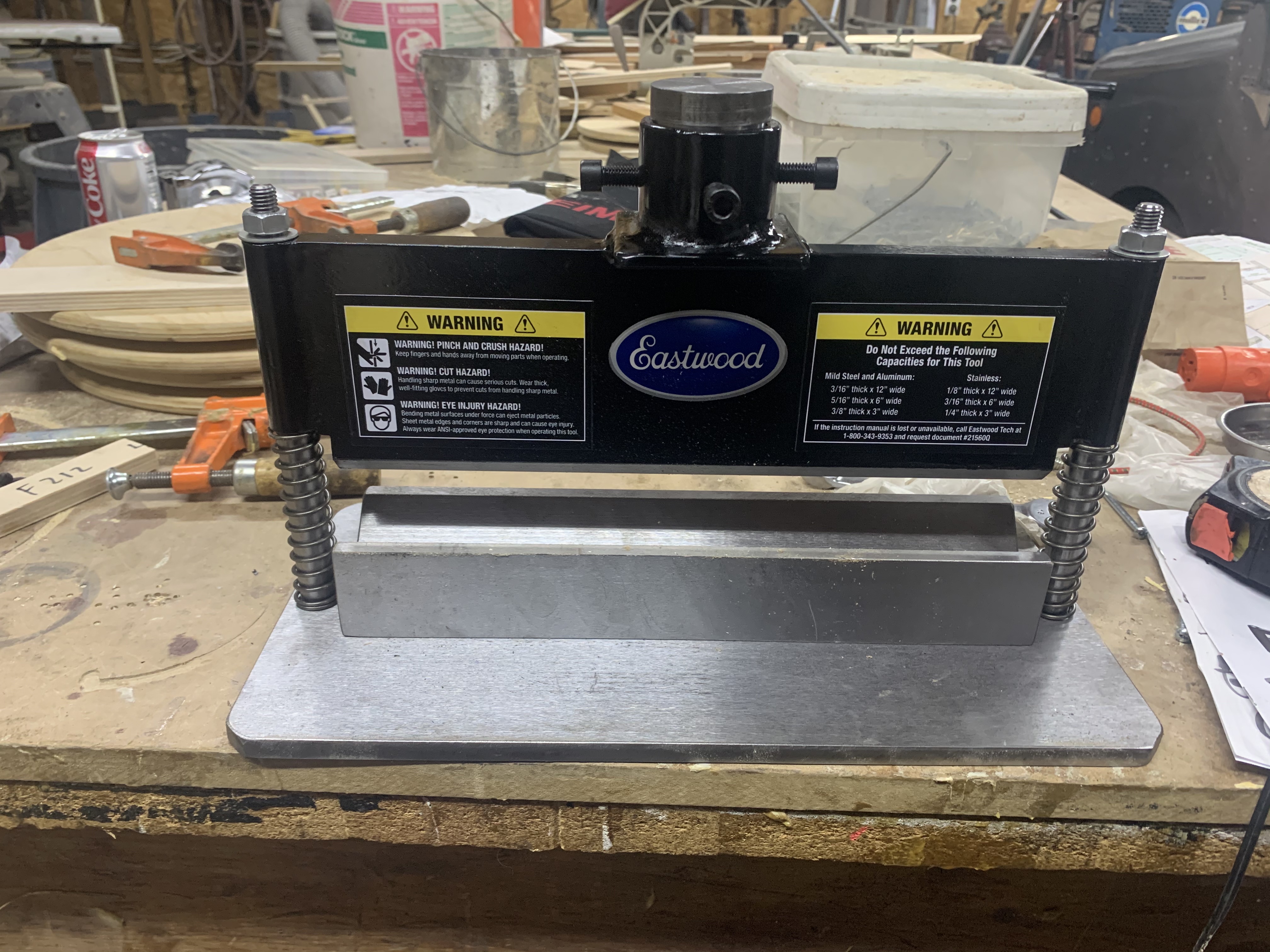

So here痴 the Eastwood press brake and my modification.
As it came from Eastwood, it wouldn稚 sit flat and had to go between the plates on the press.
So I drilled the rods and tapped them and countersunk the holes to use flat head bolts. Now it sits flat.
I have no idea what they were thinking when they made it.
Well this is proof that great minds think alike.
I have the same brake and thought the same thing, what were they thinking?
I did the same as you, I made new guide rods, drilled and tapped them, countersunk the holes in the base and used flat head bolts.
I went a little farther though, and had the local machine chop make me an die with 30?, 45?. 60? and 90? faces.
To make it easier to use, I put a bar on each side of the die to hold it in place, and I can just turn it to the side I want to use.
I also turned a piece of bar stock to fit in the press plate and the blade on the brake.
Works like a charm now, no more guessing on the angle when bending less than 90?.
