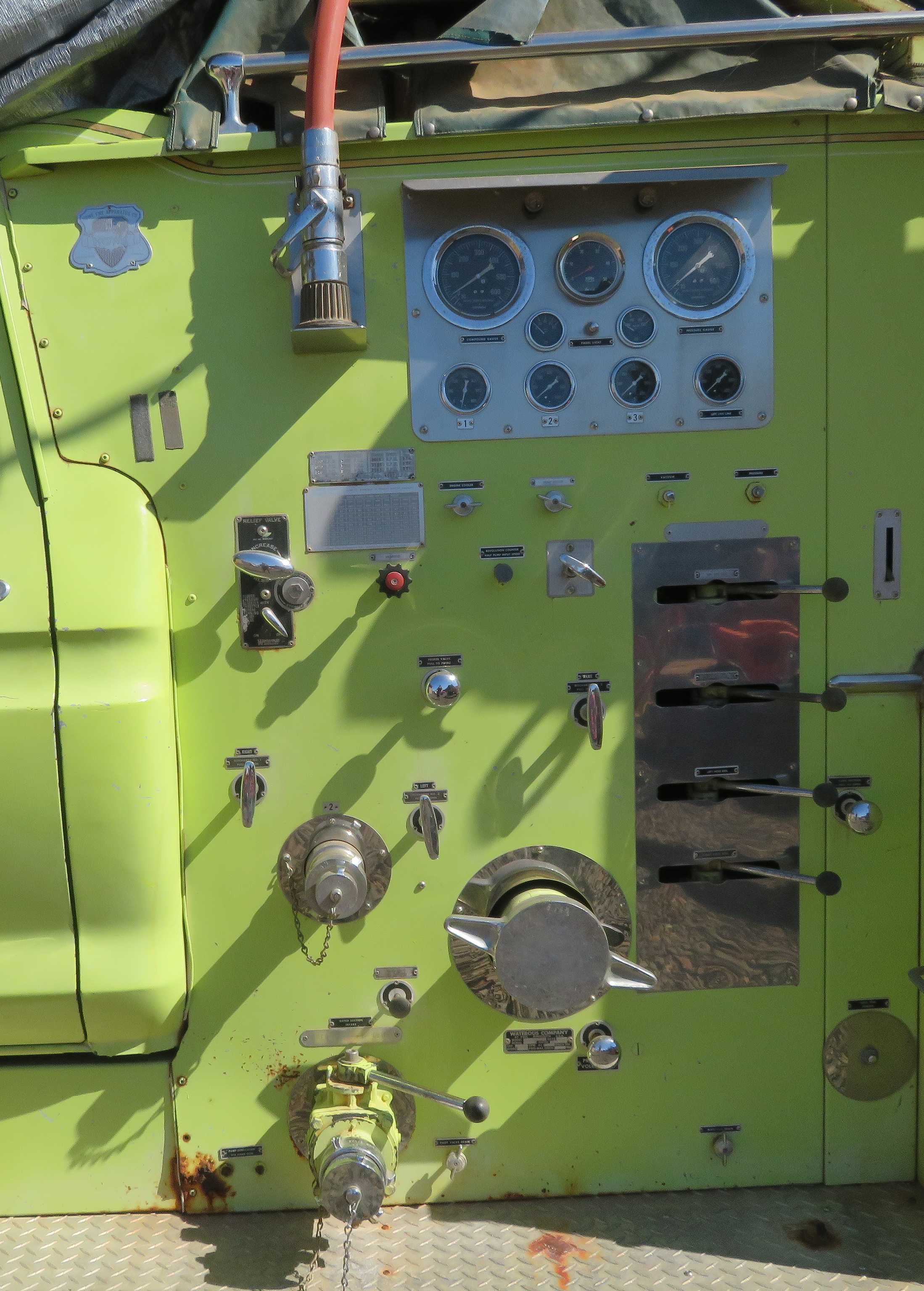

Relief valve could be stuck. Turn clock wise all the way. Should always be left in the highest mode so if it fails you can still build pressure. The bolt beside the relief is the strainer it might need to be cleaned. And if it relief is stuck on low side then wd 40 and work the valve.
hope this helps

There is a Pressure Relief Valve (top row of controls, left end), but it doesn't seem to have any effect, Rick. At most I've seen 45 PSI on the gauge. It's set up to draft water from the 2500 drinking water tank, and the fill valve to the onboard tank is closed. Water is making it out the end of the hose, so the lines are primed, there's just no pressure...

What's your intake gauge reading while at 45psi discharge? What gear are you pumping in?

There are two pressure gauges on the panel, and neither are marked as to what they measure. I've never seen anything but zero on the one on the left, the most I've seen on the one on the right is about 45 PSI.
It's a five speed transmission, and I run the engine at 2000 RPM with the tranny in 5th, which is marked as an overdrive gear. The Waterous instructions say to run the pump with the transmission in the highest gear. I can hear the PTO turning, but I haven't poked my head down there to see it turn, so maybe I'll do that today.
I'll take a look at the pressure relief valve, and review the operating instructions in the Waterous docs. I asked the PO about it, and he doesn't remember ever "messing" (his word) with the pressure relief valve.
I'm not using the on board water tank anymore, mainly because I'm worried that there is still debris in the lines that run between the tank and the pump. No real way to flush them that I can see.

Ok. So you're in the right gear. The gauge on the left should be your intake/vacuum gauge. The one on the right is your discharge/pressure gauge. 2000 rpm and still only showing 45psi? What is your intake gauge reading prior to opening a discharge to flow water? Is it at zero or above? Does it fall lower when you open a discharge?
the pressure relief valve is a wheel, first off, crank it all the way counter clockwise. This is the lowest setting. Then, crank it about 16 turns clockwise. This should put you above 100psi at least. Then should be a short teardrop lever under the wheel. Work it back and forth, then leave the tail pointing to the right. This should be closed. There should also be a round knurled knob under the wheel. Screw that out counter clock wise. It is the screen for the pressure relief valve. Make sure it's clean and re install.

Whoops, Drew beat me to the relief valve info. Sorry, didn't see it prior to posting.

yeah, but I didn't know what I was talking about...;)
It's been over 25 years since I ran a pumper and only did it for two years.
