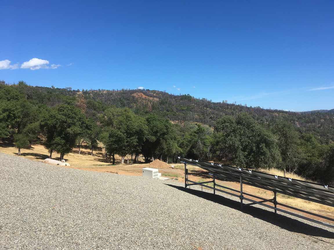

Here are a few photos of the finished system.
The solar panels, generator, and propane tank off the back side of the house.

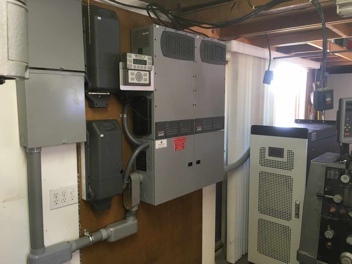

These are the "balance of system" components on the back inside wall of the garage. Left to right, a pair of subpanels that manage incoming power from the grid, generator, and solar panels. Then there's a pair of charge controllers that manage how power coming from the solar panels, generator, or the grid are used to charge the battery. Next is the Mate3 controller that provides a user interface and internet connection to the system. Below the Mate is a Hub, which works pretty much like an ethernet router to enable all the components to communicate with each other. Next to that is an inverter, which is set to be the Master, managing the Slave inverter below it. The inverters convert DC power from the battery bank into AC power for all the household loads. Below the inverters is another set of breakers for controlling power out of the inverters. This is where the bypass breakers live, used to feed grid power to the household loads should something go wrong with any of the components in the solar/generator side of things. Power can then go to or flow from the battery bank through the conduit on the right, or come out of the inverters through the conduit to the left, where it is routed first to the well pumps, then back to the old main panel for the rest of the house.

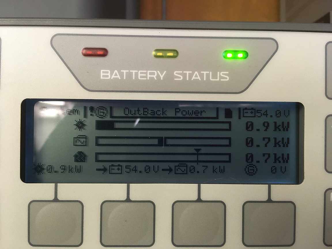

This is the display panel on the Mate3 controller.
I'm not 100% sure about what exactly it is showing, but I'll take a stab at it and maybe David can tell us how well I guessed?:laughing:
The battery bank voltage is displayed in the upper right corner. I was told it would be a 48V bank, but this one turns out to operate in the 54-55V range for some reason. Not sure what the page with folded corner icon means.
The next line down shows that the solar panels are providing 0.9kW of power to the battery. Everything is relative to the battery in that power from the grid, from the solar panels, or from the generator, all goes to charge the battery. Unless the system is put into bypass mode where grid power goes directly to the household loads, all power to the house comes from the battery as DC, then is converted by the inverters to AC before it is fed to the house. This ensures that there is no loss of power to the house loads if the grid goes down, even if the generator fails to start. At least as long as there is power remaining in the battery, or the charge level has fallen to the point where the house loads are automatically disconnected, the well pumps will be able to provide pressurized water for fighting wildfire. And that is the main purpose for building this whole system. In effect, the system acts as a giant Uninterruptible Power Supply to drive the well pumps. It's a UPS that can be recharged from the grid, the solar panels, or either of the two generators. Belt and suspenders, and suspenders for the belt.:laughing:
The left half of the next line down shows that 0.7kW of power is being consumed on site. If the power was being sold to the power company, the bar on the right side would indicate how much was going out.
The next line down shows that overall, 0.7kW of power is being consumed on site.
The bottom line is a sort of graphic that attempts to show the flow of power. The little sun symbol on the left says that the power is coming from the solar panels, the arrow tells us that the power is going to the battery bank that is currently operating at 54.0V, and the next arrow says that the battery bank is providing 0.7kW to the house. The G in the circle tells us that the generator is connected, but it currently isn't producing any power. Which is probably why there's an error message in the upright left hand corner of the display, which is mostly obscured by glare.

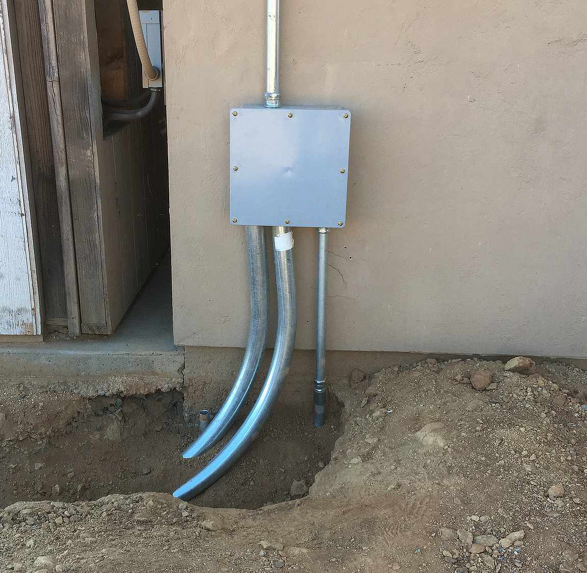

Last but not least, the straightened out conduit on the right. Somehow on the previous visit, the lead electrician got the idea that he wouldn't be given enough time address some fitup issues with the conduit I'd run through the various trenches, and tried to make do with the parts he already had on the truck. At the end of the day, he had to come back anyway to replace a defective charge controller, and the conduit issues here and in a couple of other places were all remedied.
