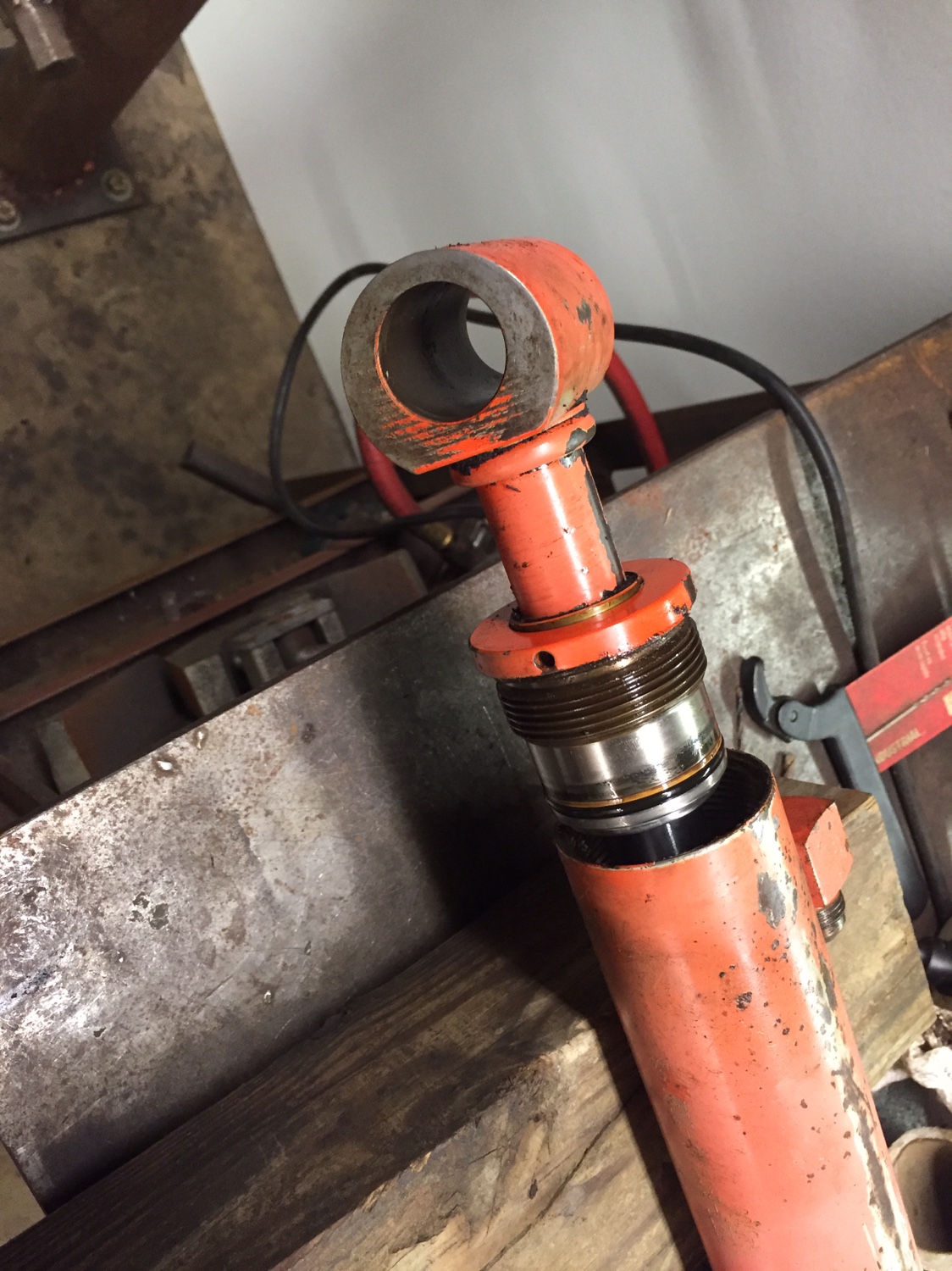

Just removed the gland nut:
Unfortunately there is a good amount of wear in the rod end hole for the pin ... probably should be machined and sleeved ...
   / Good morning!!!! #112,766
Rod does not appear bent:
Nor are there any obvious scratches or pitting.
Will need to check it with a straight edge though.

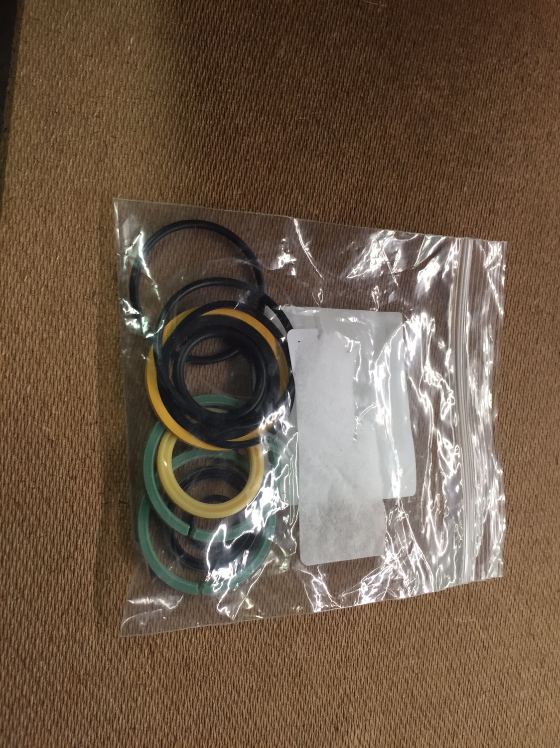

Seal kit contains a total of 11 seals/o-rings:
That’s for one cylinder.
