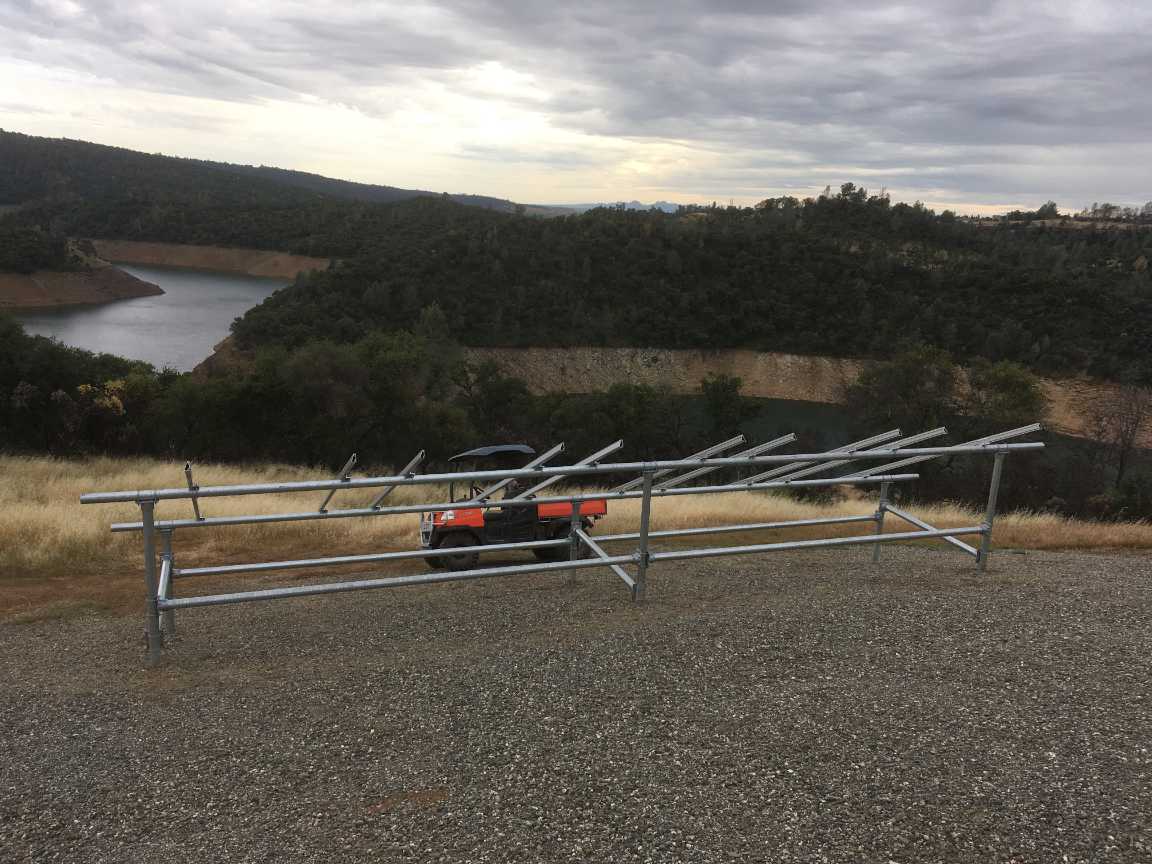

Solar contractor finally texted the spacing info I needed to get the rails on the solar rack. After wasting half an hour trying to work it out on a piece of cardboard, I gave up and went inside to use the CAD system to do it right. By the time I came back out, the wind was blowing so hard using the tape measure to mark the rails was like playing tug-o-war with thirty-five foot razor blade. Each ten foot rail is a beautiful extrusion, with slots for the heads of mounting bolts that hold it to a short piece of aluminum angle. The angle is held to the top rails by the same U-bolt that the pipe fittings used, but the torque setting dropped from 15 lb. ft. to only 60 inch pounds. The ol' Snap-On Torque-O-Meter sure got a workout yesterday!.
Finished up just as the first fat raindrops started to fall. The new view from the patio cover does show a little of the rack, but I'm glad I didn't lower it any more than I did. The lower edge of the panels will still end up about four feet off the ground, and the high end will be up far enough to walk under, but easy enough to reach when standing in the bed of the side-by-side. Which is probably how I'll mount the panels. The solar contractor said he wants to come out for a walk through tomorrow, but I think I'll try and put him off until Tuesday so we don't have to walk around in the rain and mud.
